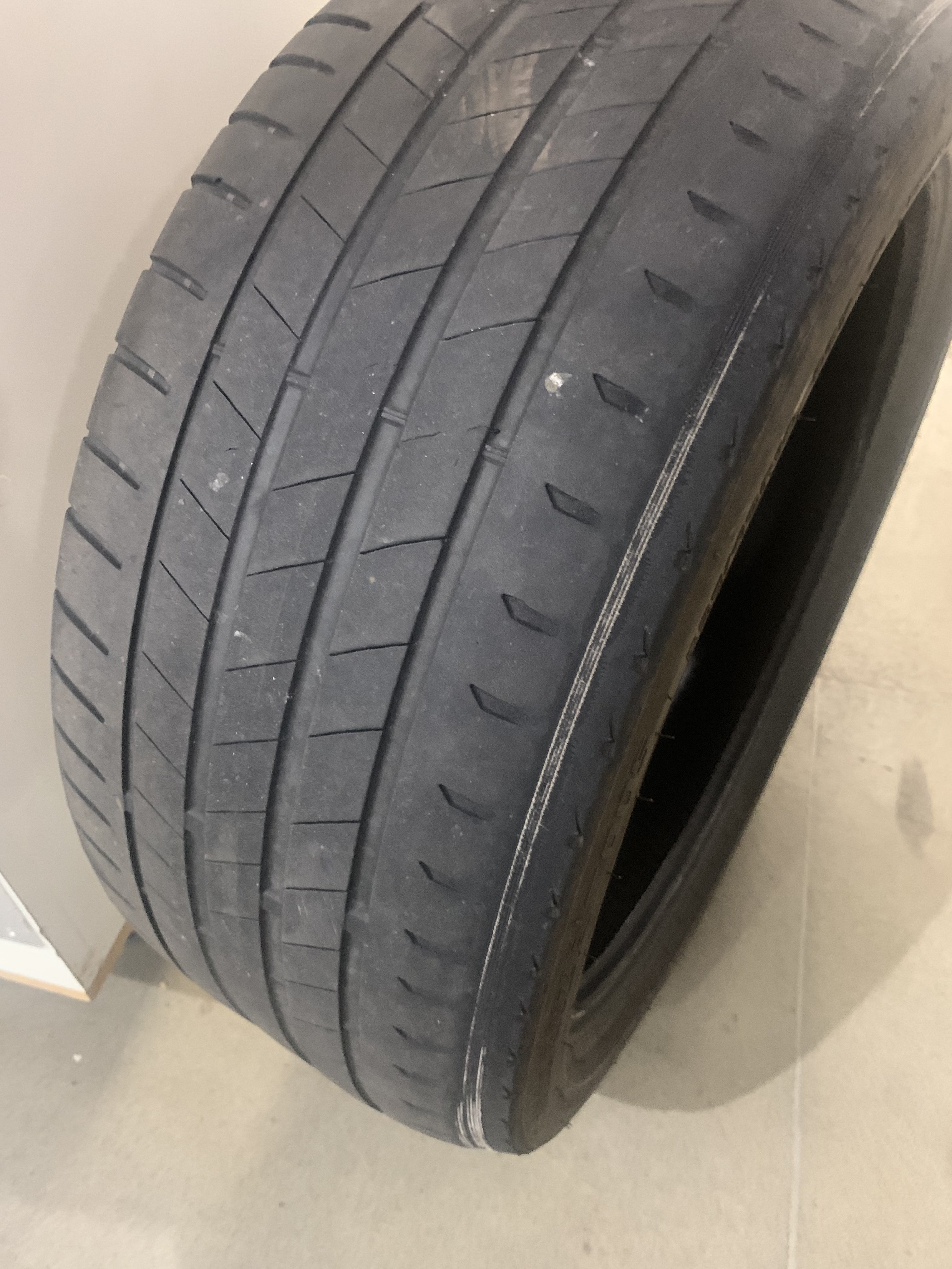

This has happened twice now.
first time I was shocked and took the car to a place for new tyres and to check tracking etc.
Tyres gone again. Front inside edges. Both sides.
Before an apprentice at KwikFit tries to blag it - anyone KNOW what causes this?
I’ve just had 4 new tyres fitted and I’d rather this doesn’t happen again.
Cheers
You had the tracking checked and it was all fine?  Sorry not a mechanic, but looks like camber off by miles, some bad tracking or broken suspension?
I'm probably as shocked as you seeing that.
Who is doing the alignment?
What kind of alignment are they doing?
What equipment are they using?
Did you get a print out?
Its either a failed suspension component or bad geometry
A 4 wheel laser alignment would pinpoint the issue, could be too much negative camber or the tracking.

Are those not asymmetric tyres? (will be marked "this side out" on one sidewall and "this side in" on the other.) If so, I'd judge wear by tread depth, not looking at width of grooves, and a proper depth gauge is about £5.
Not camber, the tread wear is even across the central 3/4, in fact in terms of wear the tyre is still well within the legal limits 🤣

I’m more concerned by the wear on the edge.
I am guessing some cannot see the exposed cord.

I would say it’s most probably a geometry issue (toes out rather than too much negative camber, since they’re quite evenly worn on 3/4 of the width.
Anyway since you have brand new tyres, it’s the right time to get both front and rear axles correctly set. It should prevent this to appear again.

75k miles - I've had it from new. Vast majority motorway mileage. My ignorance at fault. I took car in when close to the indicators last time and was shown a similar picutre (but a lot worse) and I was horrified. I bought new ones and they also did the tracking & alignment etc at the time. I watched them do it - albeit I've no clue what they were doing - I work in IT...  This time I noticed the tyres were getting low again, back ones too (still pass MOT but winter coming so went for 4). Different garage. Same story - "It's a good job you brought the car in". This was Costco - who don't do alignment (I had a £200 voucher)  so I will now take car with new tyres to somewhere else again - not first garage - to get this checked. Again. Just thought I'd ask here. It's alarmingly uneven wear on the very edge. Almost like they've been rubbing. But I got 20k out of them. Bridgestone Turanza. I'm one of those guys who I guess doesn't check the inside edges often enough!!
that's what I thoguht last time!  I will do of course - but someone else...
I'm getting different opinions on here and amongst friends. Camber, tracking, toe in, toe out, broken suspension bits. I dunno. I need someone I can trust to actually diagnose / sort it. It's not the cost - it's the safety. My family drive with me in this car. And my mountain bike!!!  I'm near Wigan/Warrington area if anyone has any first hand recommendations it'd be appreciated.
The logic of asking mileage is suspension parts do wear out, and sometimes can be hard to get in spec, and keep in spec.
Potholes can do a fair bit of damage to suspension of course, and bend a part by a little to put the car out of spec again, old worn bolts perhaps cannot hold the suspension in spec, and sometimes need replacements.  Basically many factors can be mentioned on here, at least now you are aware of the issue, you will keep a closer eye on things in the future, easily checked by applying full lock each direction and taking a look at both sides of the tyres now, rears you can get down low and check as needed.
Now you have new rubber, you should locate a decent tyre centre you can get a 4 wheel alignment done at, complete with printout.  Then experts on here can go over the values and advise much better.
Hopefully someone might suggest a good local place if possible, best of luck to getting this sorted.
