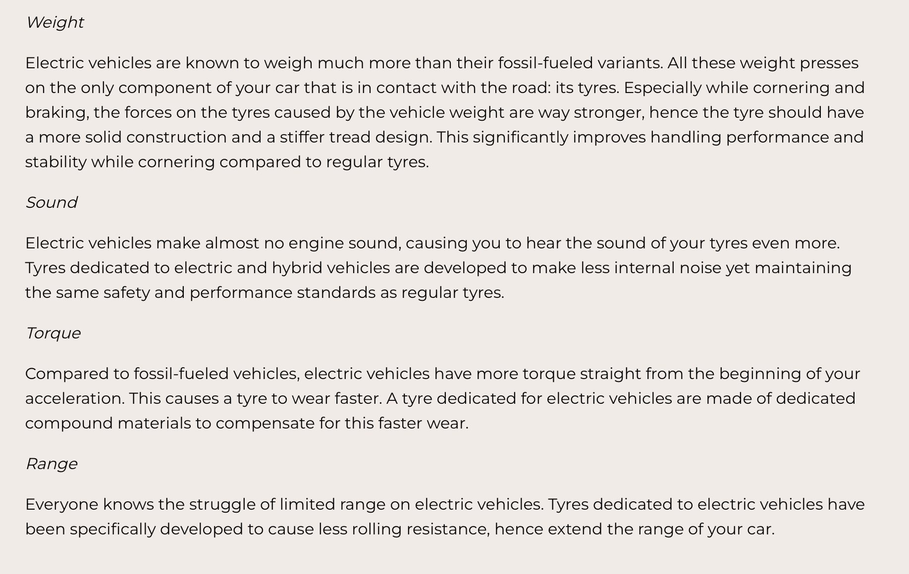

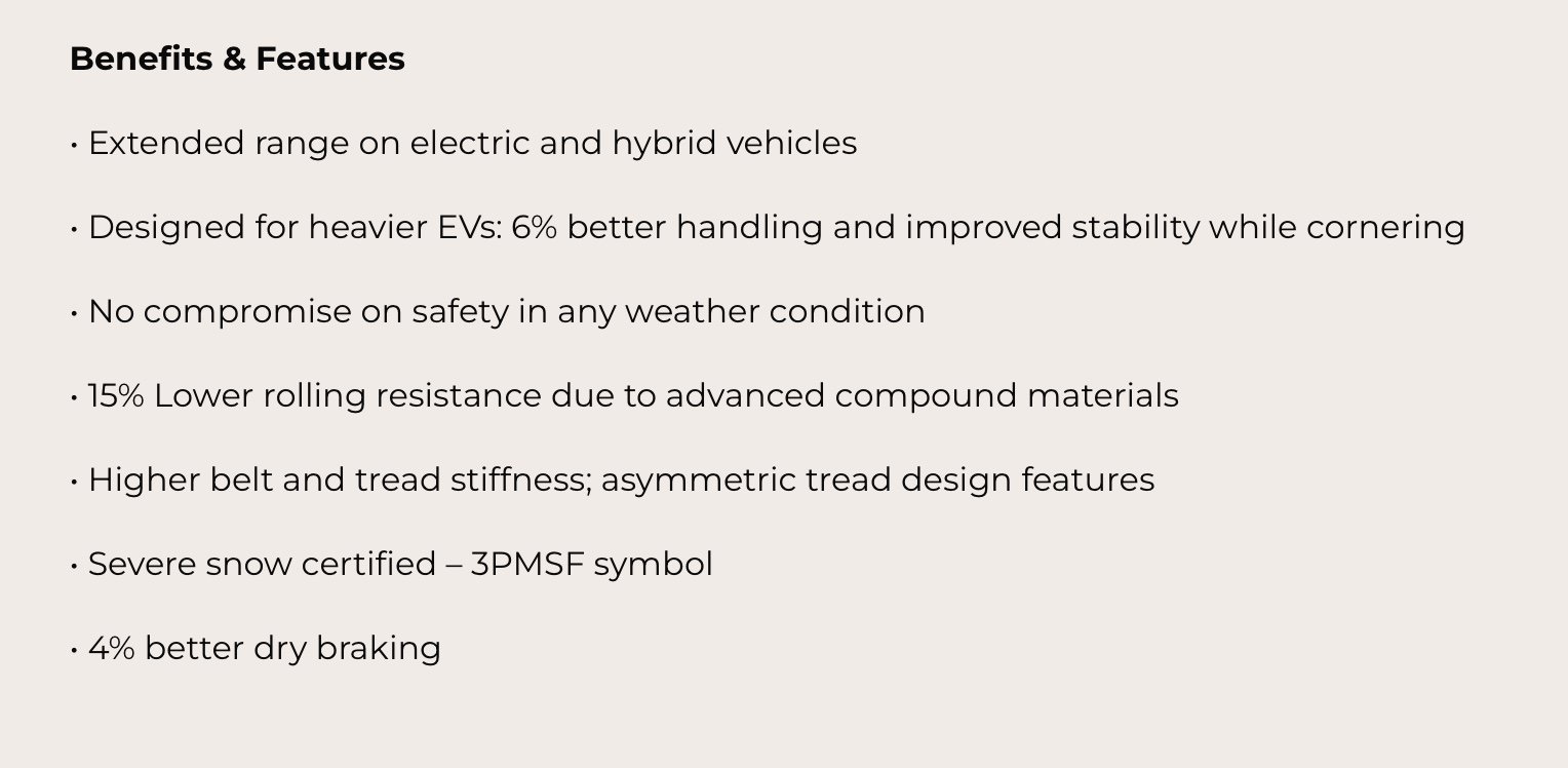

I’m still coming up the EV Learning Curve and I’m not picking on Vredestein.
Just using their web page info.
1. EVs are big heavy buggers - harder on tyres than lighter vehicles.
2. Hi torque off the line may be fun smoking the other guy at the lights, but  is gonna burn more rubber than a less torquey car.
3. Less rolling resistance suggests less grip than a tyre with more rolling resistance.
20” heavy duty tyres ain’t gonna be cheap.
AWD with Staggered Tyres in many cases or even RWD only.
Then lighter but still heavy EV's compared to to a smaller ICE with FWD and narrow tyres like a ZOE can go through tyres quick.
