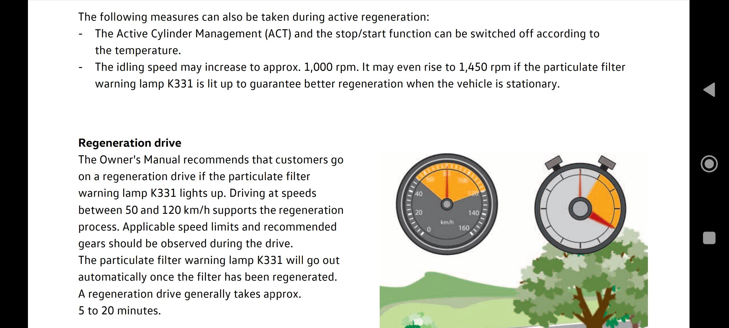

Yours is not blocked, you are getting the high idle as the car does what is required to ensure it does not block.

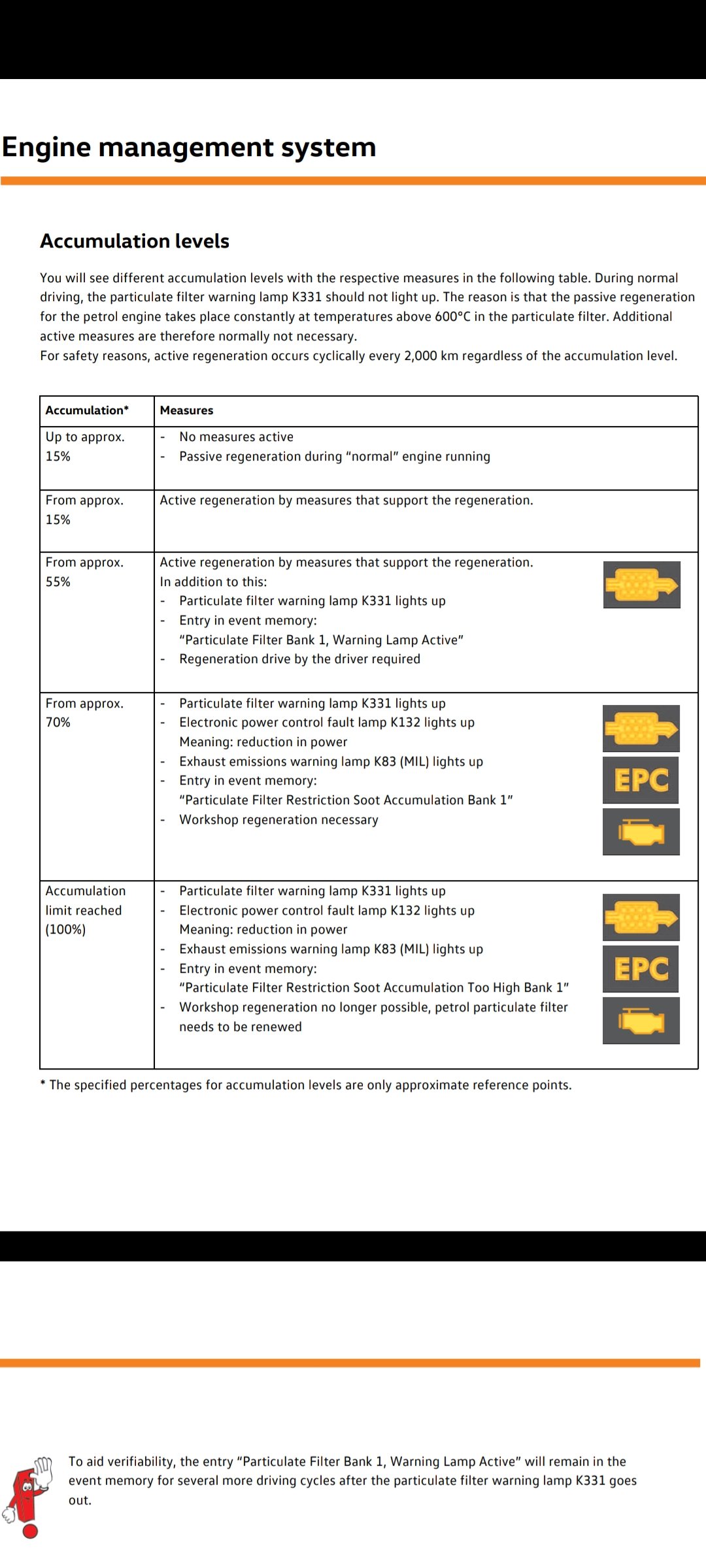

These SSP documents should be useful to read (for anyone wondering how GPF works)
SSP558 Close-coupled Petrol Particulate Filter - Design and Function.pdf
SSP590 Underbody Petrol Particulate Filter.pdf
Very similar to DPF, they have passive/active and workshop regeneration cycle's.
Screenshot_2022-11-01-10-17-23-504_com.google.android_apps.pdfviewer.thumb.jpg.82e64a7b4f8ddb301c8c947541dea547.jpg

Seems we might need another page added from SSP
2nd paragraph, also stop start might still function, OP said 1,000 and around 1,400rpms observed
Screenshot_2022-11-01-10-44-08-535_com.google.android_apps.pdfviewer.thumb.jpg.09199e9ec6041d2734c7b0e055caa8e9.jpg

If you look at the data I posted, your soot will be between 15% and 55%, so the car will do active regeneration and not put on a light yet.
Once your light comes on, then you need to follow what the manual say's.
Odds are you perhaps have done slightly shorter journeys, or driving the car a little too economical (which is understandable!) but now the car itself is taking over the regeneration by doing an active cycle.

Unless your soot level goes above roughly 55% you won't see the lamp/warning on MFD.
