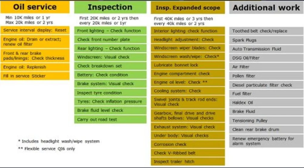

Last years idea from Skoda UK.
** This is the FIXED Servicing, and each year and 3rd year extended scope as well. then extended each 2 years after.

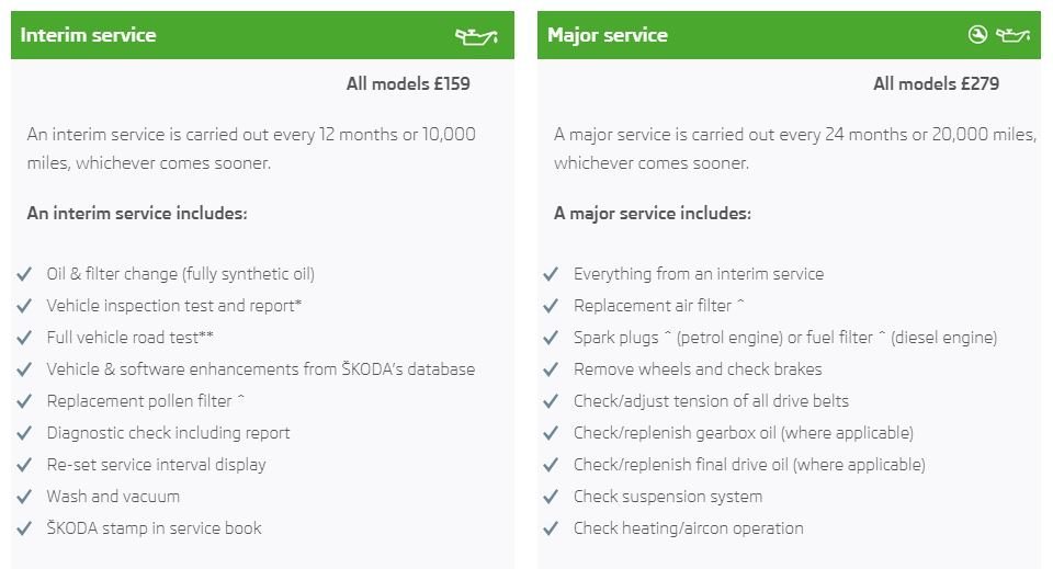

Or just go to a proper garage with proper technicians / mechanics and get the car serviced correctly according to use.
Do not pay £35 for Pollen Filters, £45 for air filters and ridiculous prices for look see and report and do very little.  IMHO.

How it was when Minor / Major Servicing.  But then they were charging for parts even if not replaced.
