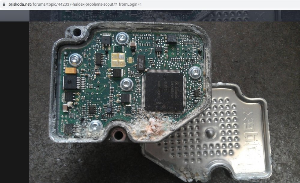

A member's picture from the thread above in Briskoda.
/cdn-cgi/mirage/70aec55e5b3f8b82b8e80ae780dca86e07a90586d44aa31d67e5b43e89535cf5/1280/https://www.briskoda.net/forums/uploads/monthly_2023_01/366234137_Screenshot2023-01-1407_56_37.thumb.jpg.28c75df120a50768e0842b3ff89e209c.jpg
