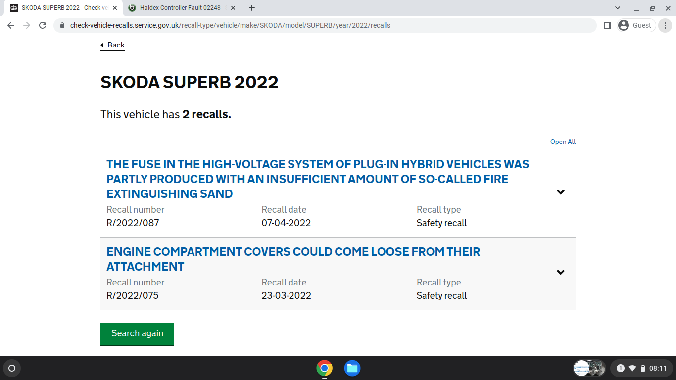

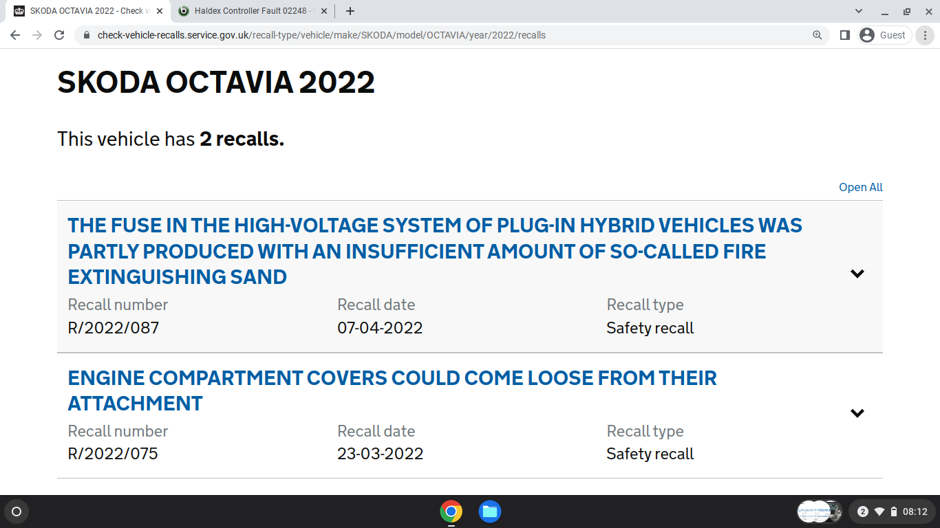

Really helpful thank you. Interestingly when I when to the gov website and entered by reg or selected skoda superb 2020 I couldn't find any

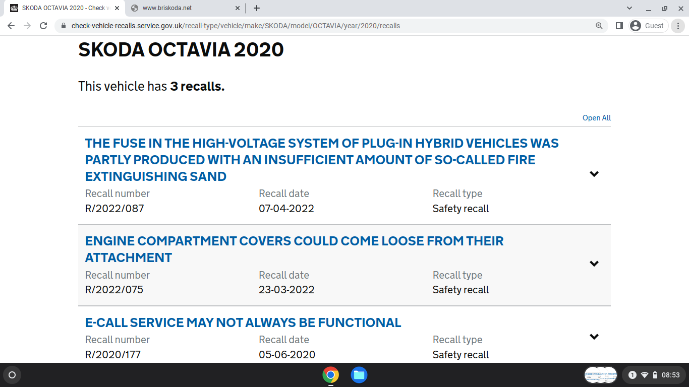

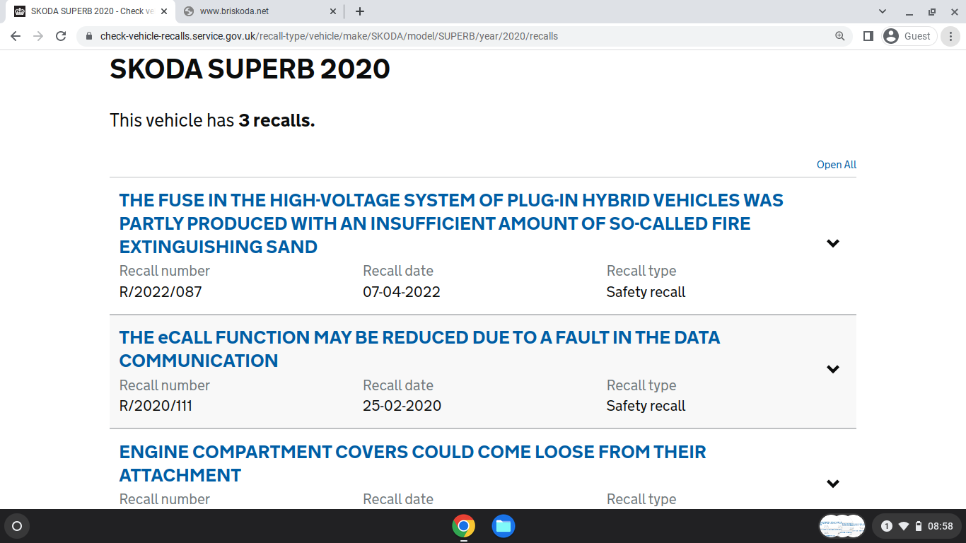

The recall relates to the safety HV fuse - if it was to blow there is a chance it could short/arc to the bodywork. A very small chance!
The solution - A insulating mat is placed in the area to prevent any shorting if the fuse did pop.
Unless there is a new recall for a different issue that is!
