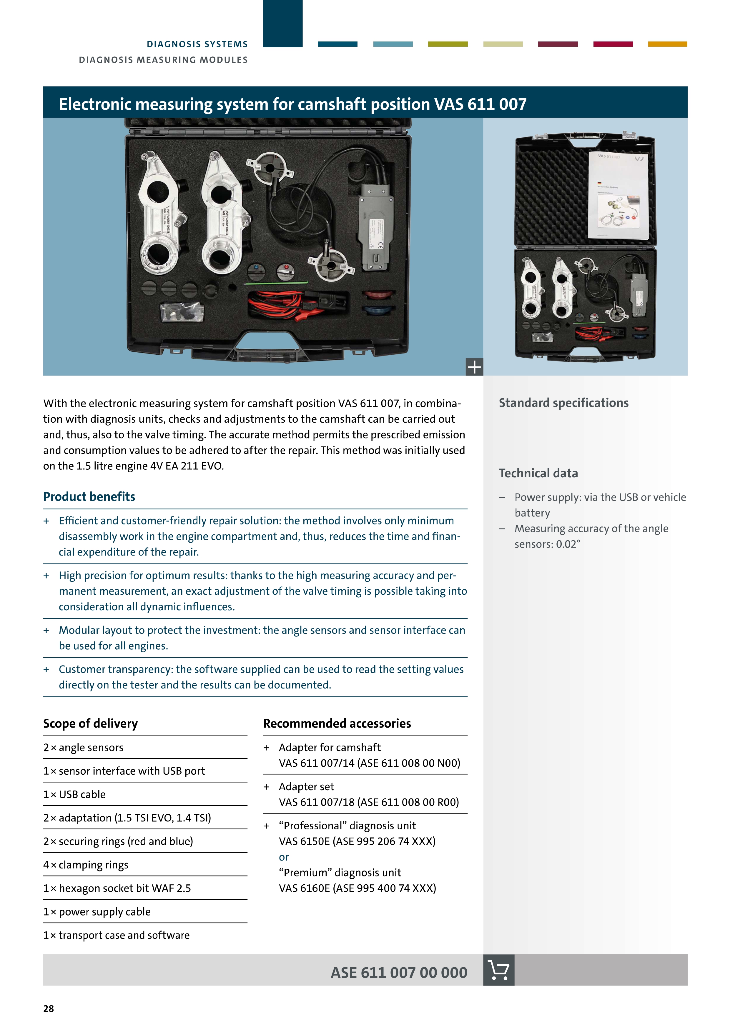

We have the locking tools but have discovered these are not accurate enough and the new VW tool, which is accurate to 0.05 degree, is nearly £3k plus VAT so we are thinking about it. So far the ones we have done have been fine but until we get the tool we have suspended doing the ACT versions. Anyway, the VAG SSP on the engine and the online service system say there is no interval.
0.02 degree, was looking at same catalog just the other day.
With you on your call to suspend the belts on ACT versions.

Interesting that the tool description states 'reduces the time and finincial expenditure of the repair'
<sarcasm>So why are the dealers claiming there's more work ? </sarcasm>
@Crasherthanks for the reply, hopefully you'll have the tool by the time mine needs replacing😀
Staff training, cost of equipment & risk of an expensive mistake maybe ?  Or it might be that the statement means the equipment takes away the need for a lengthy iterative process.

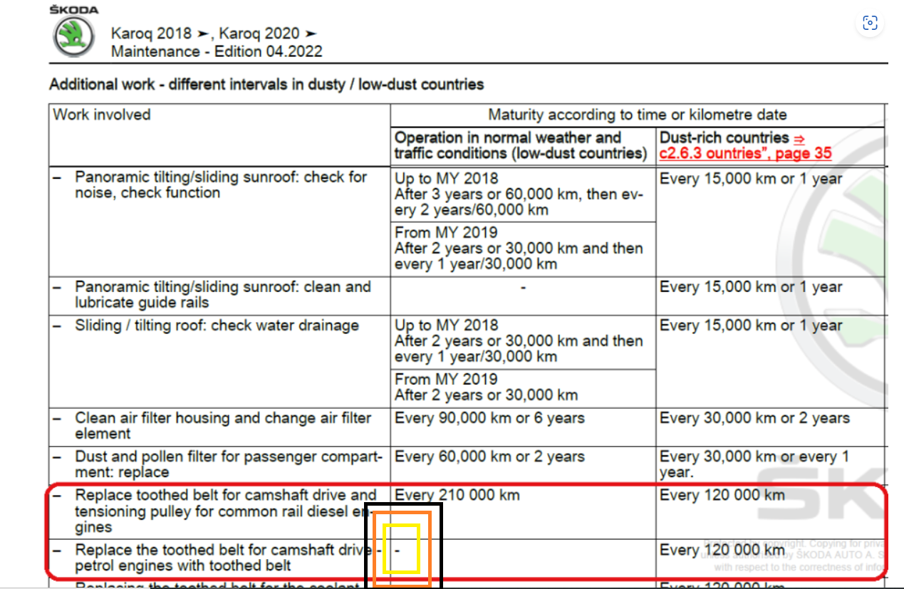

You clearly failed to use the link I provided to actually look at the post @DBSurrey meant. The one where there's a table of intervals in Skoda's own info, with a - (dash) against the interval for petrol 1.5s in non-dusty countries, meaning no interval specified.
  • Sponsor
Here, thoroughly emphasised for you:
