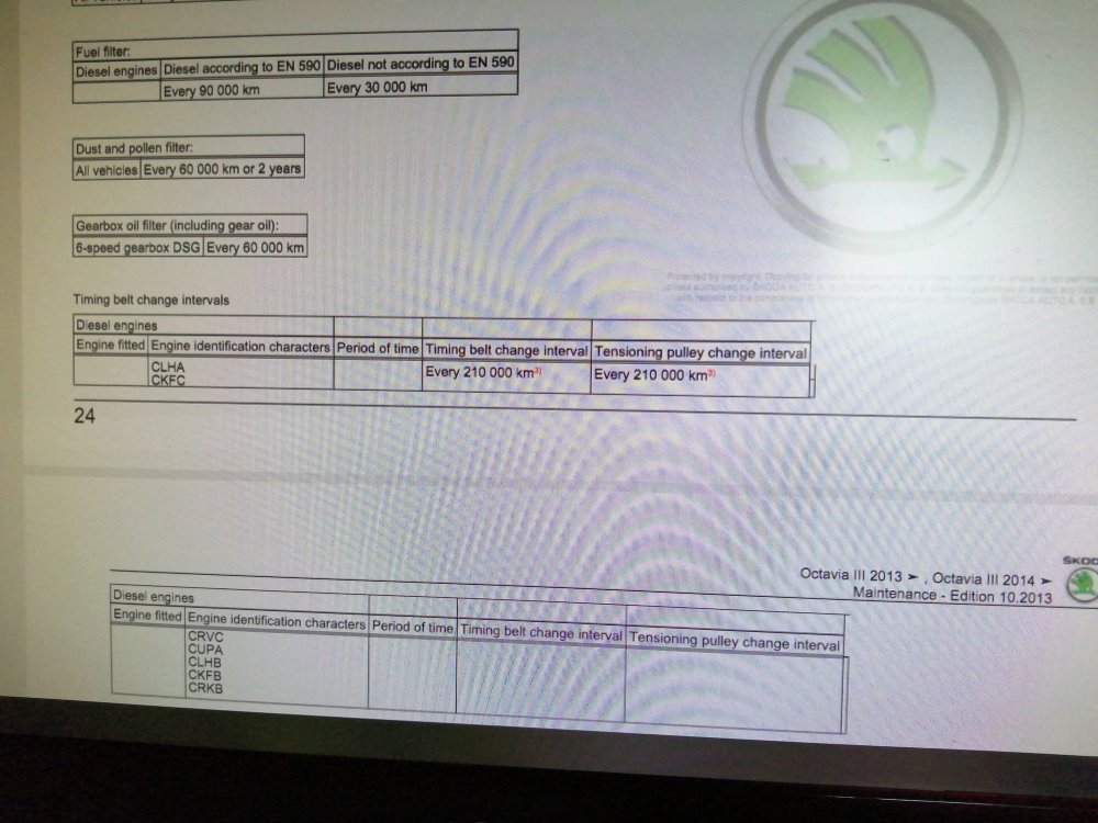

  • Above page from official skoda manual that can be found on here in 'pinned'section. Notice in 'period of time' section there is nothing mentioned. In the UK we must have special belts made out of self
