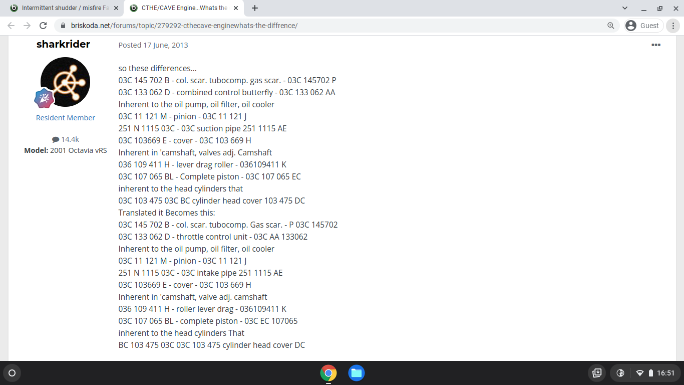

Skoda / VW changed the spark plugs before the CTHE was used and the CAVE discontinued and the gap was reduced.
Audi techs had already stopped using either of these plugs on A1 195 ps 1.4 TSFI's.
03C905601B / NGK SIZFR6B8FG were a 0.7mm gap.
sadly, these were fitted to many a Twincharger with issues.  Caused the issues along with the other well documented faults.

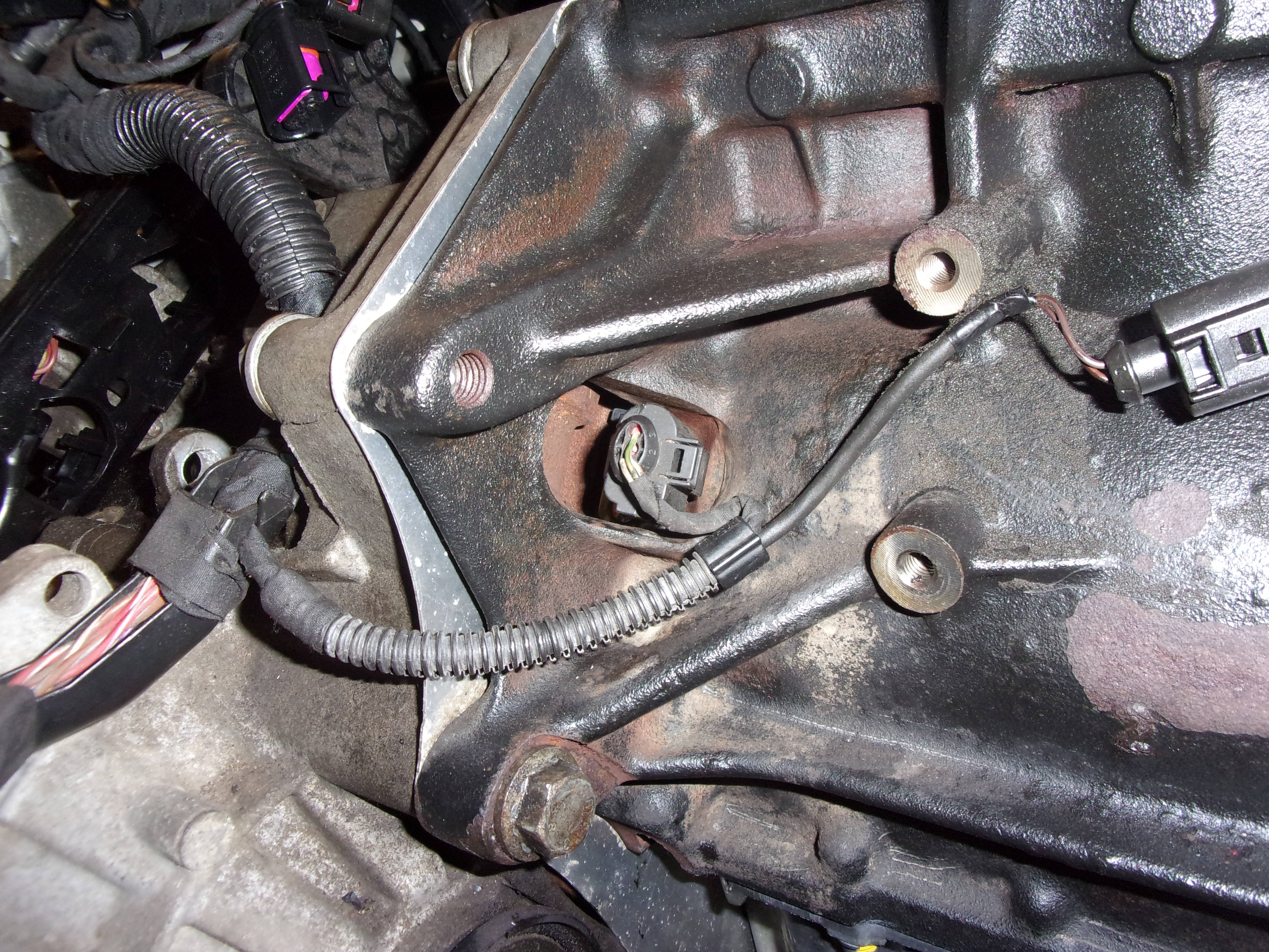

That is a very strong indication of a failing crank speed sensor G28, these have a nasty habit of not showing up as a code so I depend on that as a clue.
16490 (P0106) - Manifold / Barometric Pressure Sensor (G71) / (F96): Implausible Signal
I would, for now, judge that more as a result than a reason. Certainly based on what you say I would do the G28 first but on the CAVE it is evil to get at as the compressor has to come off which as you probaly know is a LOT of work.

It is unusual for the VAG data on ETKA to conflict with the NGK list and Tecdoc. I was going to get a genuine 03C 905 601 B up from TPS but they don't stock them

That wouldn't cause the rev counter to dip violently.
Edited by Crasher
I have not in the history of this forum ever seen anyone with the problems listed above sort it out by replacing the crank speed sensor as it just stops the car from starting if it does go faulty  I will however eat humble pie if it is that at fault but I have had the exact same problems the op has stated in the past and both times it’s been either a vacuum leak or a faulty map sensor as these engines do not run a MAF sensor so rely on the map sensors for most things 9B9B1C61-E520-431C-BFBA-C736F551453F.jpeg.a5697d315a5f38fe73016a25ed5cc479.jpeg
