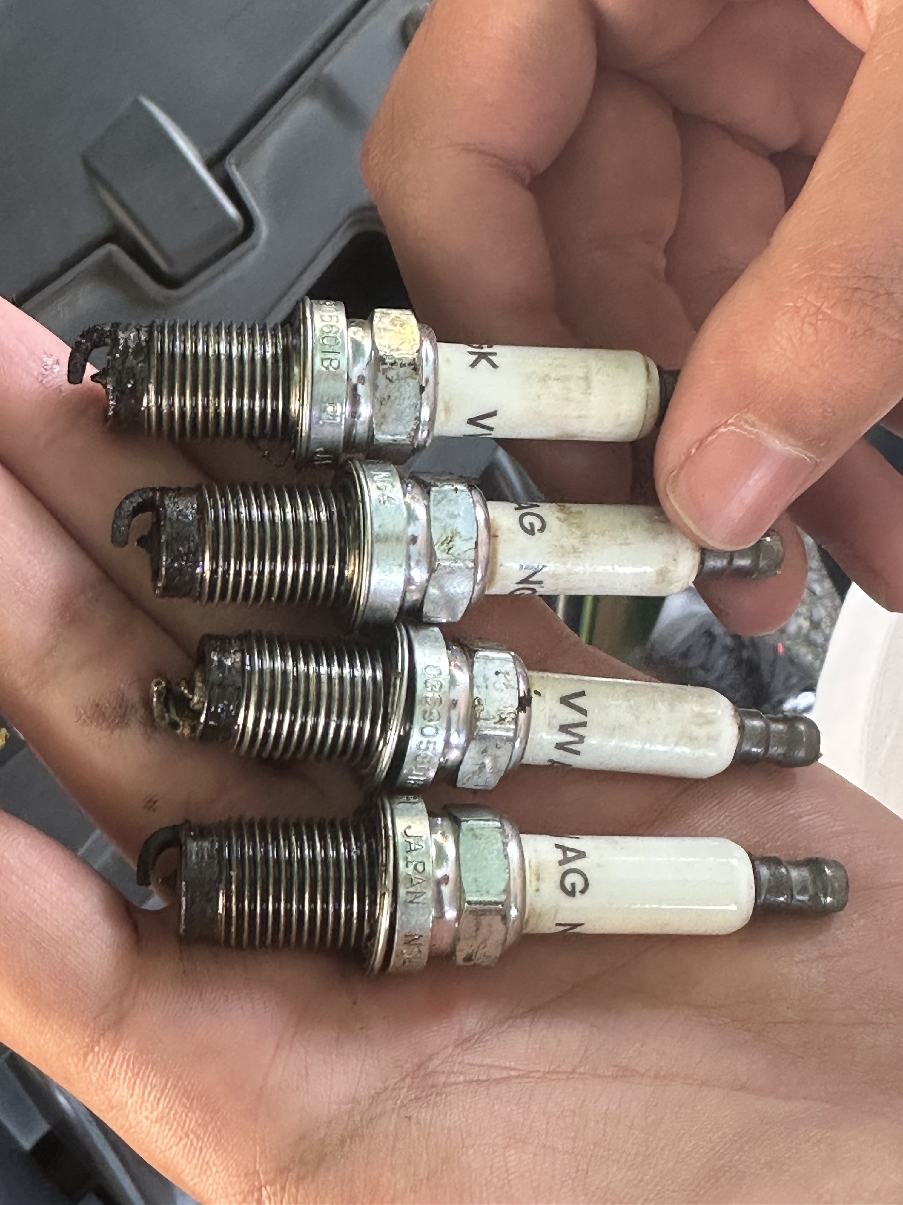

still in the job atm taking a break, engine’s definitely been worked on before found some new nuts on exhaust manifold and some destroyed spline bolts on the intake 🤦🏻‍♂️
I’ll pull the plugs and send a picture in a sec when i get back to it
From top to bottom 4321
