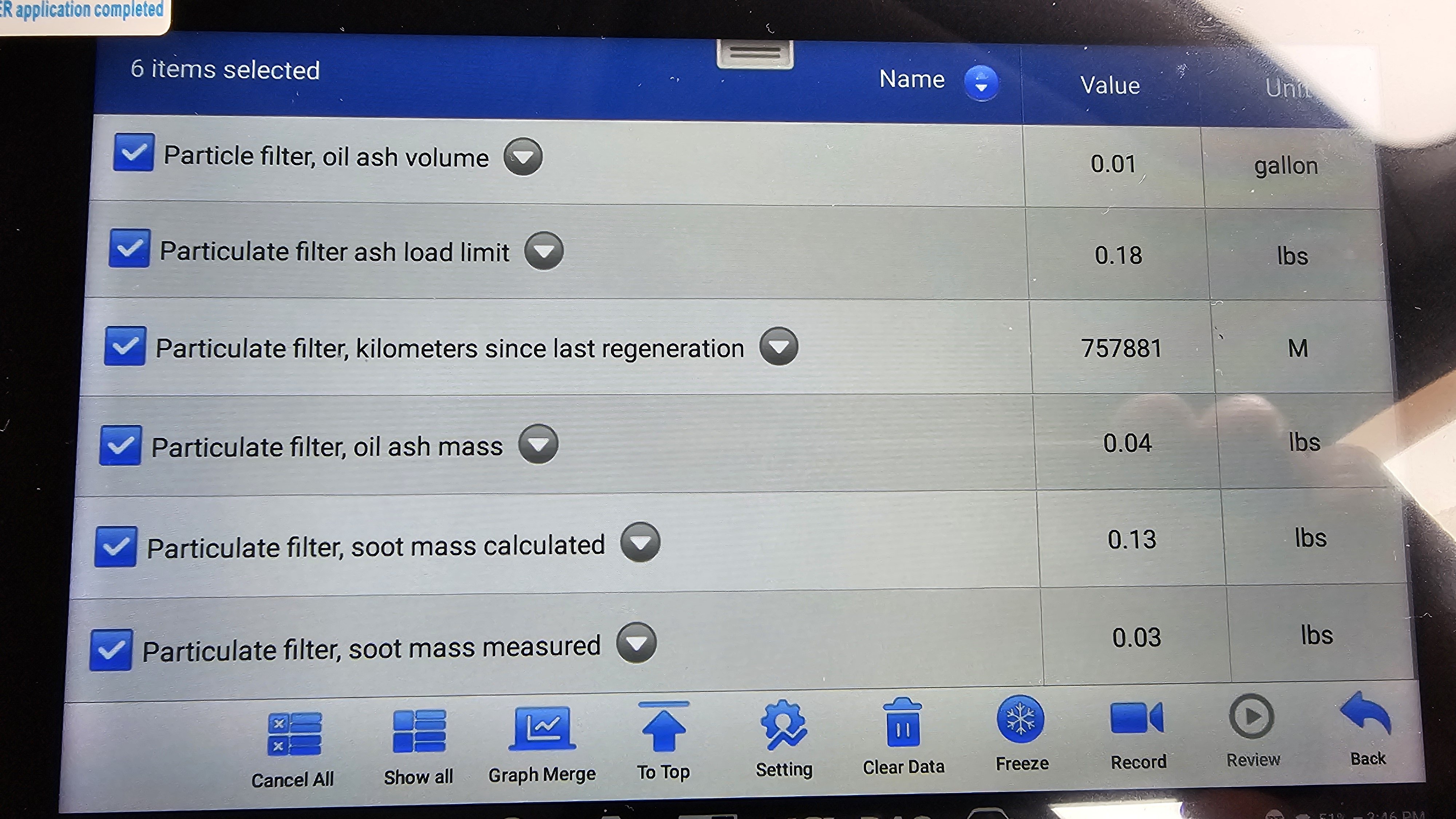

I used a basic scanner and this is what came up.
P2463 and P2458
Also Particulate Filter Putty Mass actual was 0.15 l/g.

I'm going to take it back to the original garage and get them to clean it out.
Here's the readings from the car from the scanner.  Would you say this is blocked?
