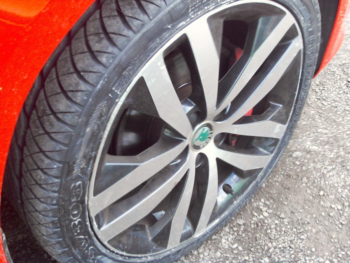

Please excuse my ignorace on the subject but I would love some help advice if at all possible. I recently encountered som pothole issues on my 2012 Skoda Fabia VRS estate and am now at the point where i either need to repair/replace the alloys. The wheels I bought the car with is in the image below but I can't for the life of me find the same wheels anywhere online (ebay, breakers yard etc).

MkII vRS Fabia's were all fitted with 17" rims from the factory none of which are what's on your car. There were four styles; all Gigaro's with different colour options.

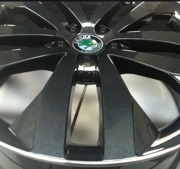

Mk2 Fabia vRS were fitted with 17" Gigaro in Black, Dark Chrome, White or Silver. Hatch Back & Estates, 2010-2014/15.
The Dark Chrome are terrible for getting White Worm / corrosion and often were powder coated or painted. Often black.
When i did ones i left the Diamond cut edge if in good condition.
Monte Carlo,s got Trinity that looked a bit like them but no diamond cut rim and grey not metallic black / grey.
Some Monte Carlo did get Gigaro as there were wheels stolen and also a Trinity shortage.

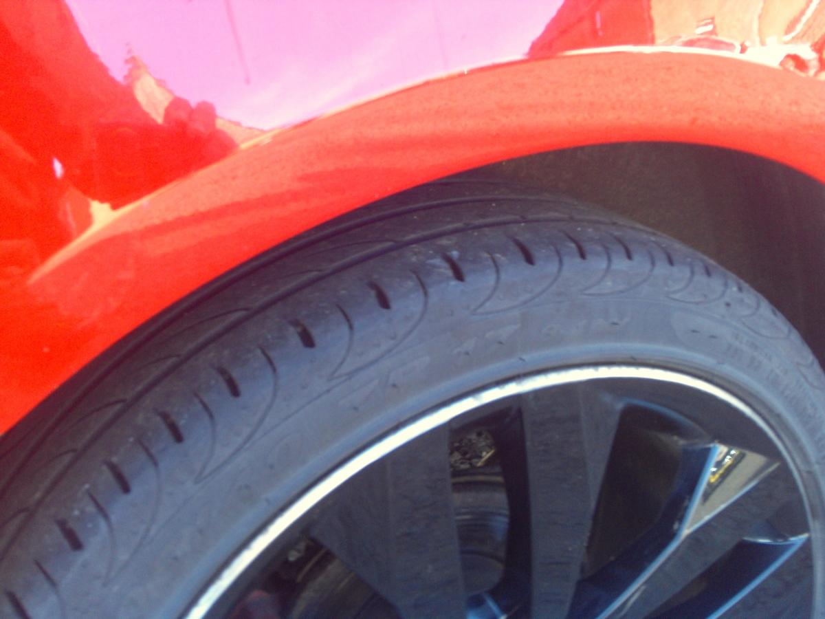

Standard Tyres, 205/40 R 17 XL.
Some fitted 215/40 R 17 as the top picture.
Or 205/45 R 17 as the bottom.  Good for winter with the right tyre type.

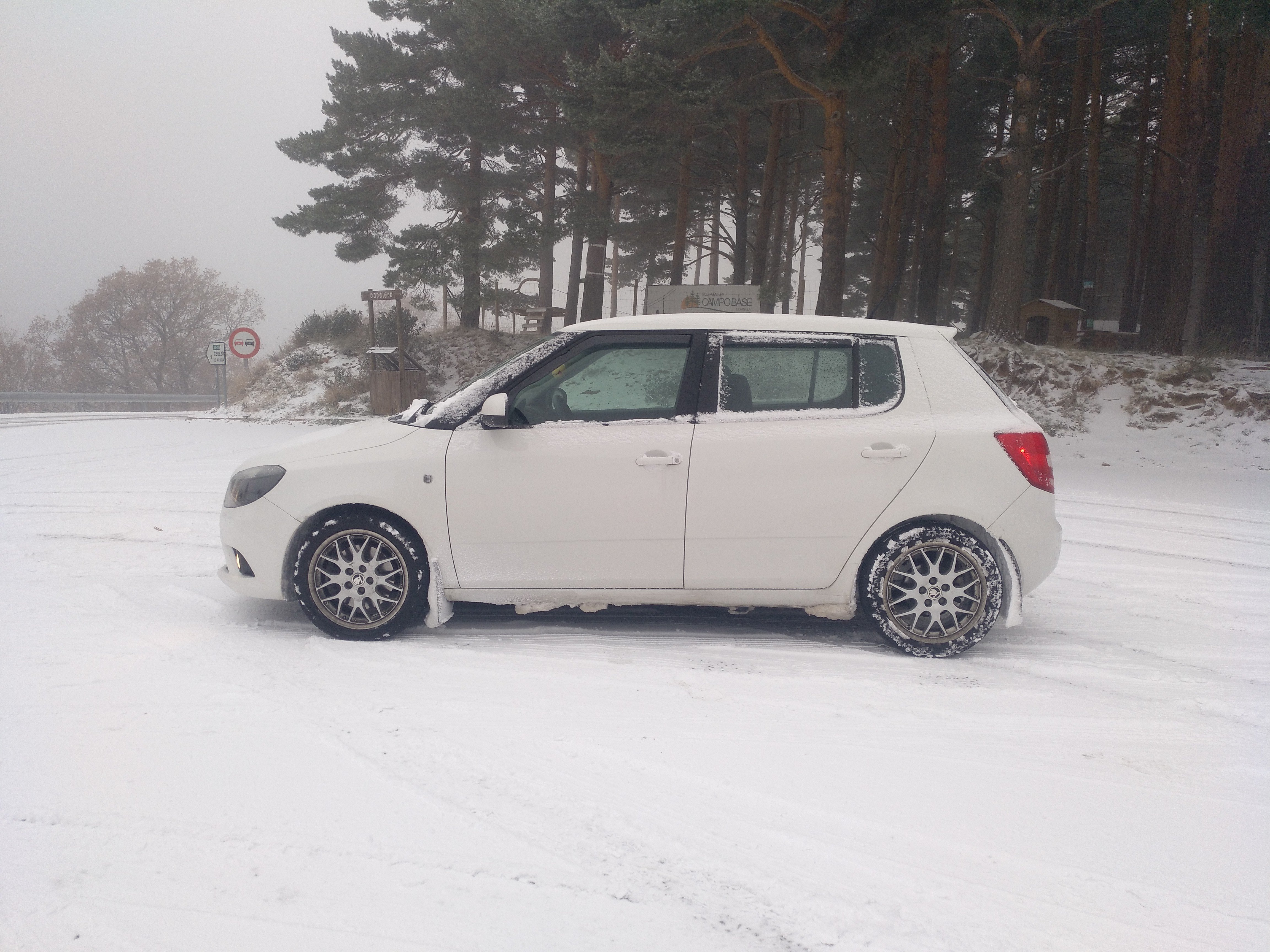

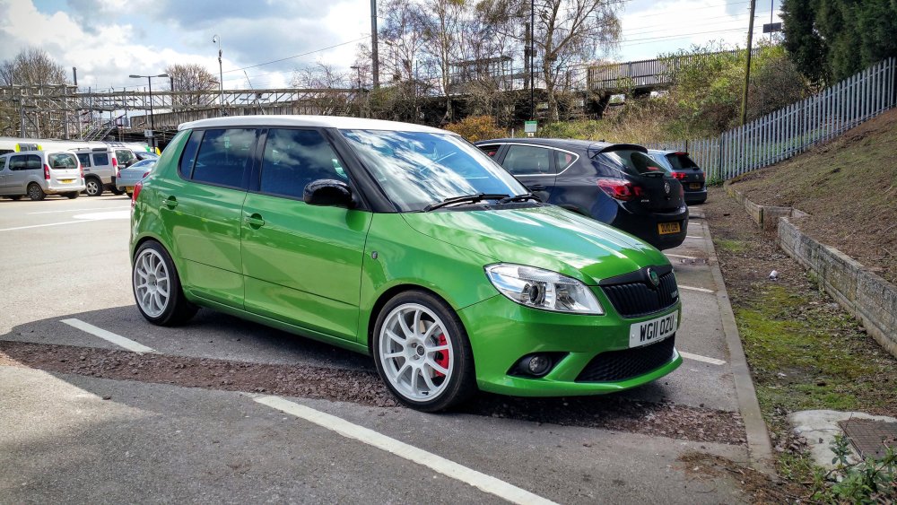

The White ones here are on the S2000 as they called it and many advertise as vRS / S2000, but they were all green with the sticker kit.

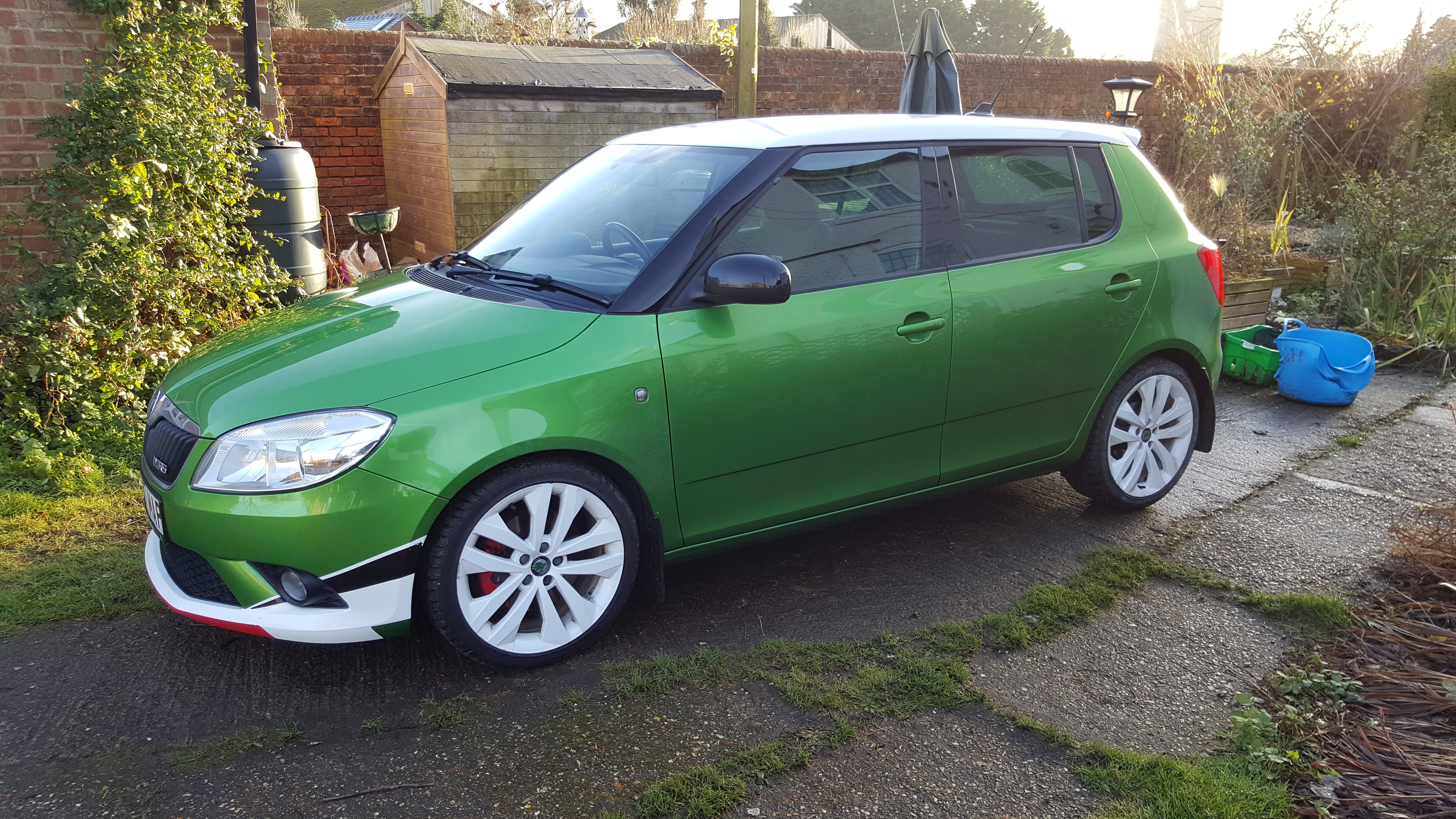

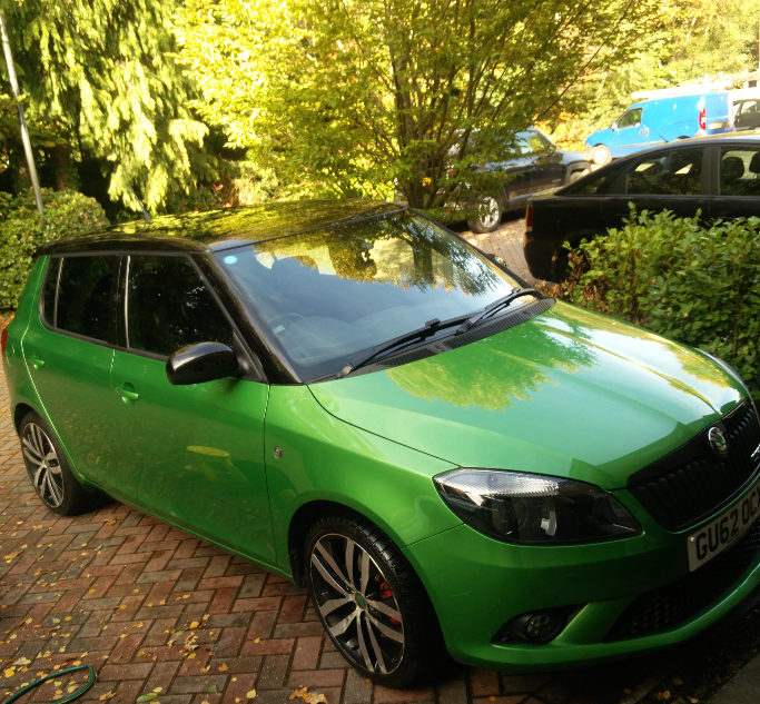

Sorry Rooted - Do you mean you have come across 3 previous members on here who have owned my exact car?  Or am i getting the wrong end of the stick and you've advised 3 other owners in simlar positions to me and you advised going back to the 17" Gigaros?

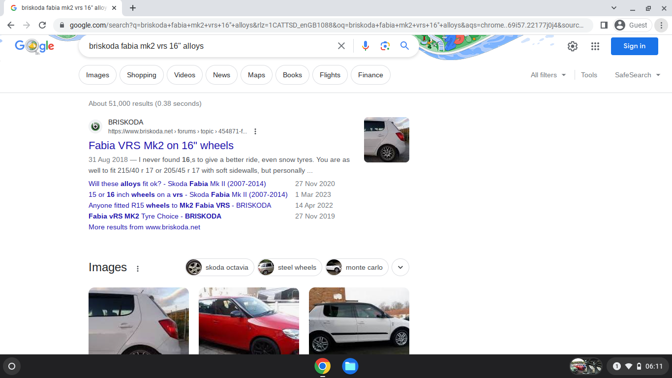

I am tempted to move down to the 16" or 15" to help with ride and save the wheels over the country roads - Would everyone advise the normal 5 spoke secondhand MK2 skoda wheels for this like the below?
Apologies to everyone again for my ignorance on all of this and thank you for your paitence!

The way I read it is he knows that three people have owned the green Fabia in the picture he posted which wouldn't surprise me. So owner 1 put those wheels on it then it was sold twice with the same wheels on it. He's also saying he'd put the same wheels on yours or putting on 16" rims. I don't know what size those wheels are but maybe George does.
I'd also consider 16" rims with more sidewall if you use a lot of B roads or even if you use many A roads given how bad the roads have become. The 17" rims were too firm a ride in the vRS IMO but that's what people wanted back in 2010 or so.
