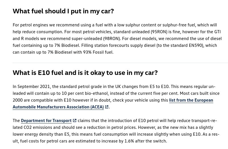

Fuel filler flap 98 (95) on the Twinchargers.
https://volkswagen.co.uk/en/need-help/need-help-faqs/fuel.html

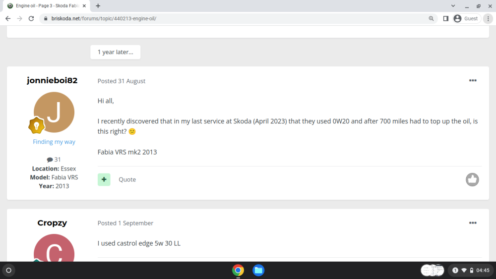

Hi all,
I recently discovered that in my last service at Skoda (April 2023) that they used 0W20 and after 700 miles had to top up the oil, is this right? 😕
Fabia VRS mk2 2013
I used castrol edge 5w 30 LL

That was very wrong.
I would do an Oil & Filter change.
 I would have whoever did the service and used that do it for free or refund you to have the oil changed.
That was VW508 00 / 509 00 that will have been used.  0w 20 FS IV
For the engines for the WLTP coming.
The 1.0 TSI 3 cylinder with a gpf & from 2018.
This says 2015 but they were not using it then and it is not backward compatible.
image.webp.b48e6771853b15b770e956a10ec5660b.webp.2721e5e275bfd9c6b35e39bef234c58e.webp.d44991ab9f4e6ebc308b0e8ac392191c.webp
Edited by toot
