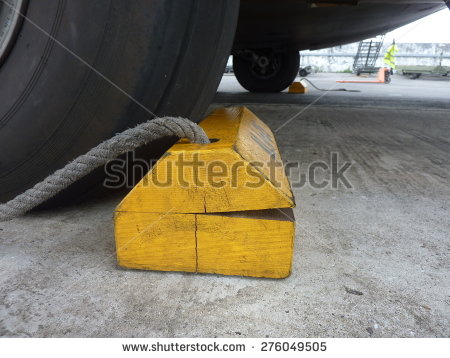

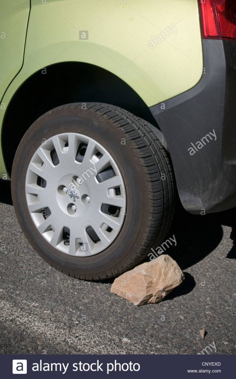

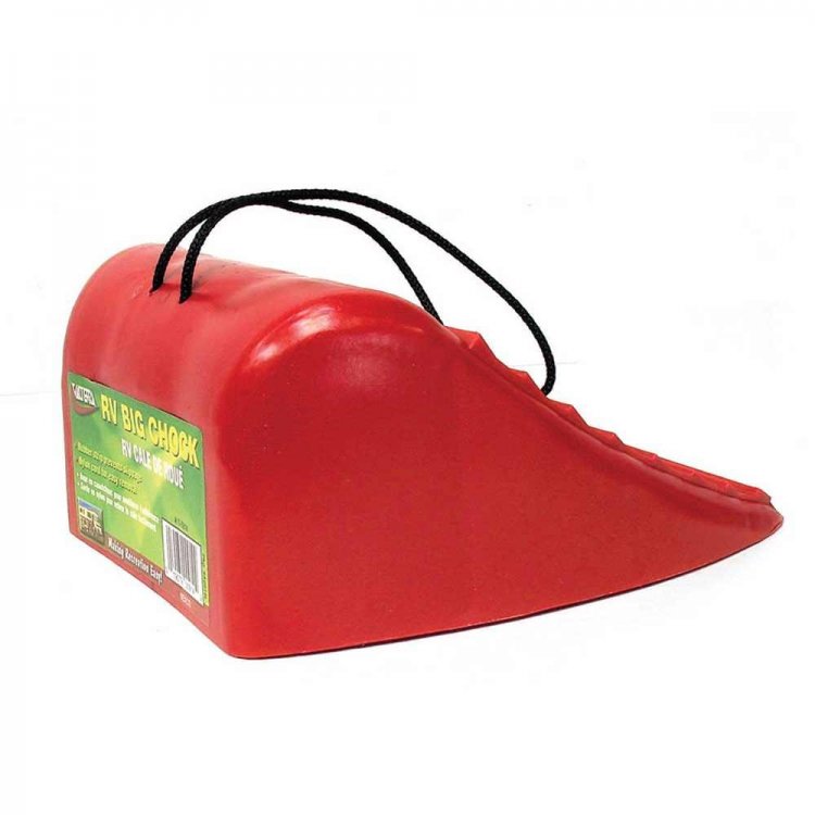

The Brick thing was only semi serious, but there are those that do leave vehicles chocked in winter and in hilly areas.
as it is with Electric Handbrakes these Old School type tricks seem to be coming back in favour,
like Steering Wheel locks as Electrics in cars are providing less secure cars.
Skoda might have to sell Blocks of wood with a rope through as a nod back to their 'Heritage',
Something like used to be used to stop Carts & carriages and the likes running away.
Or just sell rocks to keep in the boot, in a nice Skoda Branded Bucket.
Or they could just fit decent Parking / Emergency Brakes.
