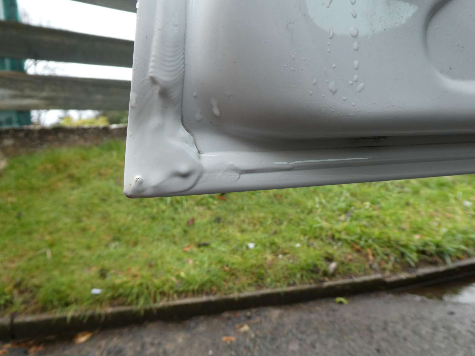

I gave the car a wash this weekend. Two months of muck cleaned off, wheel arches hosed out and 20 minutes spent getting tar spots off with white spirit, then I saw it.
Brown stain on bottom back corner of front passenger door. At first I thought I had nicked the corner, but all felt smooth. Looking closer the brown stain starts just above the door edge and appears to be coming through the paint. A photo from inside shows what looks like a break in the surface paint again up from the bottom of the door. It is booked in for assessment when back from hols in a couple of weeks.
Hopefully I've caught this early as photos only just show the problem.

Could be the dreaded Zinc inclusion,well known paint fault on the Yeti
Hi eribaMotters,
The image could have been taken from my 2015 Elegance. I had exactly the same rust on both front doors. It looked to me like the paint was thin ? However I gently cleaned up the area and applied the touch up and all has been well, I always check every time I wash the car.
M
Classic zinc inclusions that. Prepare for war with your dealer to get them to submit a claim on your behalf.

It is war because what you describe above is what SHOULD happen, but I and plenty of others have found that many dealers get their "qualified" person to inspect it and say there's nothing wrong.
You demand they submit to Skoda UK and they refuse.
That seems to be the defacto response in many of the dealerships.
I had to have a stand up row with the warranty manager on the forecourt in front of their customers to get him to change his mind and agree to submit to Skoda UK.
Fast Forward 3 weeks and I had approval for 4x new doors on my Yeti - and an apology from the Warranty manager who admitted to me he'd sent away many others with the same fault citing there was "no way" it was going to be covered under warranty.

car went in to Liverpool Skoda last Friday for work by Claridges of Southport. I collected it today and it looks nice. Receipt says:-
"...attend to Zinc erosion ... work carried out under corrosion warranty..."
Car looks immaculate, which is a bonus as I'd recently returned from a 1500 mile trip to France and it was a bit dirty to say the least.
