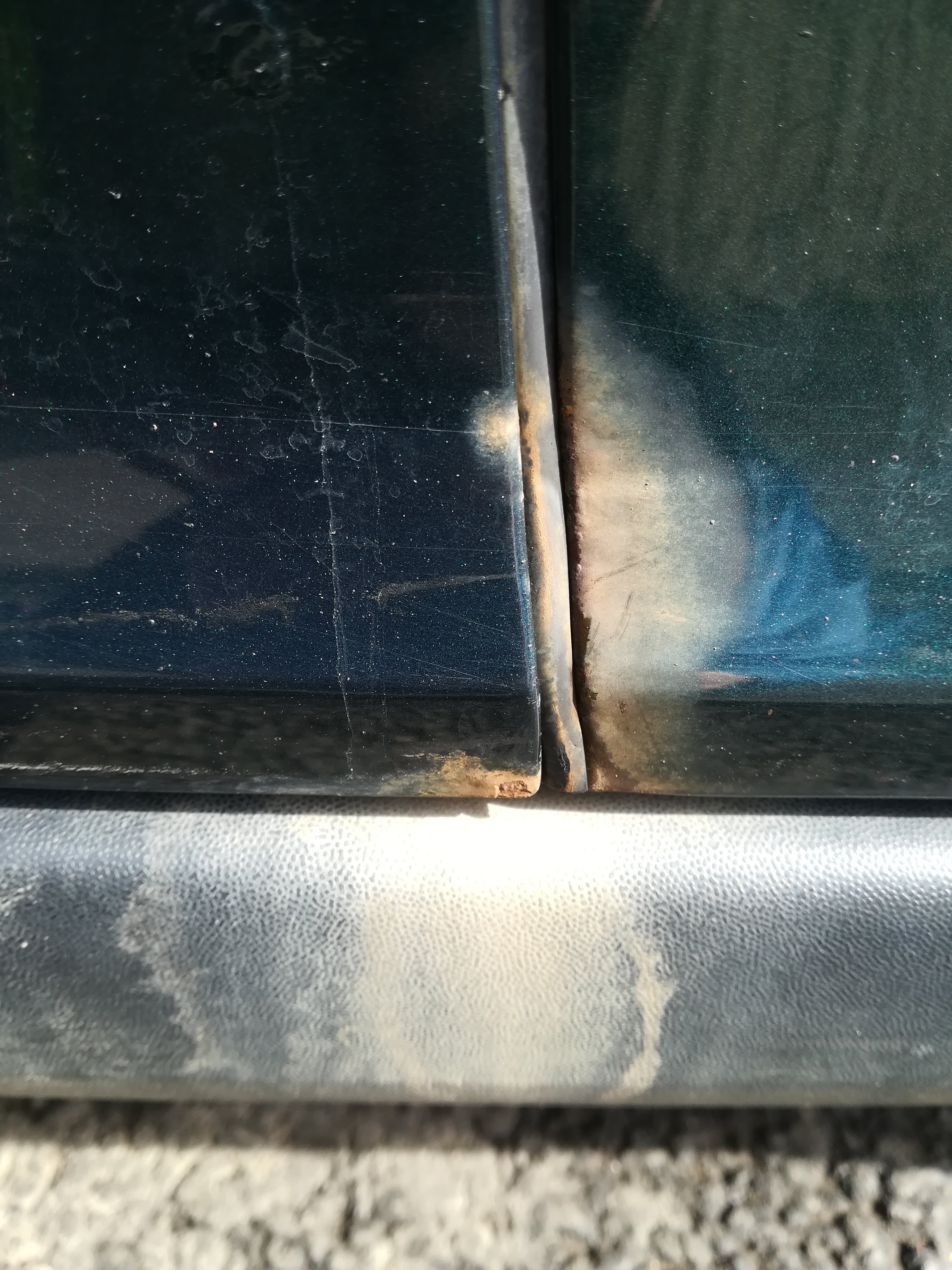

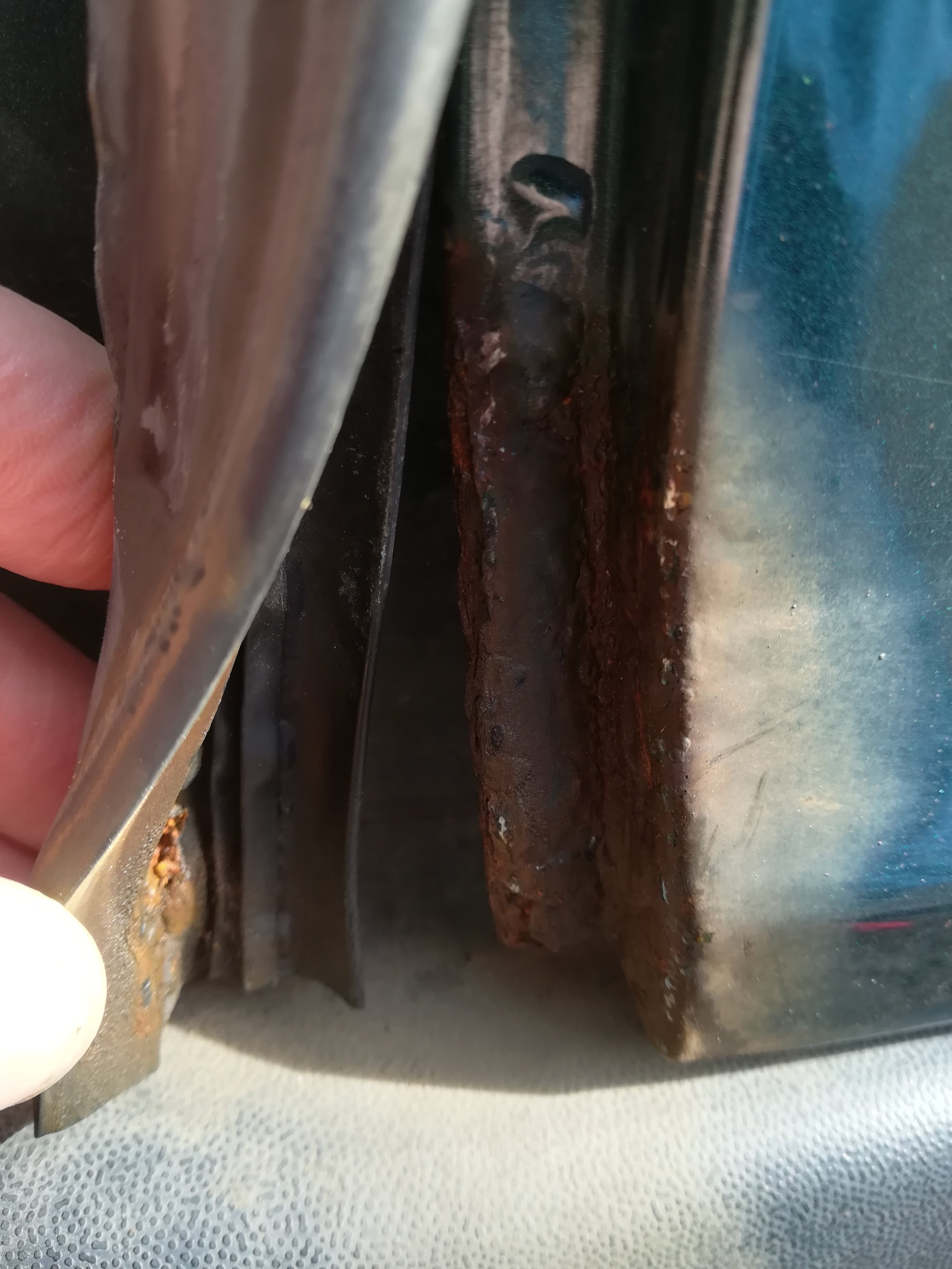

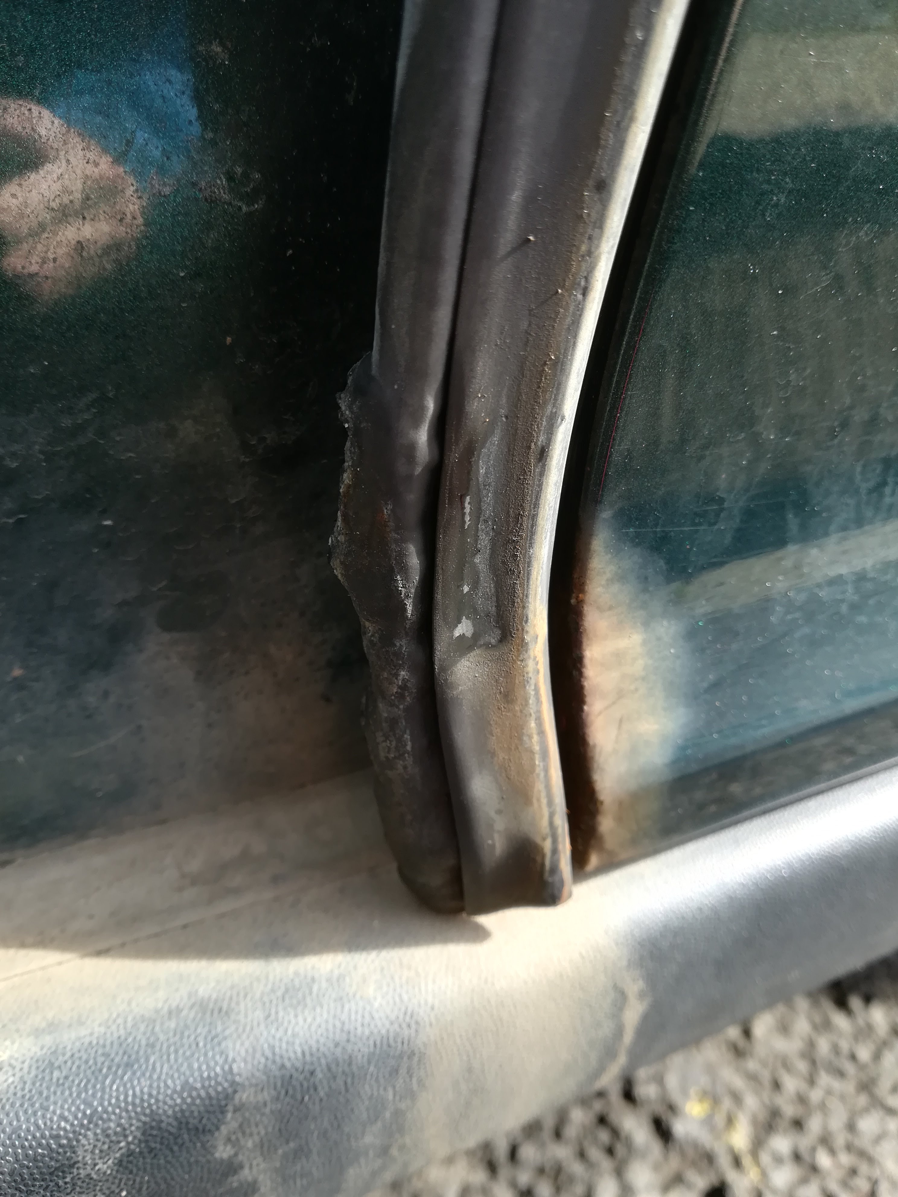

Happy owner of an almost 8 year old Yeti (got it second hand 3.5 years ago) with around 100k on the clock. Have read a couple of threads on rust/zinc inclusion but they mainly seem to deal with spots on the lower doors. I have an issue with what appears to be the central rubber trim deforming, coming away and maybe getting particles trapped which have then scratched the paint and finally its lead to rust. A bit of guess work but the end result has been corner rusting of the doors at the centre of the car.
I was wondering if anyone had anything similar or had advice on the best steps to take deal with it and stop it getting worse. Given the age and mileage I'm not wanting to spend a fortune but happy to take it to a specialist if its not really a DIY fix. No similar experience so no idea what the charges are likely to be.
Some pics attached of the worst side.

I've had this problem, but didn't let it get that bad.
Yes, you're right, road dirt drops under gravity and concentrates between the seal and the painted edge of the door. The top part of the seal is pretty straight and doesn't have the bends which distort the seal and rub so much.
I sorted out the door edge with careful aerosol spray, and cut some thin film heli tape about 2mm wide the full height of the door edge to contact the tape. After two years all looks good.

Yeah regretting not having a closer look sooner. New baby and winter means the car hasn't had a wash in far too long and assumed it was just dirt. Had noticed the staining under the join previously but thought it was just a watermark. Looks like it had started to rust before the winter and then the water and salt have done a good job.
If it’s red it’s rust

Have trimmed the seals to stop them doing any more damage and will get a quote from a body shop. Might pop by the dealers but have a feeling I would just be wasting my time.
