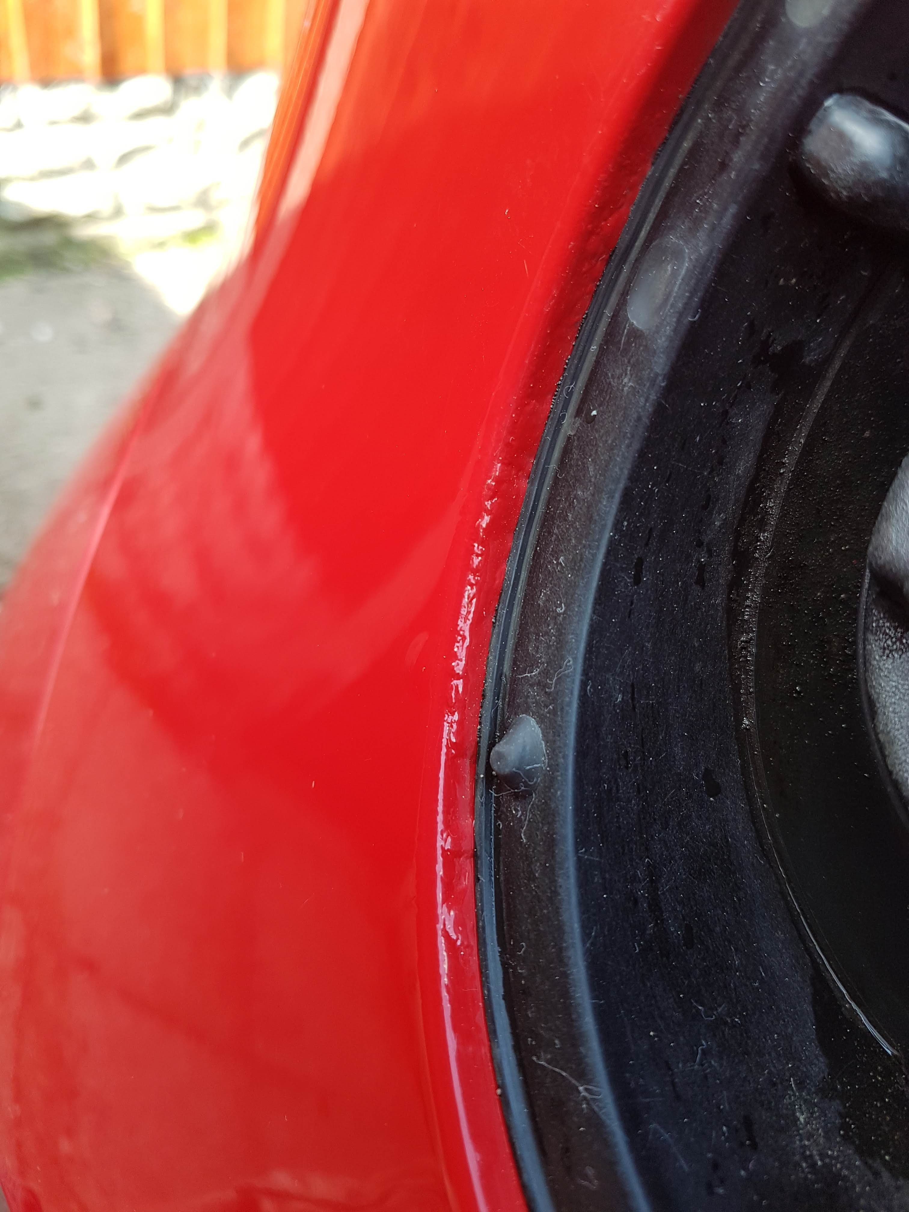

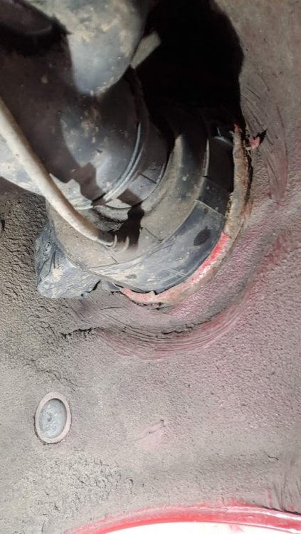

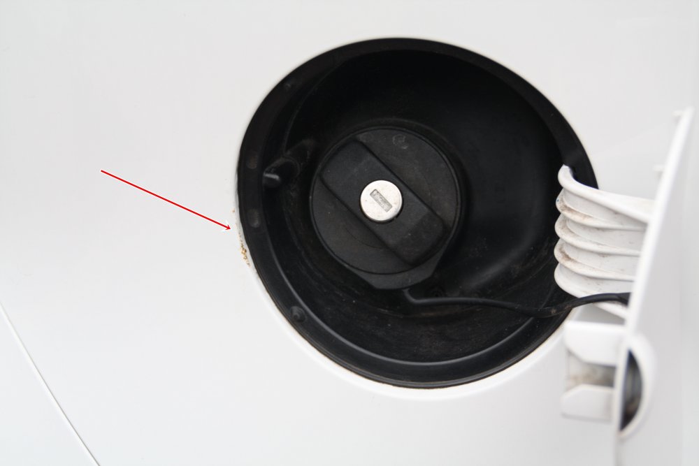

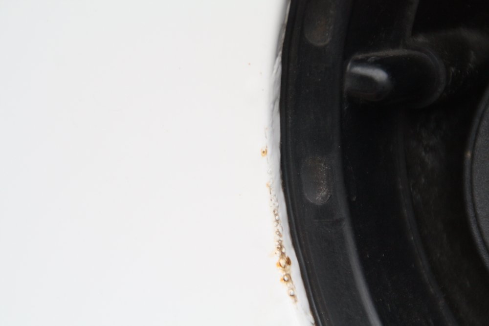

I have discovered exactly the same thing on my 2014 Citigo Greentech. I am having a huge problem getting Skoda to honour their warranty on the body work. Have a look at the photos and see what you think. Any other instances of the same problem would be a great help in trying to get Skoda to honour their 12 year body warranty!

I hope it does not take much longer as it soon will be perforated. It does seem a bit silly to warranty against perforations as these will be much more difficult to deal with than the initial rust which leads to perforation!

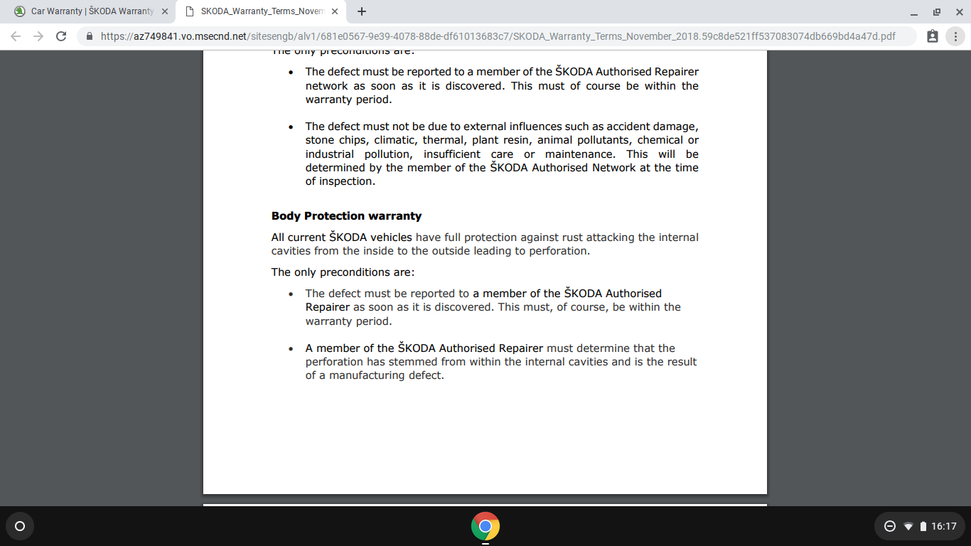

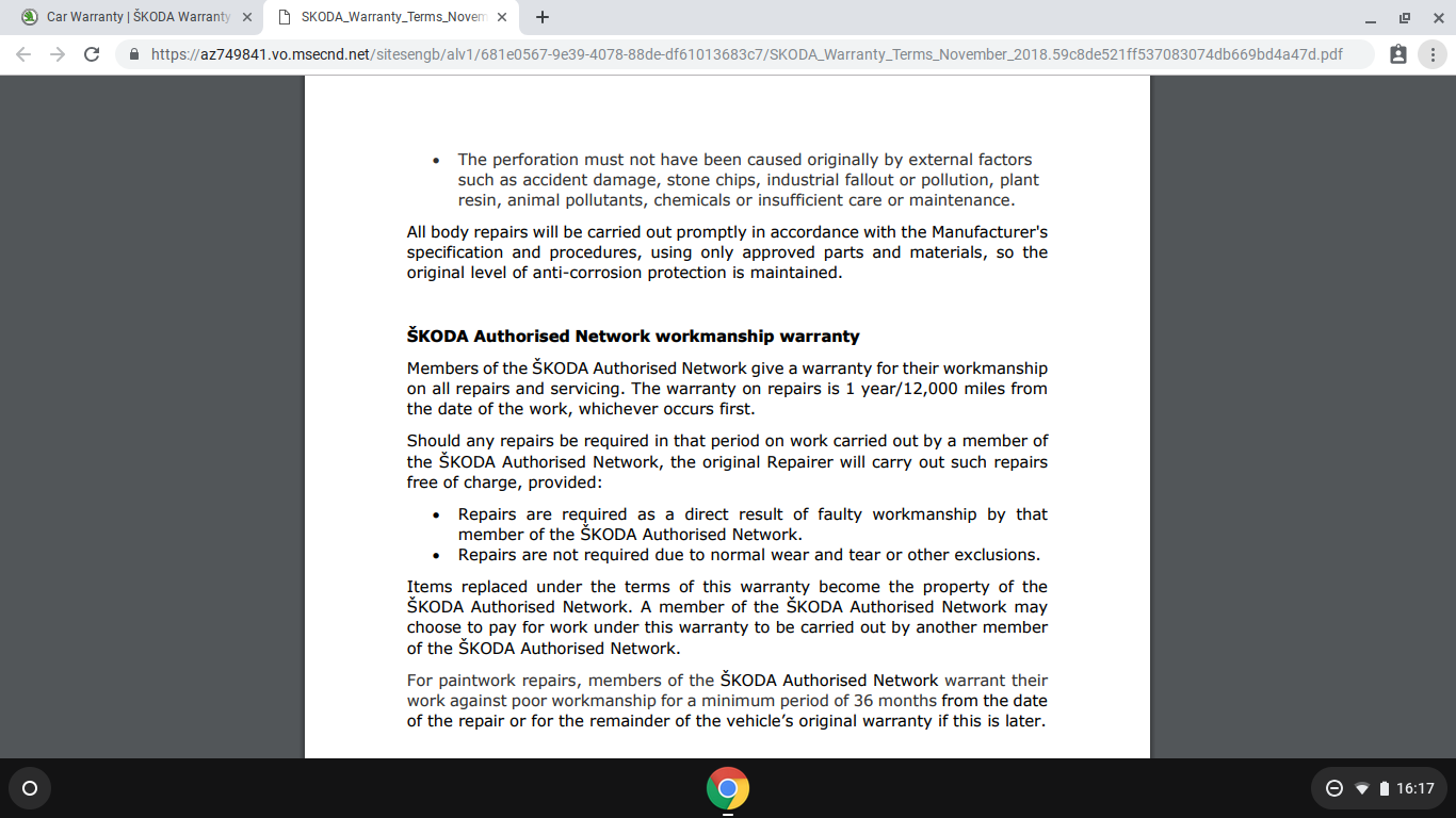

Who carried out the Body / Corrosion Inspection and wrote the report for Skoda UK, and did you get a copy?
Edited by Roottootemoot
I have so far dealt with this over the phone. The dealer has rejected the warranty claim, and I have spent 2 hours on the phone to Skoda UK so far, and have emailed them everything that has happened with the dealer.  Skoda UK are promising to get back to me by Friday. I cannot for the life of me see what is the problem. As you see above, it is pretty clear where the corrosion is coming from! My warranty document is slightly different and does not say the same as the one above. It says ‘All Skoda vehicles are fully protected against corrosion emanating from the inside the body panel for 12 years from the date of first registration....’
It seems Skoda have moved the goalposts since 2014. Maybe this is why they are being so awkward?
First problem is the Dealership Employee and Customer Services employee needs to follow the correct procedure.
You do your bit, you report ASAP.   Then you are asked to bring it in to be looked at.  Someone can take pictures if they want, but if they are not Qualified to do the Inspection,
check if the paint is original they they can start arranging for someone that is to inspect it.
VW / Skoda set out what needs doing.
 Perforation from the rear / internal cavity to the front / external will come, and within the 12 years, then you can ask for a new panel,  so they better move their lazy backsides now.

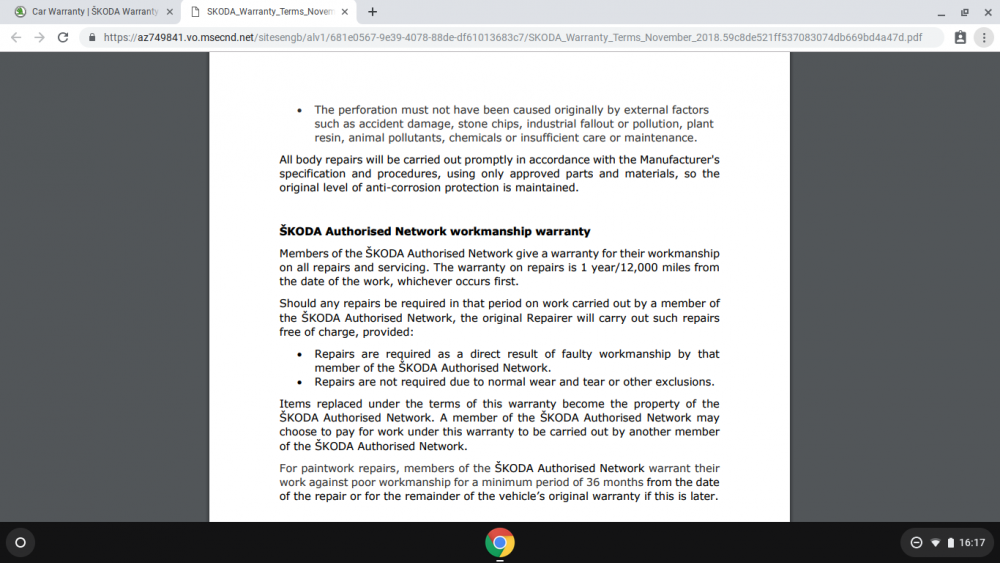

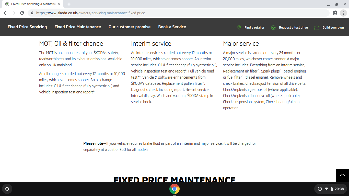

If they ask why Annual or Bi-annual Body Inspections are not on record as being done, ask them why not as the car had Main Dealer Servicing and it is part of the Services and should be carried out, if not the records show who never did it.
*Vehicle test. inspection and report'
That used to say Body & Glass inspection, but then Service Books used to have a page after the service to have the Inspection of the body for the warranty on Paint & Corrosion.

There are conditions though. One of them being that the service must be carried out to manufacturers guidelines. So as long as the servicing garage inspected the bodywork and filled out the appropriate record then they can’t wiggle out of it.

That looks as though already been painted over the rust in the hope of hiding it.
