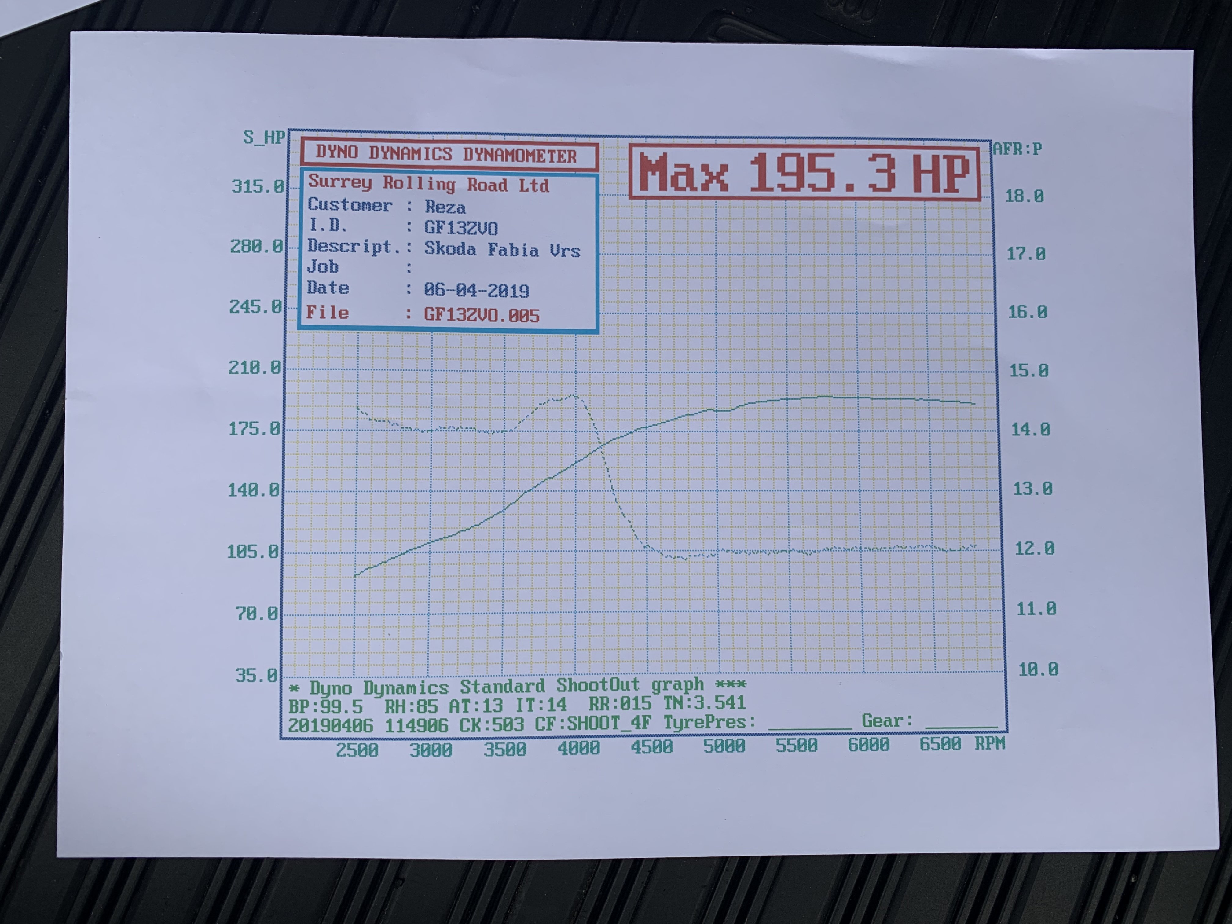

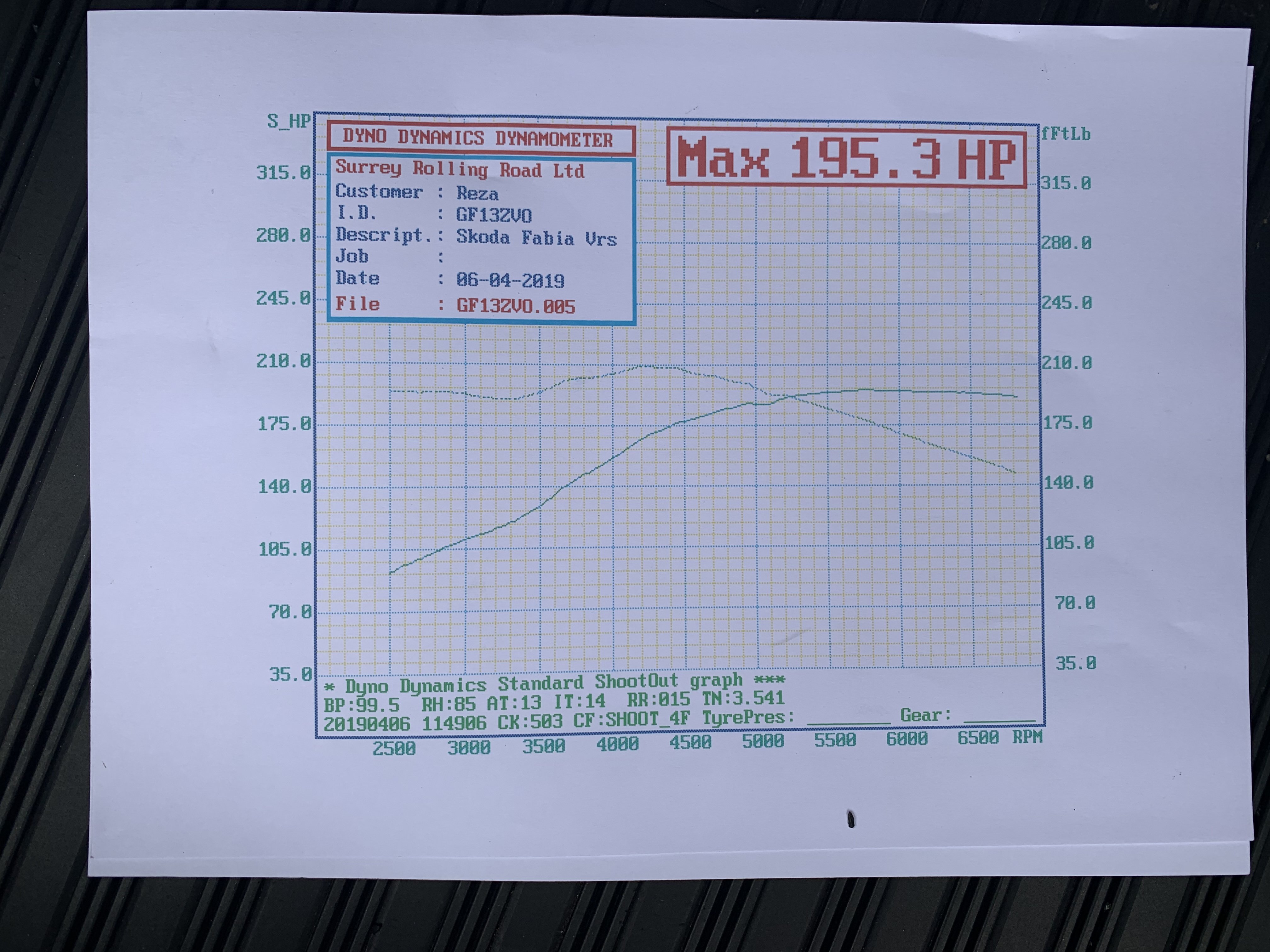

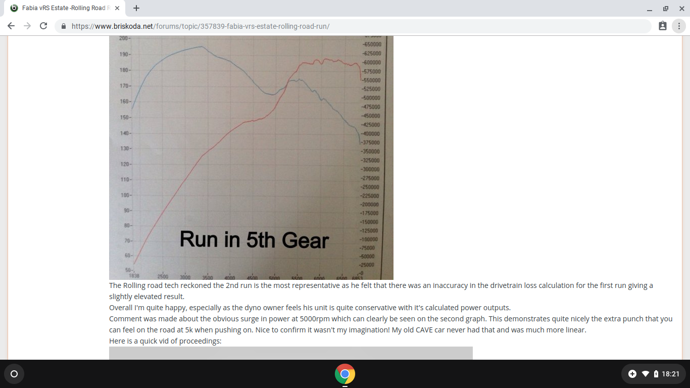

did 195.1 BHP today
will post a picture of the graph later on
AFR was really good too
really down as I didnt do the dyno before the map

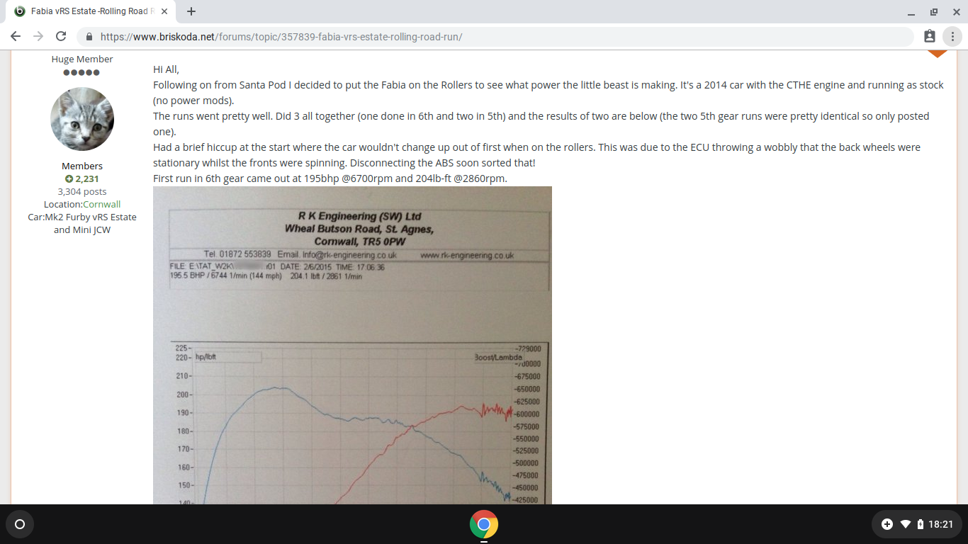

http://briskoda.net/forums/topic/357839-fabia-vrs-estate-rolling-road-run

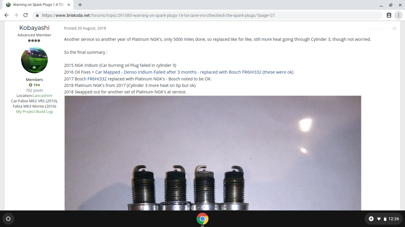

Incredibly disappointed for not having done a dyno prior to the remap.
But a standard stage 1 remap should give me what sort of BHP and 0-60 sprint time?
based on your evidence of CTHE’s being known for running 195 BHP as stock, i’m thinking this guy has done absolutely nothing to my car but charged me £200?

PS is it me or is that dyno graph fluctuating badly

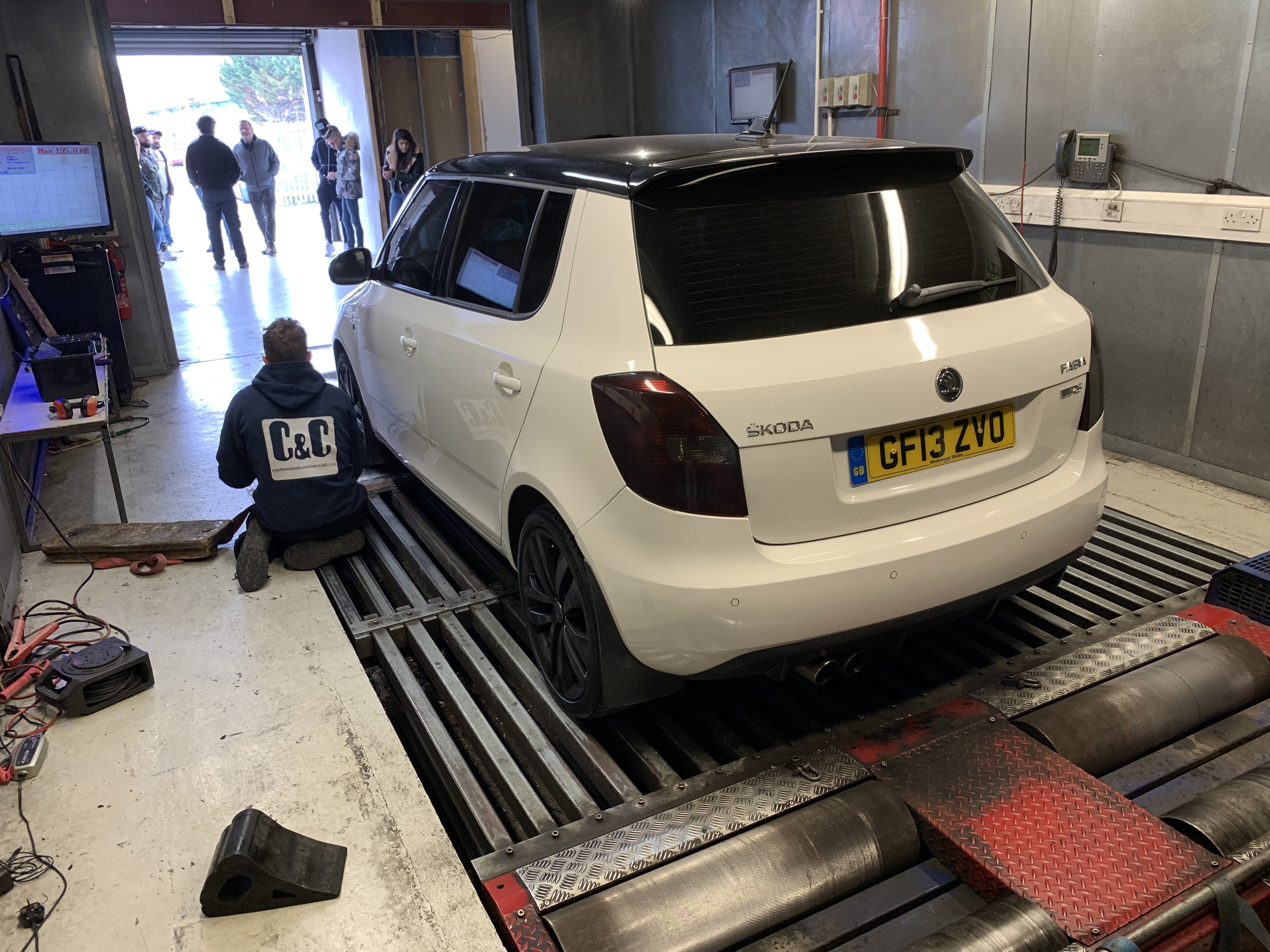

some pictures of the dyno yesterday

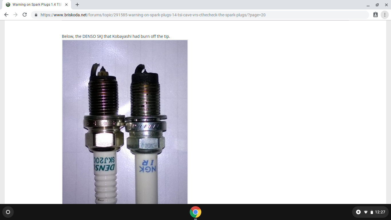

but then one member here followed my advice or others advice and one DENSO plug did burn the tip off.
I went to DENSO on advice of a close friend who was a AUDI Master Tech who had worked on Twincharger faults,
and went to the Ignition Coils and Plugs that VW / Audi were starting to try.
The Audi A1 1.4TFSI 185ps was and is nothing special, and Mk2 Fabia vRS could produce the same output.
I ran them on stage 1 and stage 2 without issues.  They do not change the power output though.
Upgrade the Ignition Coils, the Plugs etc and get a decent Remap and you are sorted. More oomph.
You can get a nice Bling Alloy part to fit with the Upgrade R8 Ignition Coils.
Edited by Skoffski

So alongside the GPB DV+ diverter valve upgrade and brand new plugs you reckon i wont see any performance enhancement?
To your last point about 213ps, is that solely with R8 coils and good plugs? Or plus a remap?
The members video that was in that thread said 213ps. Stage 1 i believe at that time.
205 PS-210 ps plus was common with Stage 1 Remaps.

Was TC off when they had it on the DYNO?
220ps. So that will be Stage 2 plus.
Edited by Skoffski
Traction control was off yes and it was in manual mode
So it had 6 gears. I take it it was not going to be going to 7th anyway.
I dyno them in 'D'.
I really wonder what he actually has changed from the Engine Management on the ECU from the replacement engine being fitted.
