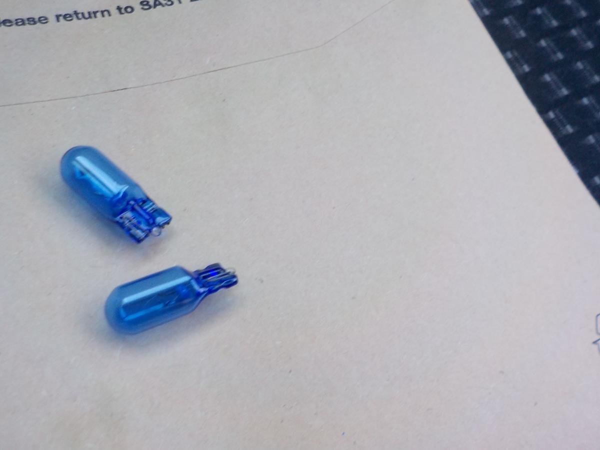

It is Normal.   Little Blue Dummy Bulbs in the headlights.

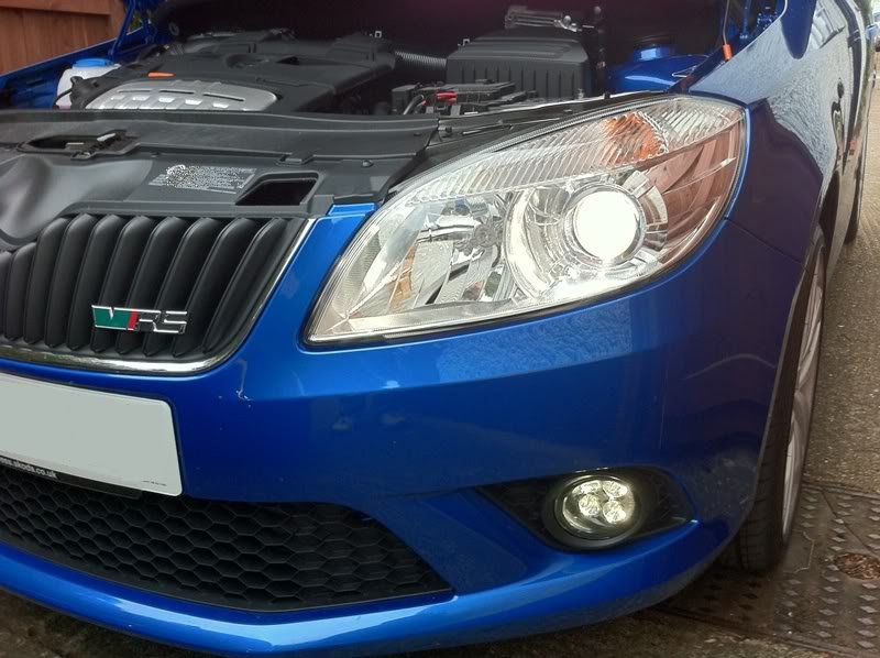

Your DRL's are down where Fog Lights might be expected (the switch in beside the fuses can switch the DRL's off) and put on your Sidelights or sidelights & Head lights and they become Side Lights. Less bright than when DRL's.

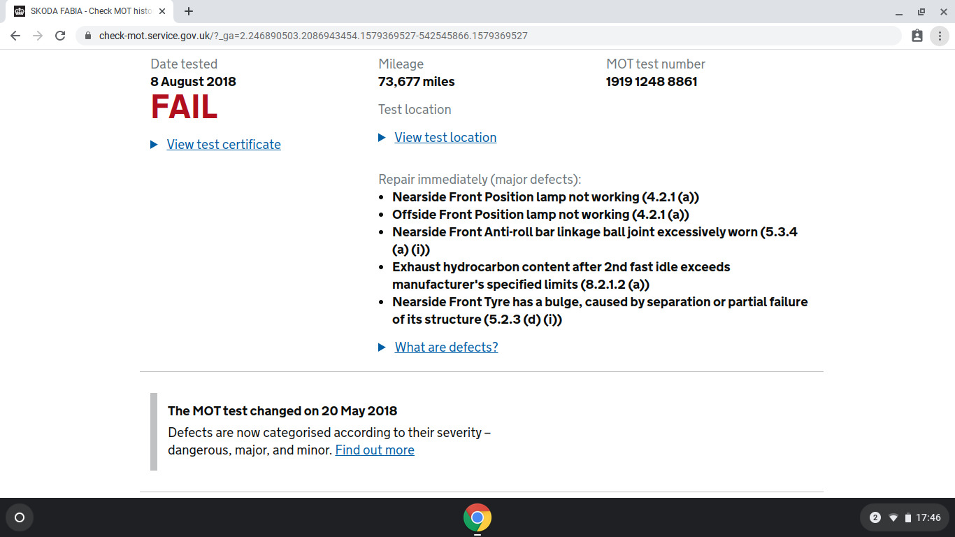

The Sidelights make the car legal even if others might think you are a d!ck with Fog Lights on.
They have MOT testers fail cars because there are no Side / Position lights to front right or left.
  That happens regularly.
eg

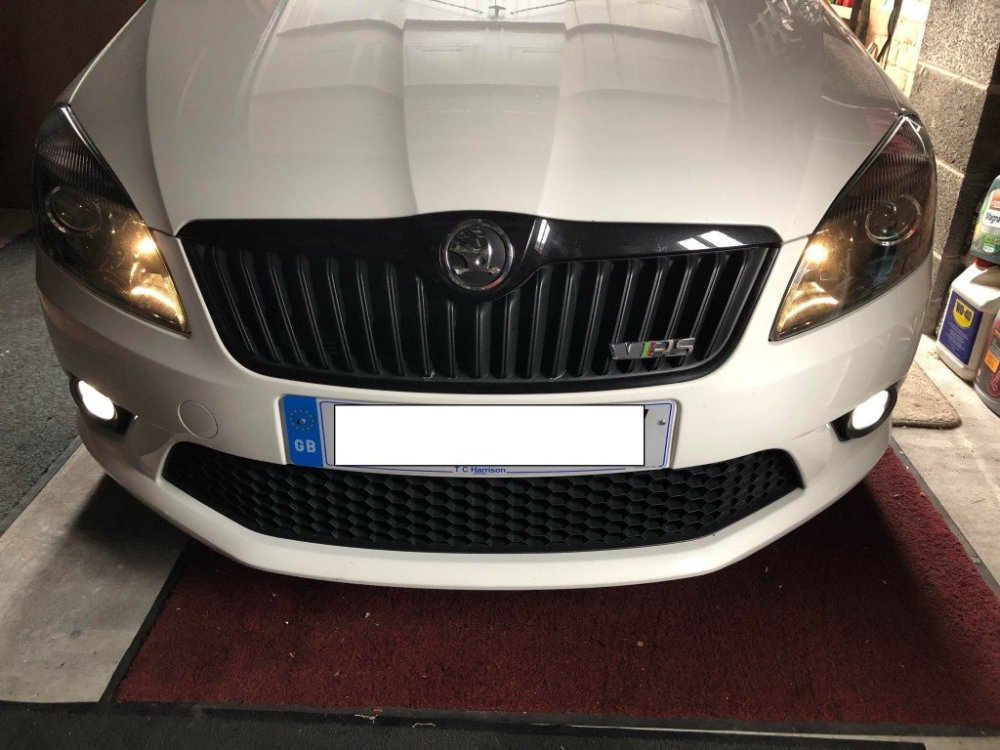

mine work  😁

How did you get them to work and that black grill looks sick on white
Yes I did modify the vehicle so they work, I will try to do a guide for those that may want to do the same.
Edited by UrbanPanzer
Ahh thats when I did it yes, I do have some more specific photos of what goes where etc, so will combine into a webpage, may even do it tomorrow 👍
Mine also work, and I haven’t modified it, so it must have been the previous owner. Interesting,
