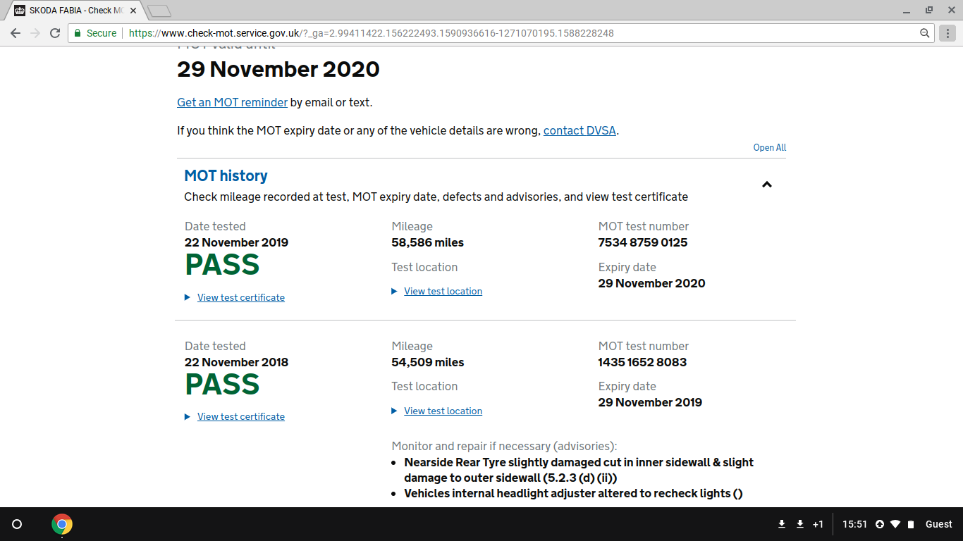

All the advisories are tires over the years, so thats pretty good.

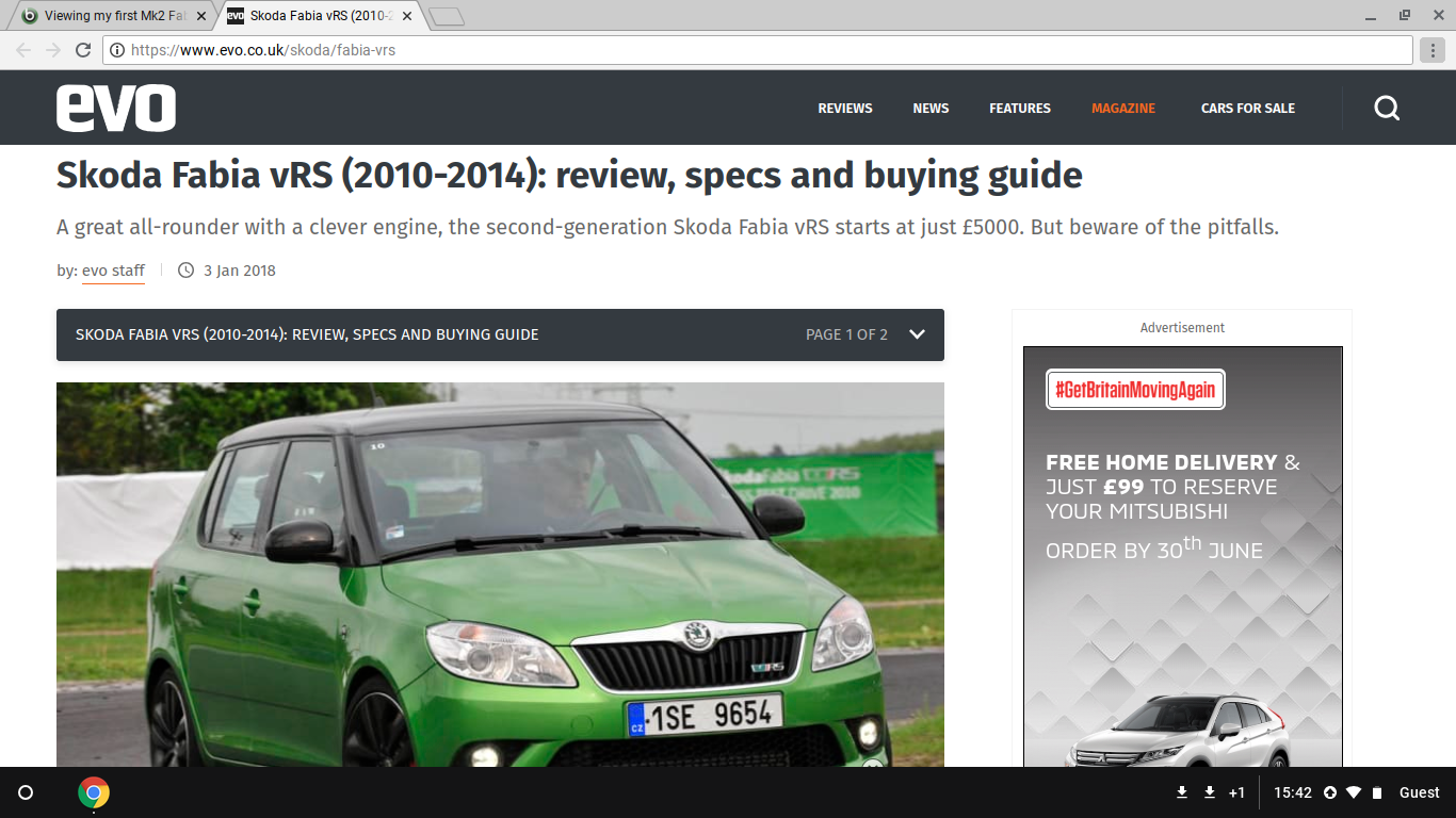

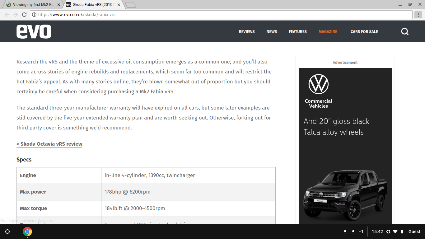

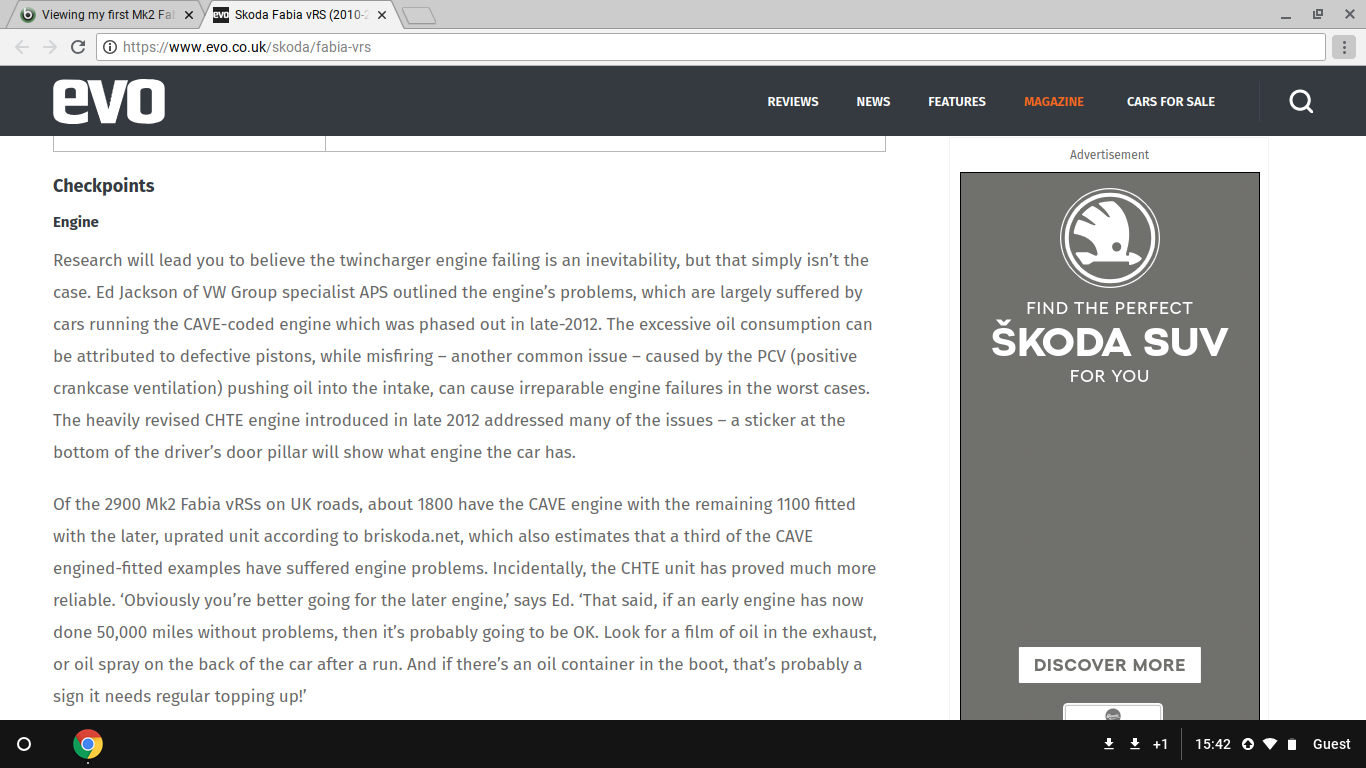

http://evo.co.uk/skoda/fabia-vrs
Some information on here attributed to others is word for word from posts i made on here.
Cheeky barstewards.
