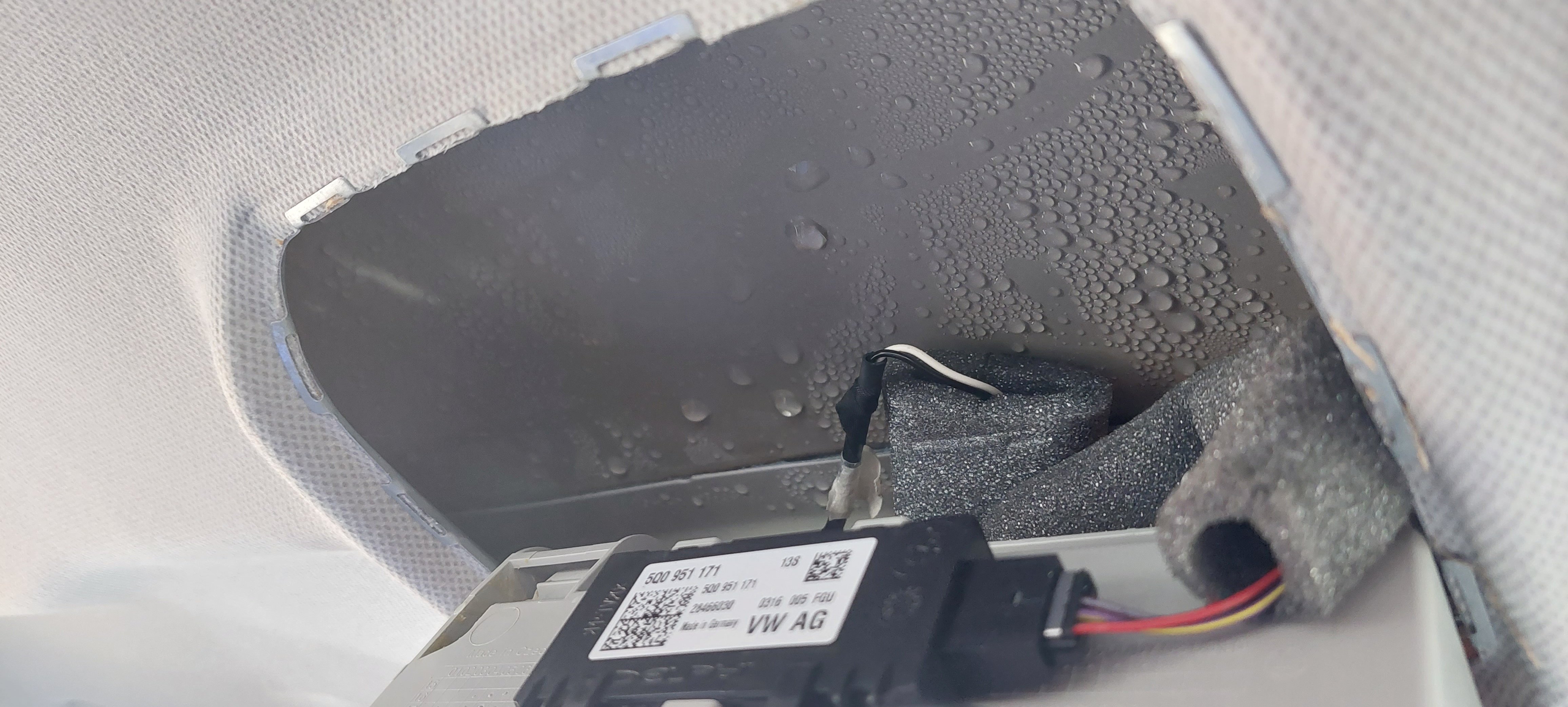

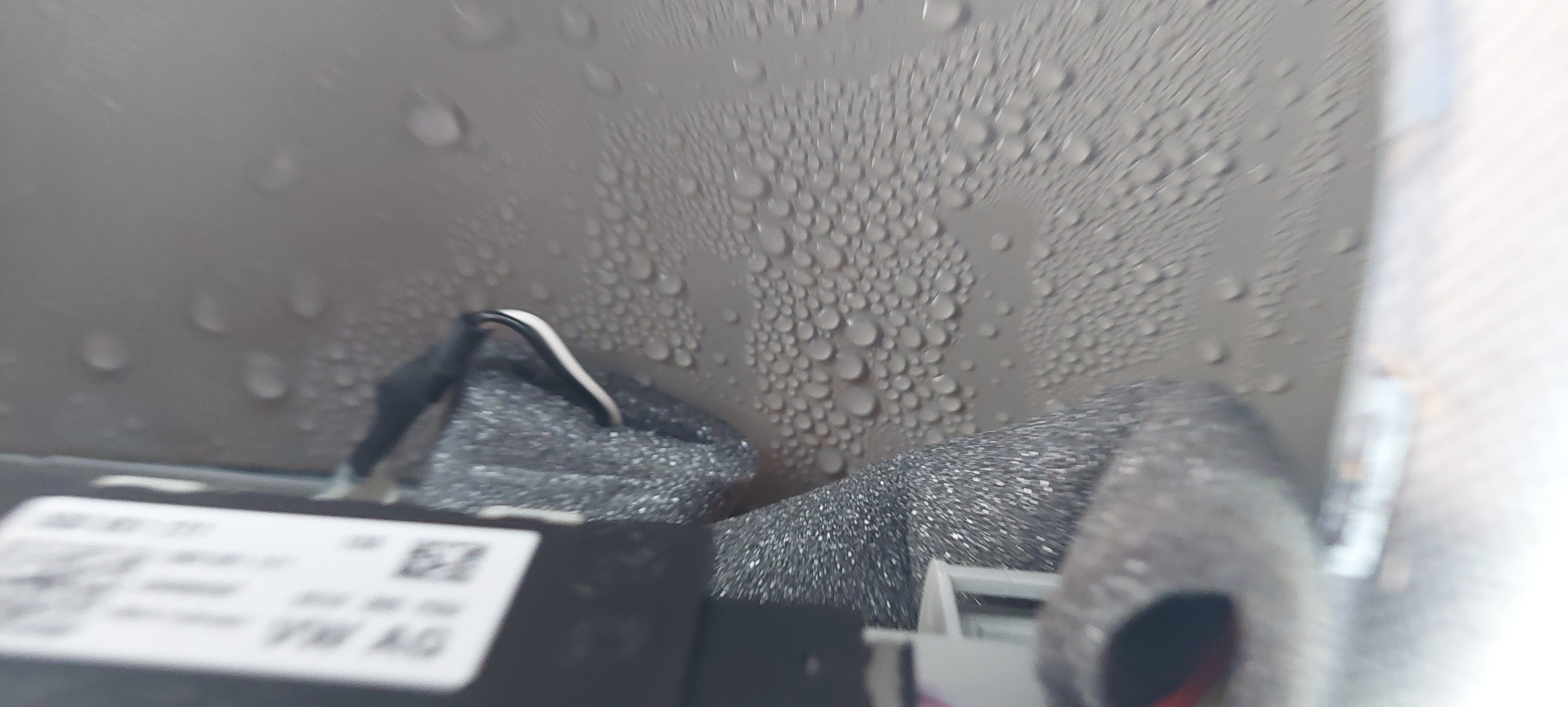

I seem to have the same problem with the inside misting up, only now I've removed the sunglasses holder in the roof and it's full of condensation/water , not sure if this is roof bar seals?
Having seen the photo and now learning that you have misting problems I retract what I said on another thread about the vehicle having a roof or screen leak.
You are seeing the condensation there because the car is damp (misting, may even be a leak further down) and the water vapour is condensing at the highest coldest point, the roof lining insulation is cut away to make space for the sunglasses holder with bare cold metal above it.
