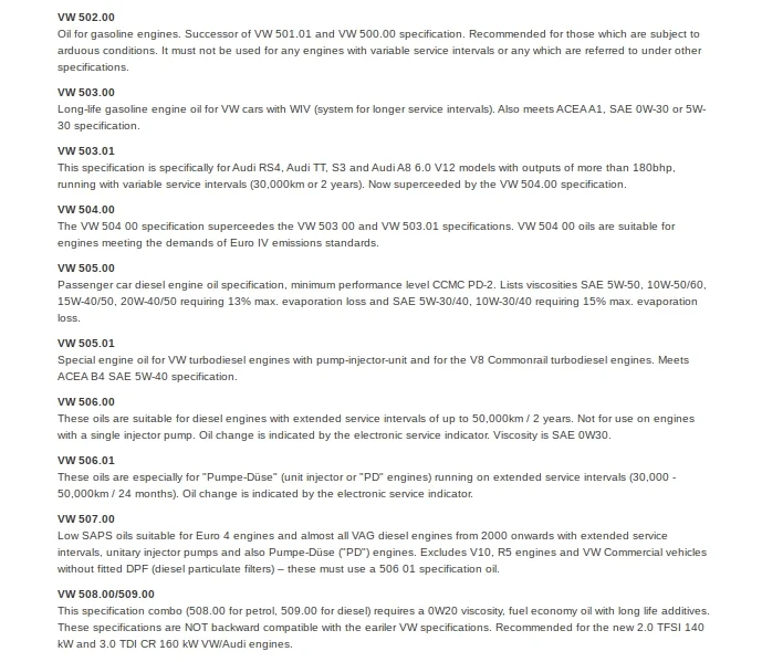

The person at the dealers is wrong.
 5w 40 FS to VW502 00 is not long life oil and is for Fixed Service Intervals.
The recommended oil for your car is the same as it left the factory with.
VW 508 00 / 509 00  so 0w 20 FS IV.
If you do choose to use the old spec of VW504 00 / 507 00 so 5w 30 FS III thst is your choice but it is not the recommended oil for your age of engine.
After the WLTP was introduced, and with a GPF.
This is from the Mk3 Fabia section but if you do a search   Briskoda VW508 /. 509 you will see the threads and in them posts showing how often clueless staff at dealership tell people the wrong oil for their cars that have been produced since 2018/19.

5w 40 FS can be used for fixed services.
But your car left the factory on Variable / Flexible servicing with Long Life oil.  VW 508 00 / 0w 20 FS IV. It was changed to Fixed at the PDI.
Have you never topped it up since getting it?
Only 5 weeks to an oil change but i would not be putting at least 1 litre of 5w 40 FS into the low quantity of 0w 20 FS IV.
The owners manual tells you in an emergency you can use another spec and you can,
but this is not an emergency.
At least use 5w 30 FS III if you must, (VW 504 00 / 507 00)
it is long life oil you will mix with long life oil.
Your choice though, do you own the car and is it a keeper or going back in 2 years?

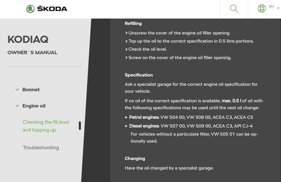

If you read the handbook (not everyone does), it actually says can top up with other oil specs in small quantities.
@Billywizzo If it is due oil change in few weeks, and you are only adding about 100ml you won’t do any harm adding bit of 5w40, leaving oil level low is lot worse.
