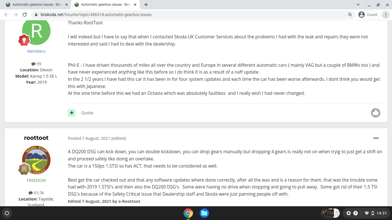

Was your car one that required a Software Update already on the Engine or the DQ200 DSG?
It might well be a new MCU (Mechatronic Control Unit) as well as an ECU.
I hope they have you in a nice courtesy car while you are out of your own car.
EDIT.  So there was issues already.   SOFTWARE UPDATES CARRIED OUT.
 Time really that Skoda UK get Skoda CZ to move their backends.    I would be getting Kate Laws involved if she is still there suffling papers.

I have the same car as you. 2019 DSG SEL and I can't imagine how annoying it must be.  I am in Devon too.  My dealer is none too great either.
I had to email the dealer principal once due to being so unhappy with the lack of communication and apparent lack of any urgency when I had an issue (unrelated).  He took personal ownership because if you make a formal complaint to the dealer principal it is discussed at their regional team meeting weekly (so I was told). In fact I think I even went to the Dealership HQ and raised it there.
