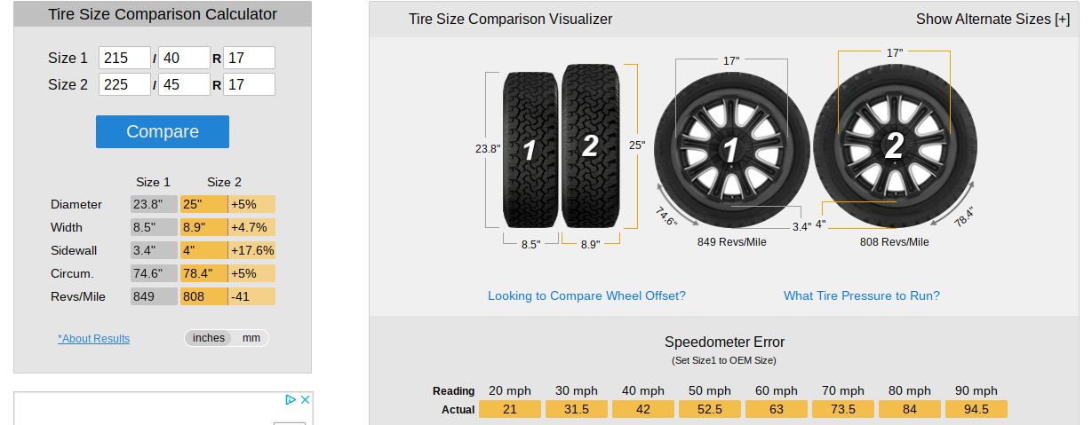

@Carlstonmight be along with all the sizes and rims you need for the tyre size you are looking at, but here is a comparison for you. 'Too big basically'.

6 hours ago, leogeo90 said:
Has anyone put to a 17" wheel a tyre with dimensions 225/45? And if it is then what wheel exactly has put on?
225/45R17 is an Octavia MK1 to MK3 sized tyre.
The Rapid uses smaller Fabia MK3 sized tyres.
Up to 185/65R15, 195/55R16, and 205/45R17 should be fine.
The below 6.5Jx17 ET40 rim fitted with 205/45R17 tyres would be ideal for the Rapid.
