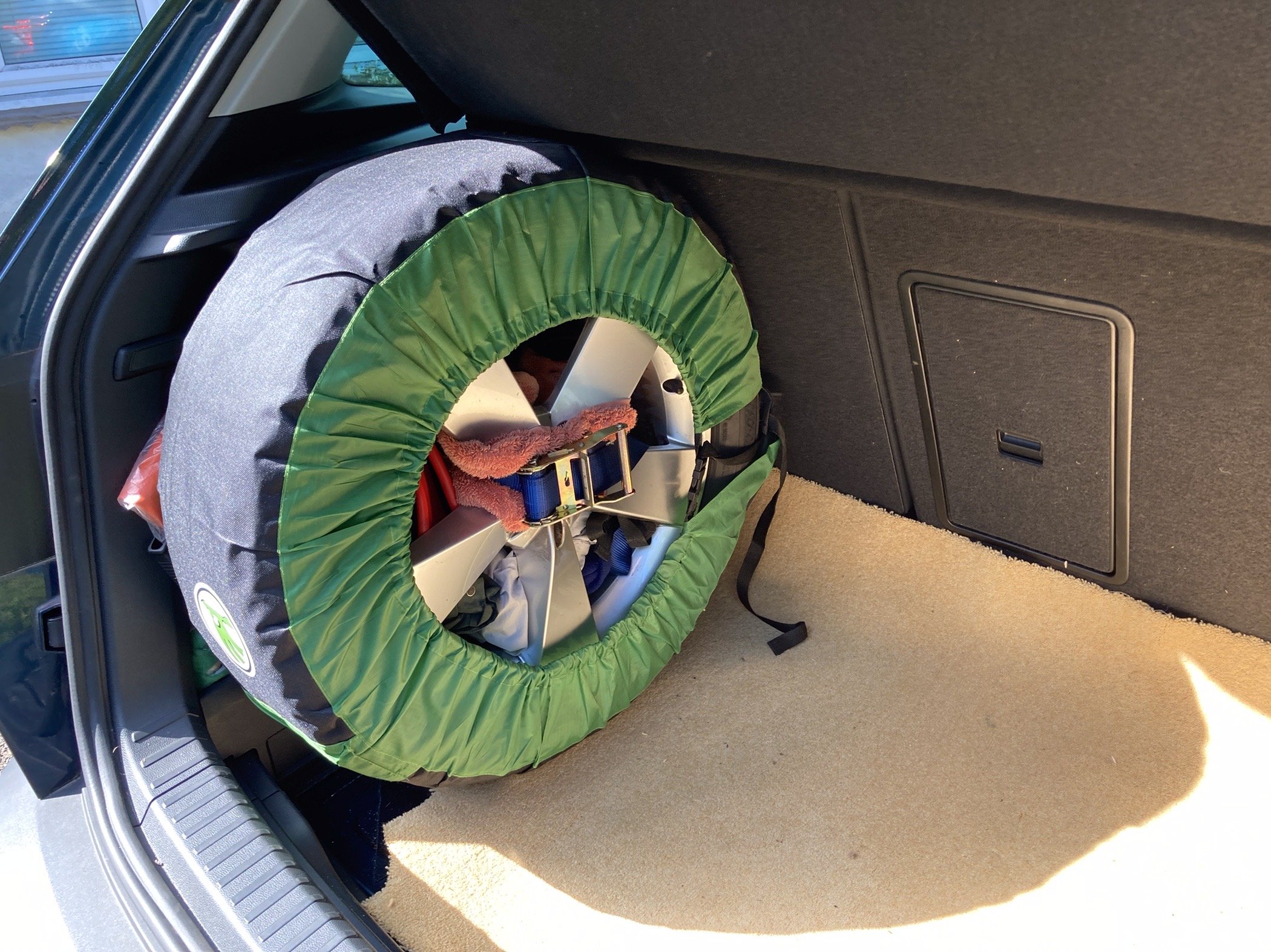

There is another option to the standard space saver kit, full sized alloy in cover mounted to the side of the boot.  Bit left field but works a treat.  Makes a deeper but narrower boot and lots of stuff can be stashed behind the wheel (jack, tools, etc).  No piddling around with space savers or different tyre sizes.  Not for everybody but works for me.
I decided to buy an absolutely identical alloy wheel to the 18” wheel on my Karoq SE-L, and fit the exact same tyre type which I have on the other wheels. That way, if I ever need to use it, I don’t need to consider it as temporary in any way (unlike a full-sized steel wheel). My Karoq SE-L has the Varioflex rear seats, and officially you can’t have a full size spare wheel with these seats, but in fact you can. You just need to cut away a bit of the polystyrene piece which runs along the rear of the Varioflex seats, so that you can access the seat handles. Compared to the space saver which came with the car, I lost a bit of the boot depth, but that was a price I was willing to pay, in order to have a 100% drop-in replacement spare wheel.
Im probably jinxing myself now, but I cannot ever recall having to change a wheel at the roadside. Quite a few slow punctures or flats at home or work, where I have taken the wheel to be repaired/replaced. Perhaps I have been very lucky? I don't know the statistics for punctures and tyre failures, but in 45+ years driving I have covered many miles. 300-400,000?
So is it a "peace of mind" thing? Perhaps others have had a terrible experience, and this made them seek out a decent replacement wheel for future blowouts.
Both DSL's picture and especially the comment from  Mark Surrey made me laugh.  "I don’t need to consider it as temporary in any way"
Ok so you have a puncture and you change wheels, what happens then? You're going to do exactly the same as someone with a temp space-saver or gunk does and get to a tyre centre a.s.a.p. otherwise you'll be running around with no spare wheel. Apologies but I can't see your logic.
Location location location.  Like maybe in Scotland and Christmas / new year holidays with people in car it can be a day or 3 till you get that replacement tyres.  Same thing elsewhere in the UK where the tyre might not be in stock like sizes that VW Group SUV,s and others come with.   But these are things that might not be an issue for many who just go with the flow, or maybe at 50 mph max in bad weather with lots of miles to do.  Some carry 2 spares when using winter tyres.

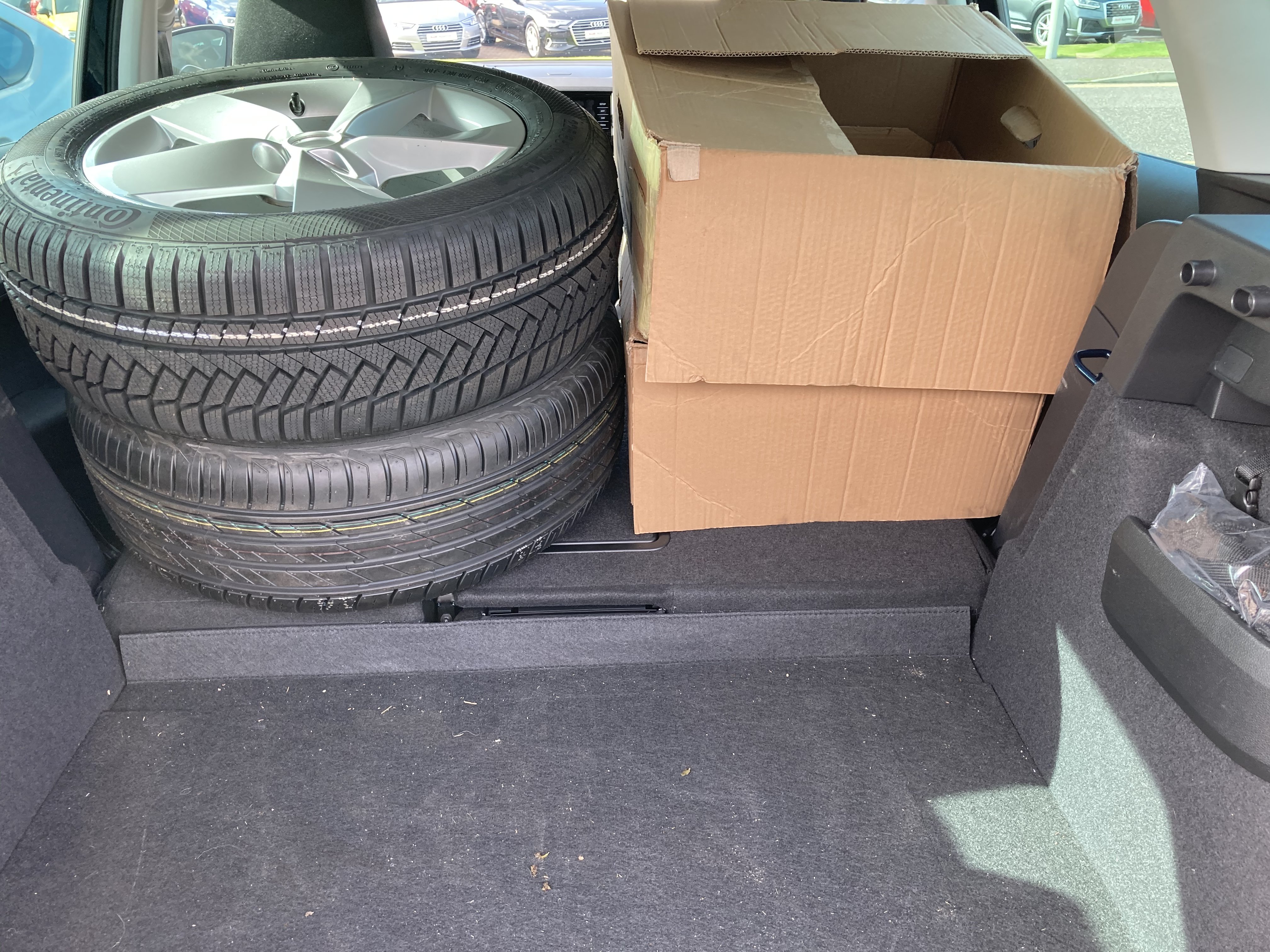

Never thought about that. Wonder if those with full size spares also change their tread to winters?
Can you even buy winter tyres for space savers? Is their any point? I'm just guessing a space saver would work better in poor winter conditions than a summer tyre would. Wonder what the law says about spare tyres in those colder Euro countries where winter tyres are mandatory. Do you have to change the rubber on a space saver?
Edited by kodiaqsportline
Many do have a match spare, plenty here buy 5 All Weather / Winter tyres and have said they do over the years.
Some like me might just carry a pair of matching tyres on wheels when on a trip because they are directional tyres.
I might even just put the Winters in the car as spares and they can go on if the roads turn bad as they can over just short distances or a few days.
I regularly(ish) do journeys that start at ~4am and are ~550 miles in total.  If I have a puncture at the start of that journey (think A9 in winter) and I can’t sort it out quickly (DIY, not waiting hours for a breakdown chap) it means adding an overnight stop to that trip.  If I have an identical spare I can just press on regardless, plus no 50km/50mph limits of a skinny wheel.
I know the chances of needing the spare are low but it’s the old risk vs consequences, low risk but PITA consequences.  Most of the tyre swaps I’ve had to do have been on my drive when I find I’ve got a near flat tyre so it can go in the boot to get sorted next time I’m passing a tyre place.  Plus the tyre that has been put on stays on and the repaired tyre becomes the spare.   Also if I have to use the spare when on the road I’m not at all worried re driving around on the spare with the dead tyre in the boot to sort out at my leisure, chances of needing another spare that week should be about zero.  I wouldn’t bother with full sized spare if I just pootled around locally but driving from one end(ish) of the country to t’other my perceived needs are somewhat different from most peeps.  To the point of having an identical spare for both summer and proper winter tyres.  You can never be too paranoid!  LOL.

One of the reasons I went for the specific Conti winter tyres I have is that they not directional so the spare can happily go on either side.  It significantly narrowed down the tyre types available but more than happy with the choice and they have performed brilliantly in 2 Highland winters, one of which was proper wintery.  👍
