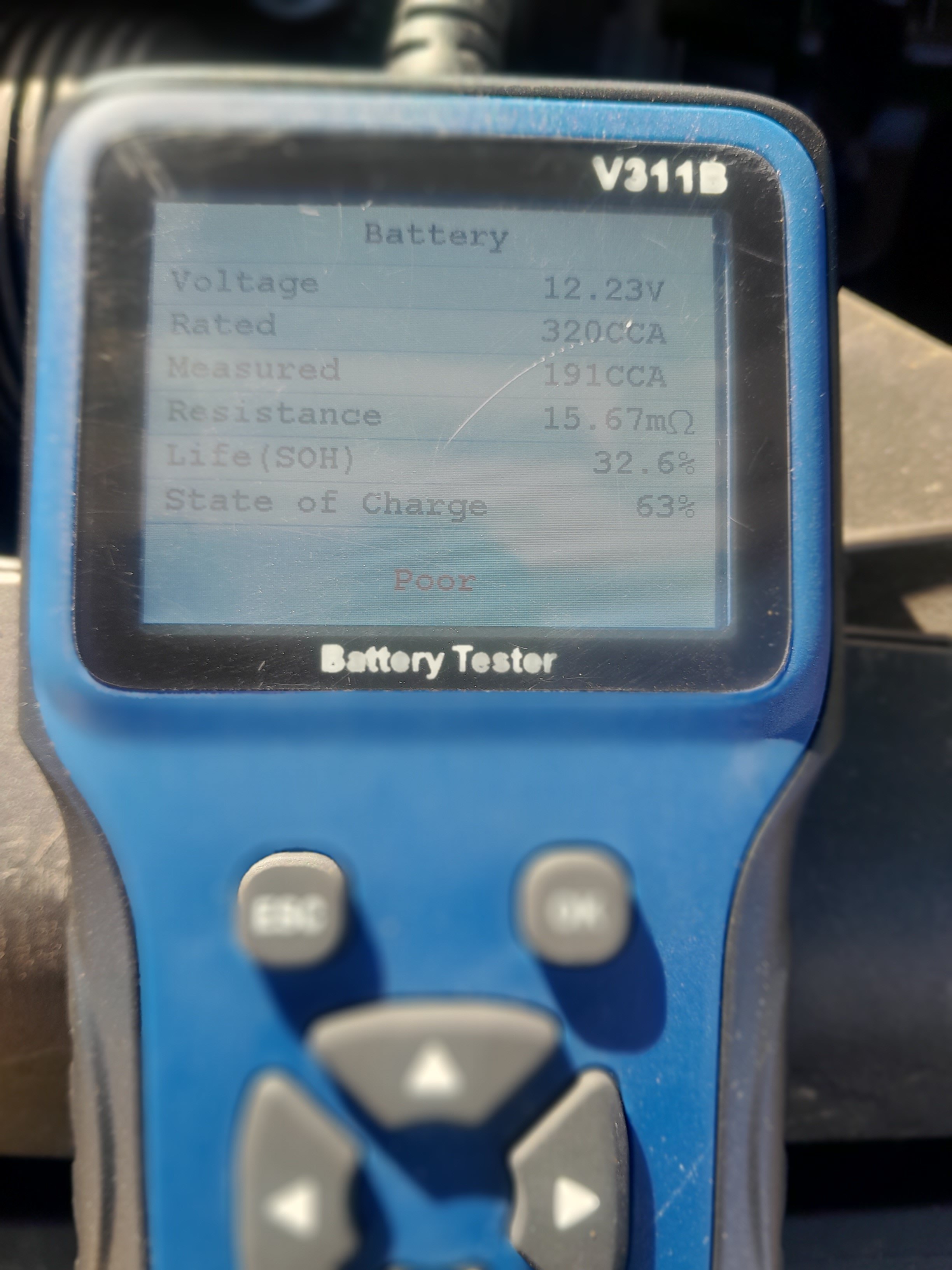

We've tried to get this replaced under warranty but the dealer in Dumfries says the battery is good, I don't agree, I tested the battery myself and it comes up poor / replace.

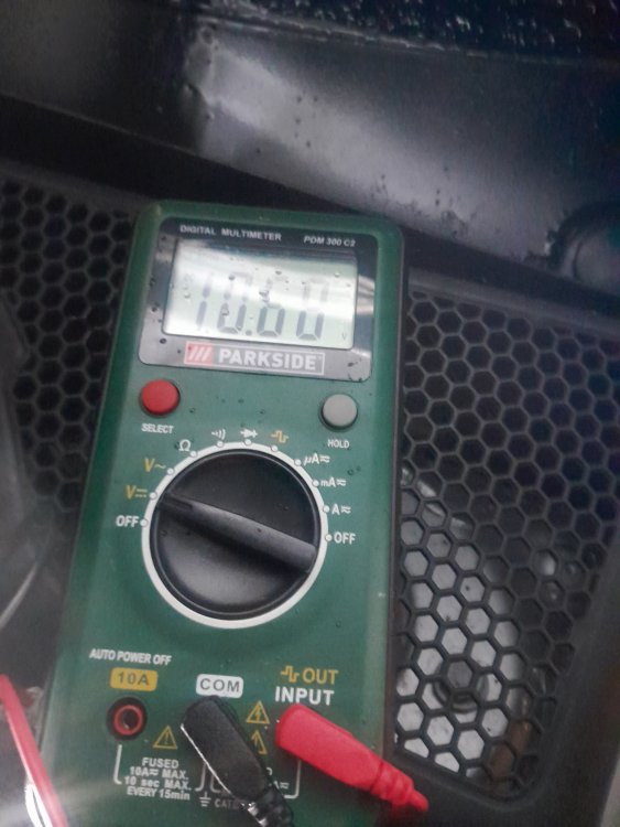

I've sent in a couple of emails to Dumfries Skoda and they are not getting answered, I'm getting ignored, my wife is having to get the train into work as the car won't start, battery voltage is 10. Something volts. I keep having to charge the battery and she can't use the car as once she got stranded as the car wouldn't start.

Yup that battery is dead as a doornail.
So much for the PDI, clearly they didn't care one bit when you parted with big money.

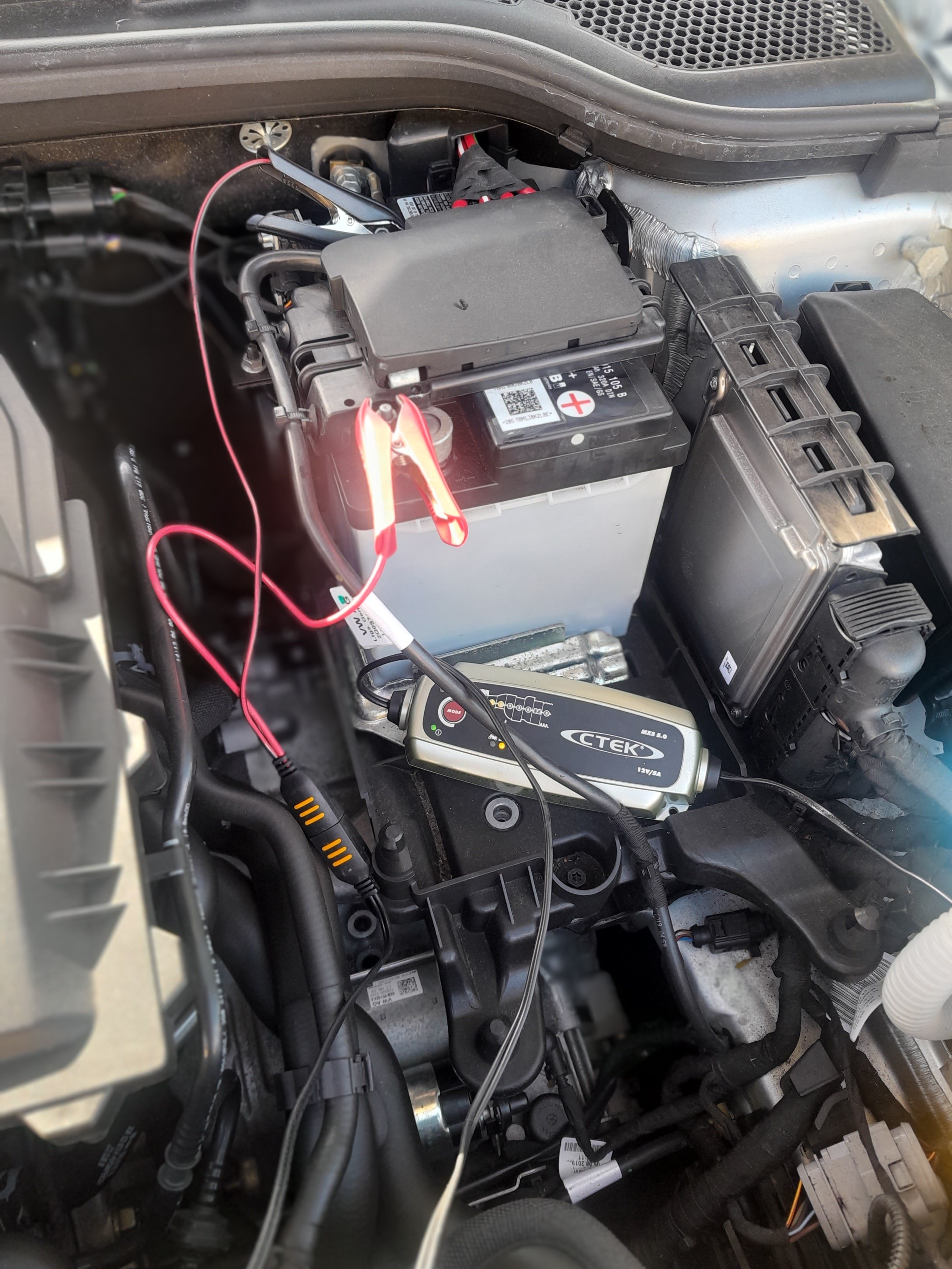

Do you have a picture of the battery that's fitted so we can suggest you a nice replacement?

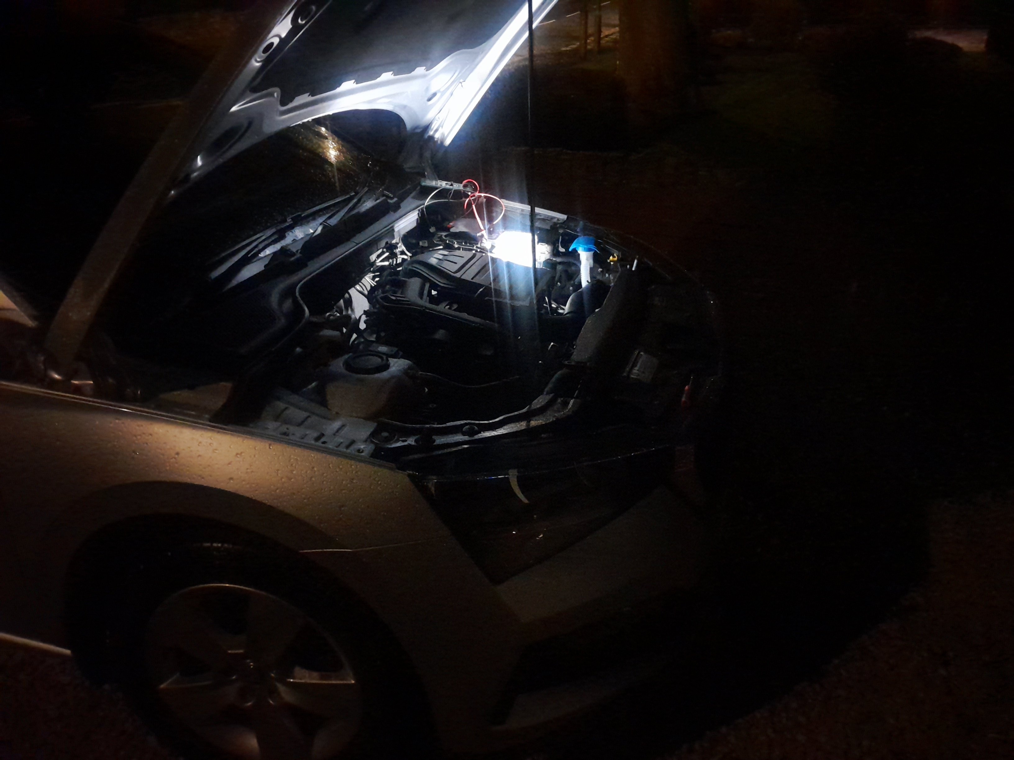

Further images taken back in middle October.

Post back when you can find out, also does your car have stop/start?
If you do, the you should make sure to connect your negative charger clamp to the correct earth point for charging is all, not direct to battery terminal as it cannot "read" the input.

Hi, yes it does have stop start, when I charged the battery I disconnected the battery cables but next time I'll do as you say..thanks .

sometimes disconnected. When I tried using the ctek batrery repair function.
