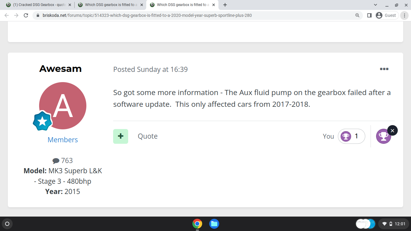

I have a post where i compiled DQ381,s with issues as posted on Briskoda.
http://briskoda.net/forums/topic/514323-which-dsg-gearbox-is-fitted-to-a-2020-model-year-superb-sportline-plus-280

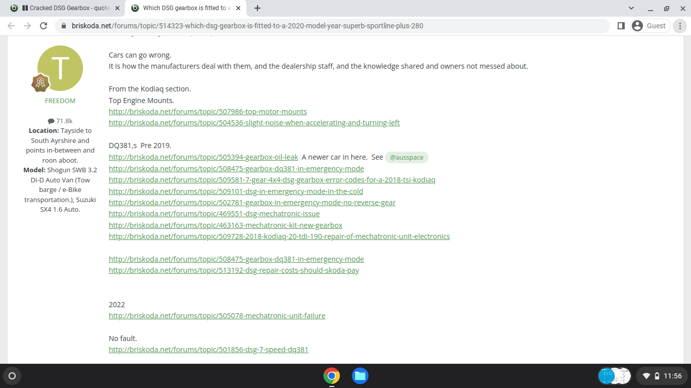

The Link i posted to a thread has my post with the sorry tale of failures people are having from various threads.  Get in touch with SKODA UK.
