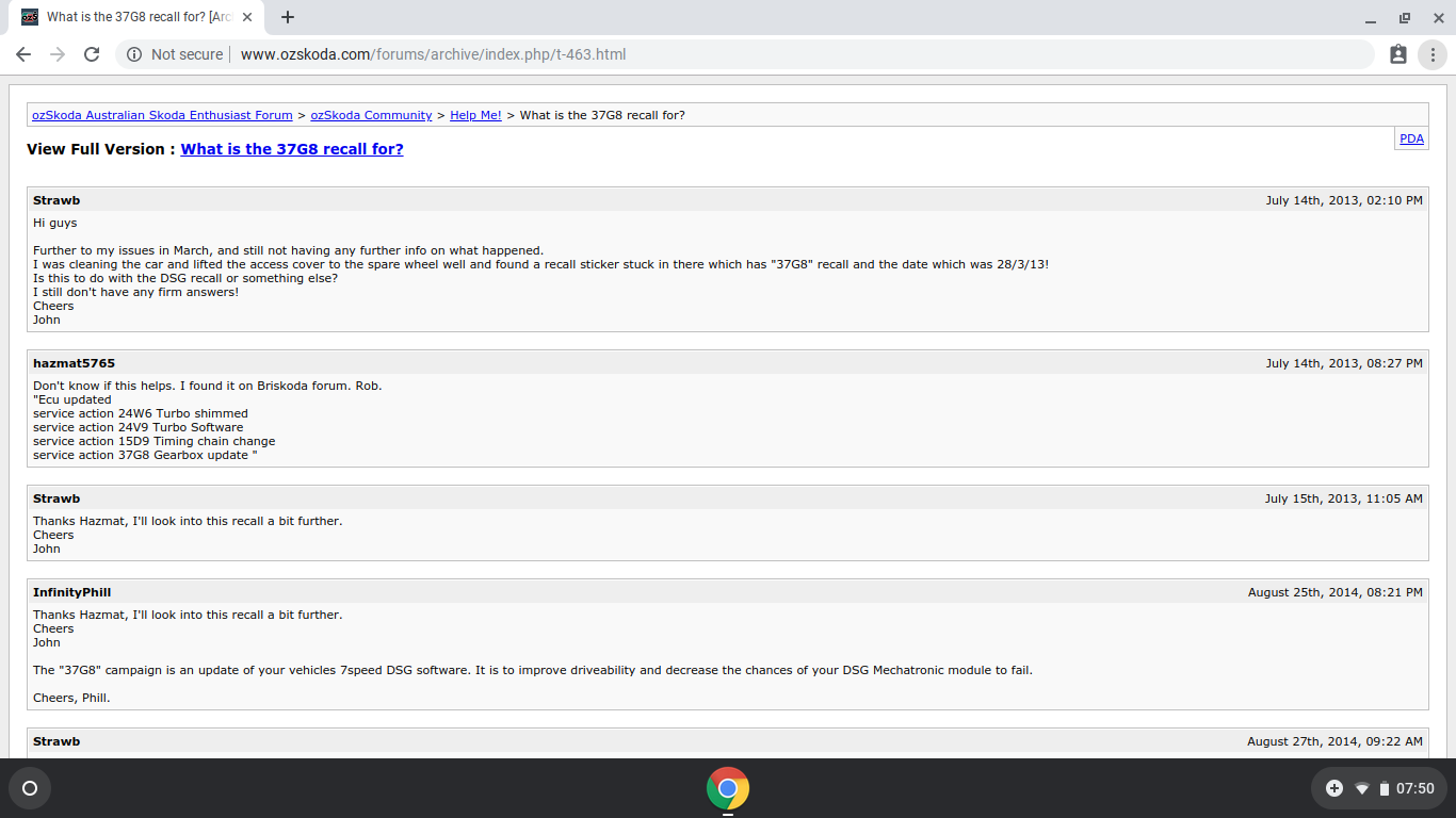

Interestingly online show 4 brands specifically for my 2011dsg gearbox all are sinthetic not mineral? So skoda main dealer for mineral oil? Or was it the control unit that was switched from sinthetic to mineral? I forget so much to read through, cars had upgrade and oil got ticket in spare wheel well but just fancied freshening gear oil
I have never seen a car in the UK or heard of one that has had '37G8' carried out.
Has anyone here had that?
@Pirate76
This was what was used at the Service Campaign '34F7'.
