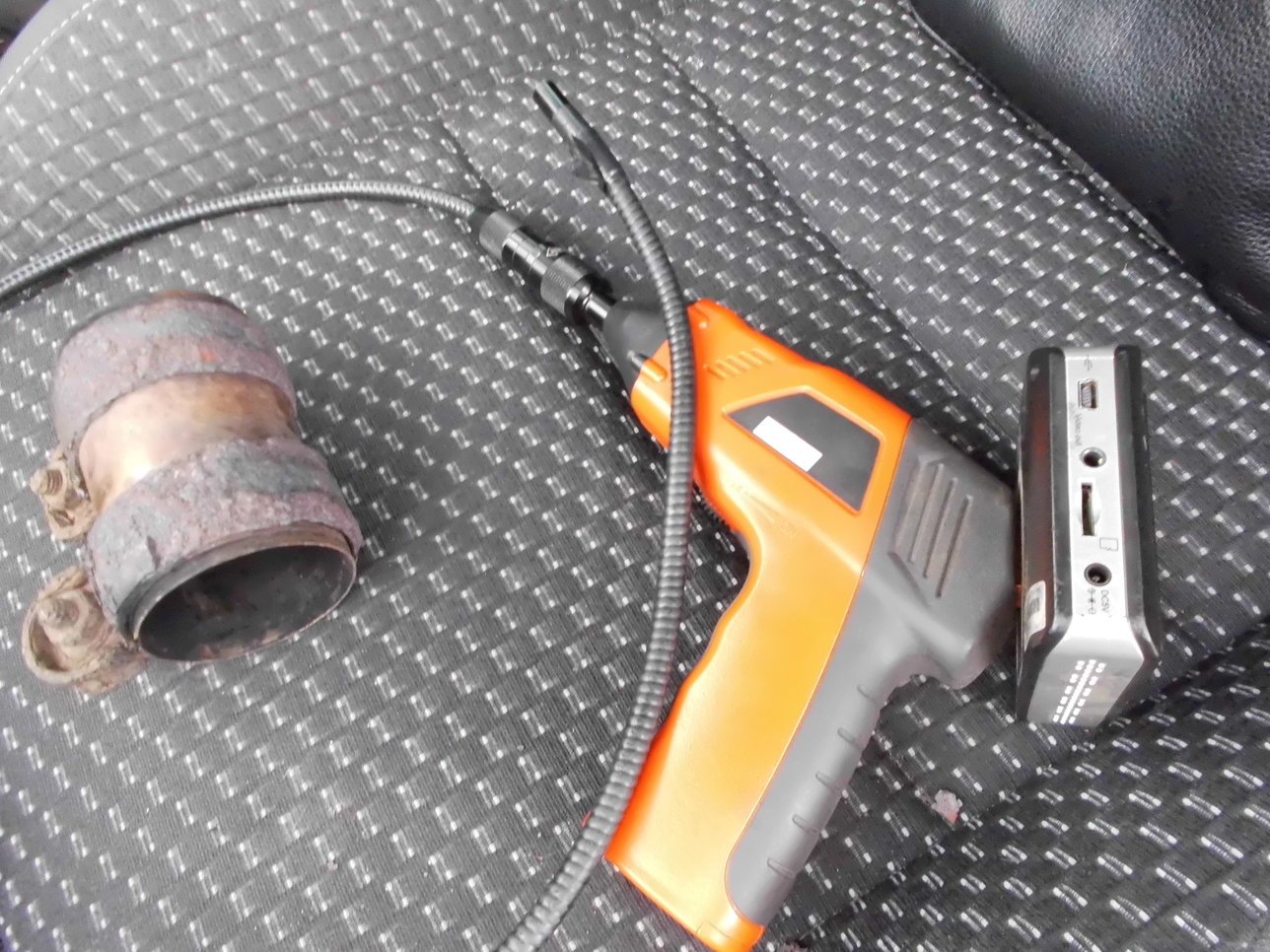

If you go to an independent specialist with a borescope they can take look inside cylinder 3 for you, they can also do a leakdown test to tell you if it's the valves or the rings.
I daresay the dealer just did a basic compression test then wrote the engine off.
