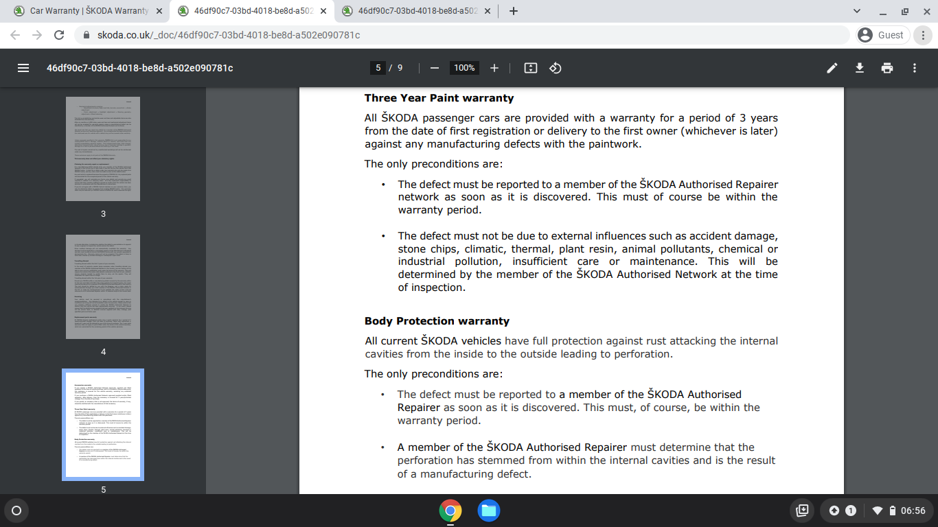

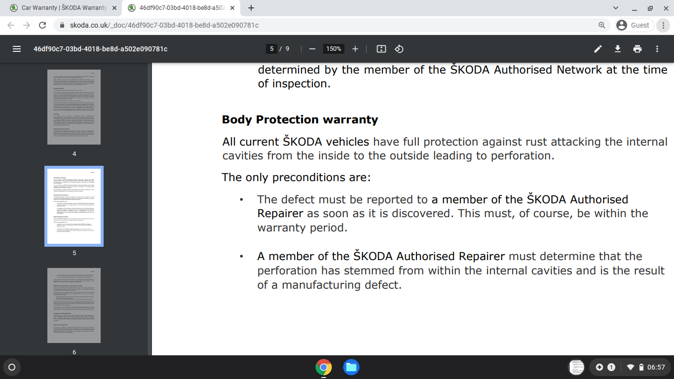

Same problem, Skoda rejected claim as no two year body inspection by supplier. No notification. This should be sorted by the warranty. VW, Skoda know that this is a known issue. As usual they are trying to avoid commitment. Skoda promised support and warranty, failed to fulfil commitment.
From the start of the thread 3 years ago are the posts re the T&C's of the Warranty.
Ask for the T&C's showing the need for a Body Condition Inspection to be carried out every 2 years.
Ask to see where the Technicians Work Sheet at a dealership shows that they have to carry out a body inspection so that the car keeps a valid Corrosion warranty.
No place in the Warranty T&C's that an owner gets if they do get them does it say that there is a need to Annual or Bi-Annual Inspection carried out at a Dealership / Approved Repairer.

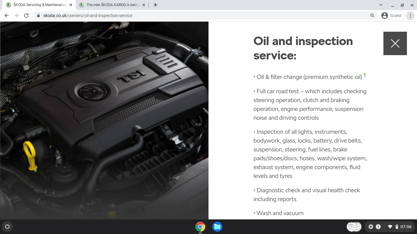

There was when there were Owners Service Manuals a page after the Service Page for the Body Report.
The Service & Maintenance Menu for fixed price Services says there is a Body & Glass Inspection so if a car gets serviced at Main Dealeeships and the Check of the Body is not done Skoda UK know who are not doing them.
As Skoda UK for the evidence that the Warranty requires a Bi-Annual inspection to keep the corrosion warranty valid.

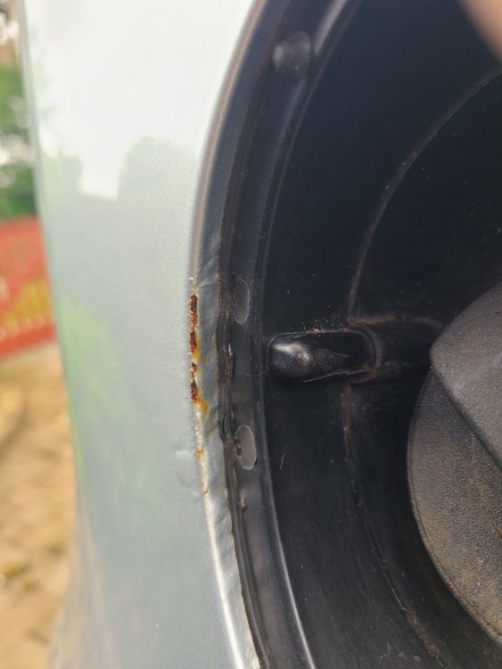

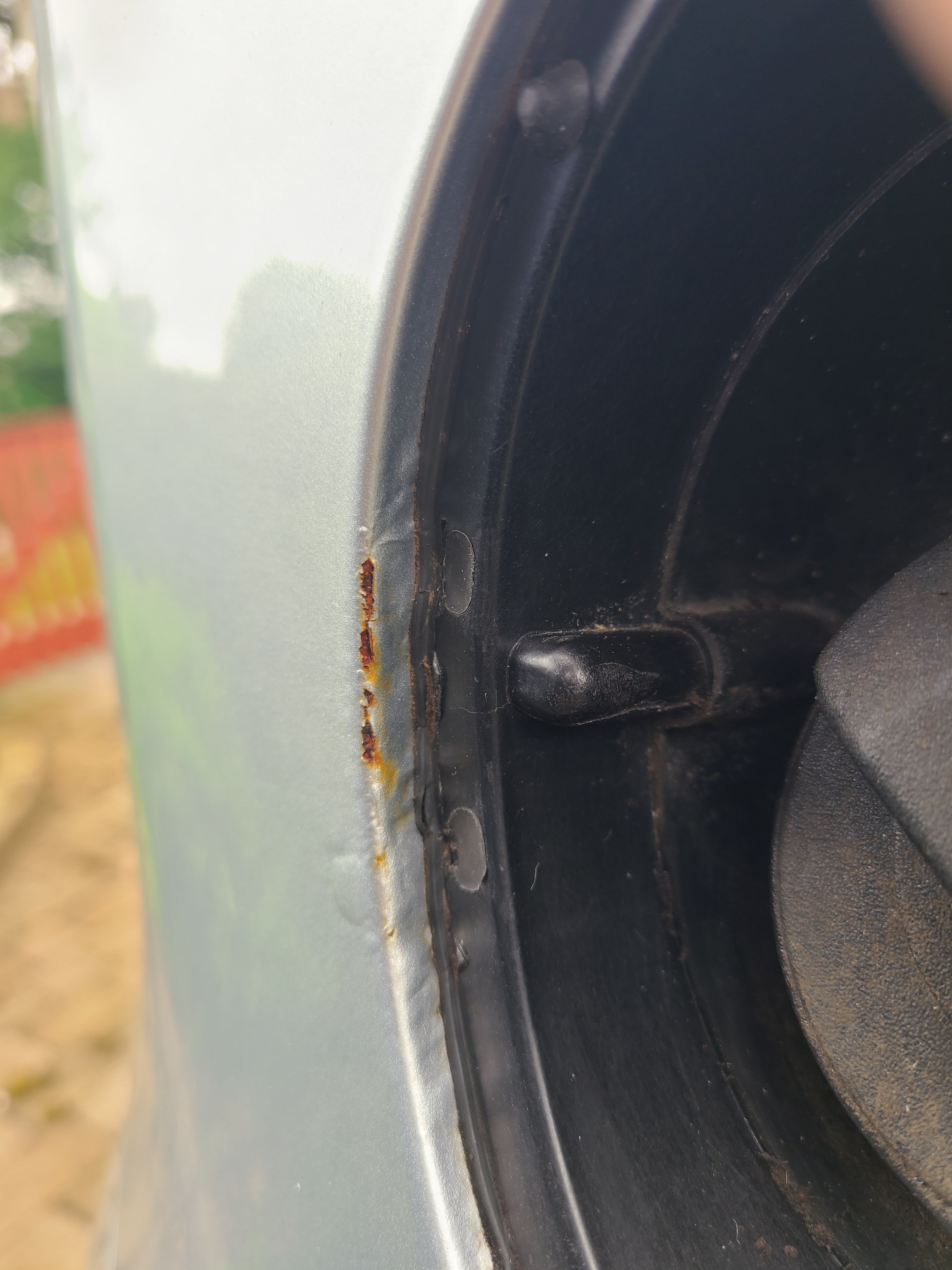

Wife and I each have a CitiGo, 8.5 years and 7 years old. No signs on the outside of the car fuel filler of rust. I have cleaned the under side of the filler of road dirt etc, less on the older car, but not a lot on either. Jet washed and dried. This summer I hope to treat the area and spray with Dinitrol.

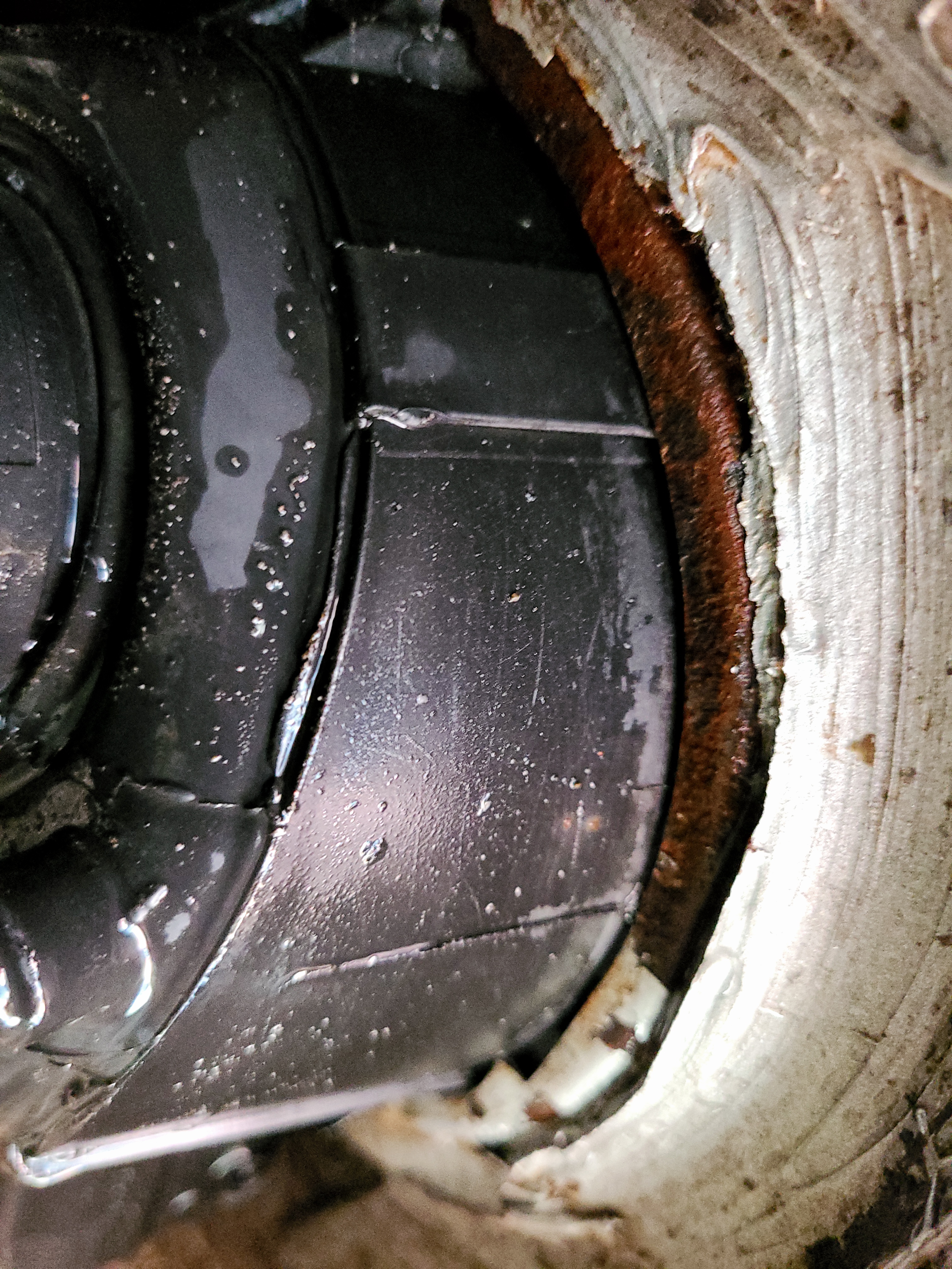

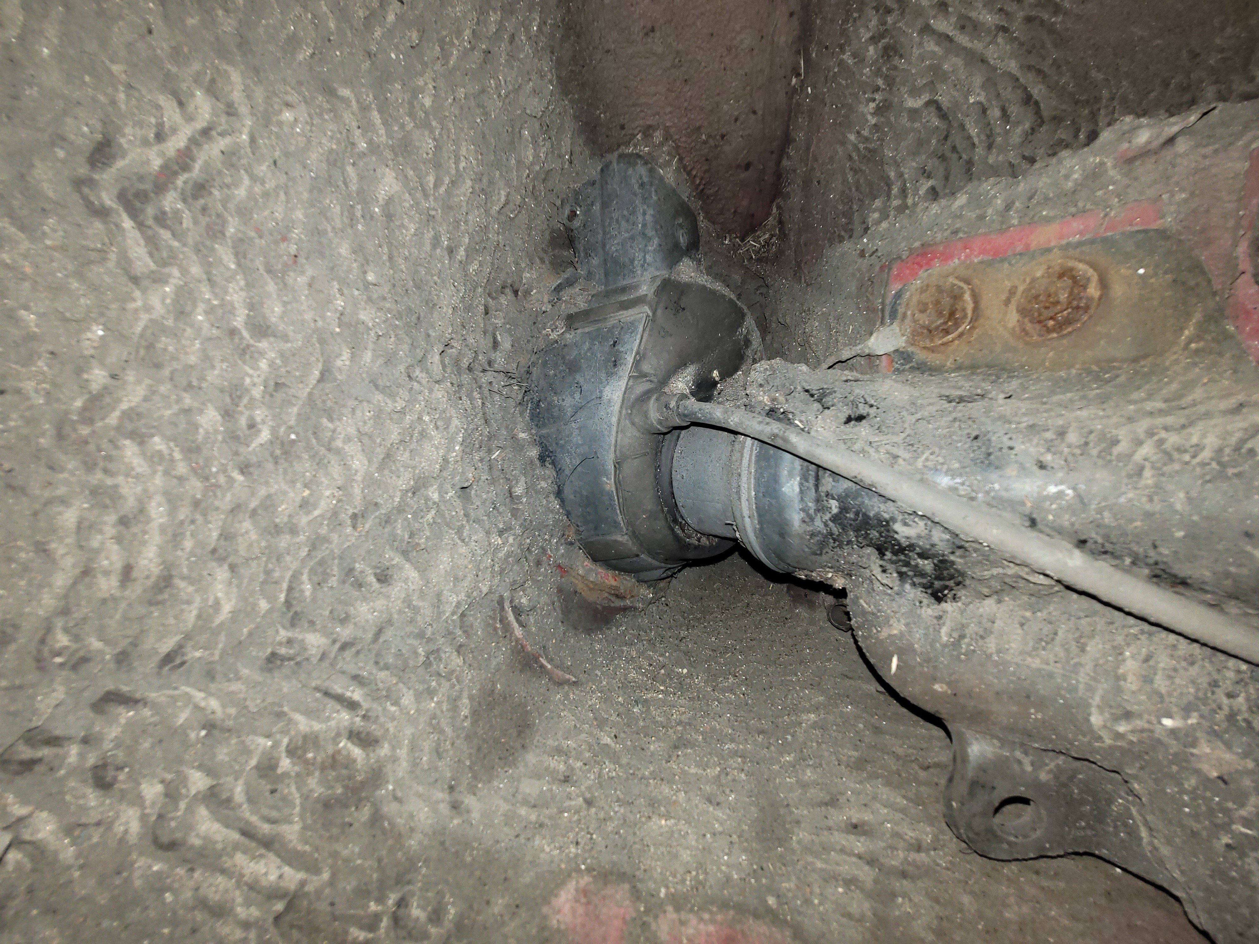

The best thing (once cleaned or repaired) is to fit the wheel arch liners that came on later models as standard. Plenty of information on the Up! owner's forum, for part numbers, fitting guides etc.

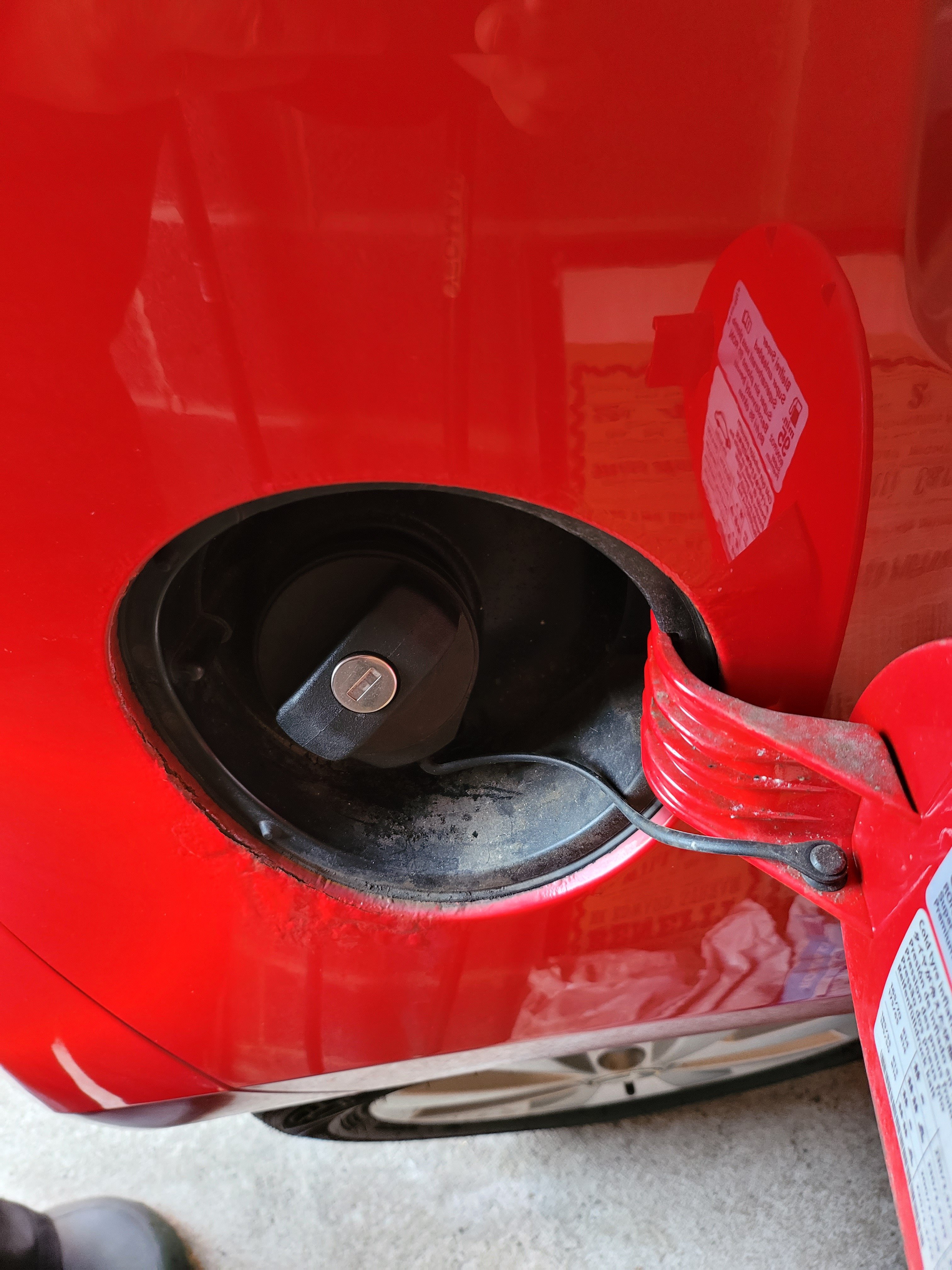

My Wife just noticed her Citigo is bubbling. I will report on how helpful (or otherwise) D M Keith are in resolving this.
Serviced at a local Wakefield garage called Spencer & Broadhead once out of used car warranty.
@delicolor
That has been there for quite a while and each time the car was fueled or washed.
What age is this car and was that not there at the last service so not remarked on at that service when the Body Inspection was done while in the 3 years manufacturers warranty.
Not that the warranty does require Annual or Bi-annual or even periodic inspections even though Skoda UK might say they do.
But then the Skoda Main Dealer Servicing says that Body Inspections are part of a service.

Hi. I'm about to purchase a 2016 Citigo Black Edition and have left a £200 deposit but I am now concerned about the issue with rust bubbling around the fuel filler cap. Photos attached showing the bubbling. Should I avoid and lose my deposit or is it still worth buying? Any ideas on how much it would cost at a body shop to repair?
Tough call - it'll be expensive to fix properly and will only get worse if you don't....
Point out the problem to the garage selling the car and see if they can do the repair, to get the sale.
As mentioned many times, cars without the plastic wheel arch liners (fitted later) are prone to this problem 😞
Edited by freemansteve
Thanks Freemansteve.
I did point it out. They just said its a common problem but no offer to fix it and claim that shows no sign of rot from underneath. Any ideas on costs?
Not sure of costs, but it will be expensive if you cannot do the work yourself - it involves either cutting out a section & welding in new sheet metal, or doing a new 1/4 panel, plus respray.
The problem is that the rust comes through from the inside of the wheel arch.
You may be able to argue with Skoda UK about the perforation warranty, but they will tell you all about wanting to see regular (documented) inspections with a dealer, and then suggest that bubbling is not actual perforation, blah blah blah, in their usual war of attrition (they are there to protect the dealer network from owners, after all!).
There's more on this on the Up! Owners Club website if you craft some searches.
It all depends on how long you want to keep the car before buying another. I suggest if it's more than a year or two, the rust may well get so bad, it'll be hard to sell on after that time. If it's a stop-gap at the right price, go ahead.
