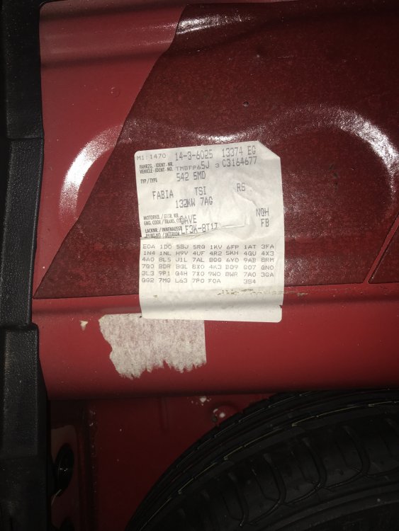

eg,
Engine Code & Transmission code of DQ200 on that car.
(& this car has needed and had '34F7'  so Mineral Oil in and a Software Update done.)
