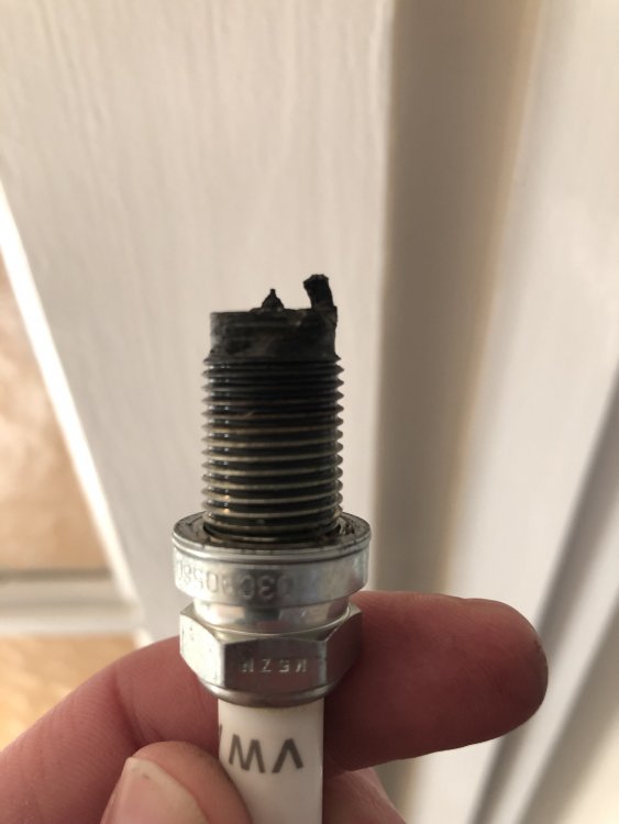

Hi all,
I know there are many stories with regards to spark plug failure but I'm looking for some advice on where I currently stand with Skoda - details below.
I've owned 2 new Skodas from new, each purchased from the Hughes dealership in Aylesbury.
My first Octavia VRS was plagued with EML issues (cat below efficiency). It spent numerous visits back to the dealership with them never solving the problem. They had no idea what was causing the fault despite changing a vast amount of parts at my cost. Octavia was fully maintained service wise via the dealership.
I sold the car in 2013 and purchased a new Fabia VRS (CTHE). Again fully service maintained by the dealership. Last weekend the Fabia developed a miss fire in cylinder 3. I called the dealership who advised to call AA which I did. Following day the car was booked into Skoda Aylesbury. Diagnostic was broken down spark plug (pic attached) and cylinder damage. Garage have stated £660 to remove head to see what further damage has occurred and recommend a full new engine at a cost of £5700. When I challenged back and ask why the plug had failed in this way they stated they did not know and have never seen this happen before. So i'm suppose to pay for a new engine on a 6 year old car when you can't even tell me why its happened??
I registered a formal complaint with Skoda Uk (executives office) who are currently investigating the matter however they have relayed the same that they will not know whats caused it and it is highly likely i will have to pay for the engine as the car is out of warranty.
I have asked NGK to comment who advised me the following-
The ground electrode appears to have suffered from excessive heat and partial melting. As a spark plug produces no heat, the source of the excessive combustion chamber heat would need to be ascertained to prevent a repeat running condition from occurring.
Possible causes of over-heating of a spark plug are listed below;
a) Incorrect fueling/ignition timing. A mixture too lean or over-advanced ignition timing can lead to excessively high temperatures within the combustion chamber.
b) Incorrect/unsuitable plug selection for vehicle. The OE part number is only partially visible on the image you provided. If the full number reads '03C 905 601 B', then we can confirm an NGK SIZFR6B8EG is supplied as the spark plug for the Skoda production line for a 2013 Fabia VRs. However, if the vehicle has been subjected to engine re-mapping/modifications, then any alteration from the manufacturers production specification can bring into question the suitability of any of the components fitted to a vehicle. Increases in engine power output will lead to higher combustion chamber temperatures.
c) Incorrect spark plug tightening torque. Insufficient tightening of a spark plug can disrupt the heat path from the spark plug thread to the cylinder head thread. Over-tightening can create a distortion within the spark plug body, again leading to a disruption of the heat path through the spark plug to the cylinder head.
My question is how can Skoda justify billing me for a new engine on a 6 year old car that is fully serviced by them without giving me the root cause of the plug failure? Do I have any legal grounds to pursue this through court?
Car details:
Purchased 2013
Mileage: 60,000
Full dealer service history costing over £1500 in total
Plugs changed by dealer as per service schedule at 37,278 on 02/12/2016 (one month out of parts warranty)
DSG update completed
07/08/2017 car had similar running issues and Skoda diagnosed Lambda sensor and Map sensor. Both removed, cleaned and error codes deleted.
I have just asked Skoda for the torque figures for the remaining plugs to confirm them with NGK. Plugs fitted are correct type as confirmed by NGK.
Any help, advice on how to tackle this with Skoda would be much appreciated.
They don't have to strip the head, just use a bore scope and do a compression test.

Apologies for the late update-
Skoda paid for the head removal and further diagnostics. No further damaged found so a rebuild was authorised with a list of new parts (3 pages). Total cost came to just shy of 3k which reluctantly I paid £340 towards. Free service also thrown in. Still no answers to how and why it happenend.
I will now see how the car behaves but have some piece of mind that there is warranty against the work.
So they took the head off and found no damage?
If no damage was found, then Skoda Aylesbury were incompetent, deceitful and misled you in an attempt to obtain money by false pretenses. Was there cylinder damage? How was that repaired? New liner/piston/rings?
