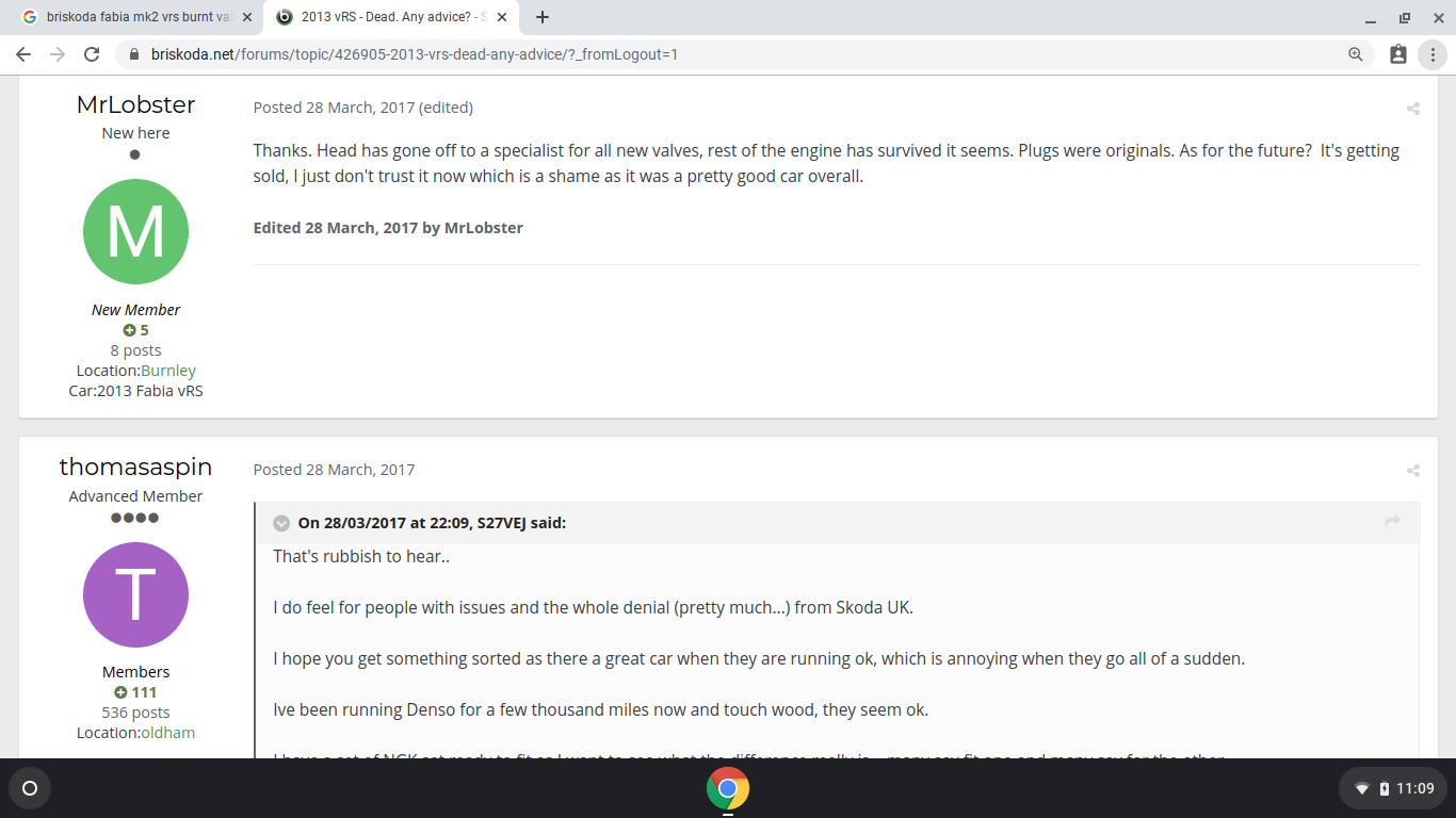

http://briskoda.net/forums/topic/445242-burnt-valve-engine-rebuilt
http://briskoda.net/forums/topic/426905-2013-vrs-dead-any-advice

Yep, they did the borescope already and
said it’s most likely the Valves
Considering it will cost me 130€ to get it home (Broke down off the autobahn 70km away) I’m leaning toward just doing it. But the most likely bit worries me - and then once they replace the valves, what’s the actual cause.
They offered us 200€ to scrap the car. Might be a fix and sell and keep as much money as possible
