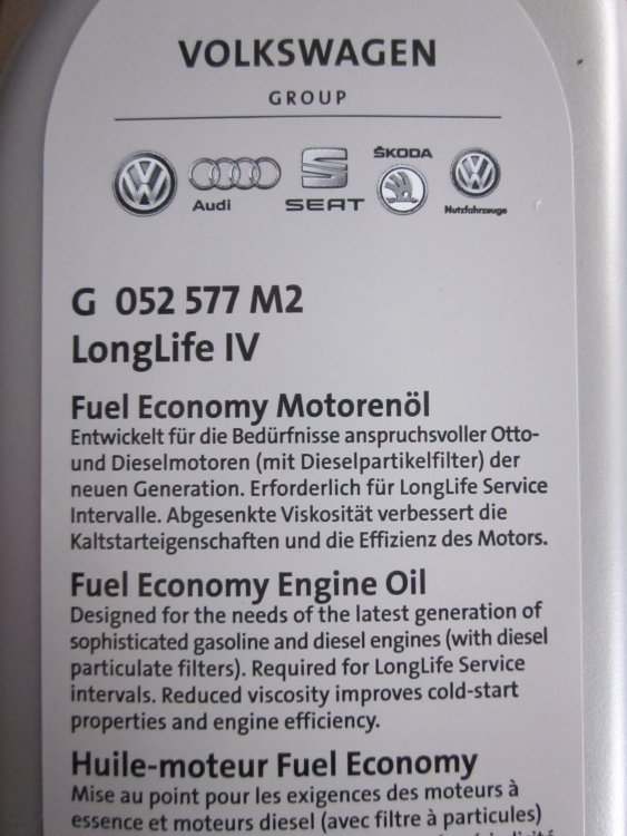

Use VW508 so 0w 20 FS IV to top up.  Your car left the factory with that.
 At the next service you can decide if you want to start using VW 504 so 5w 30 FS.

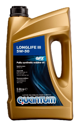

You can get 5 litres of Quantum Longlife III (genuine VAG oil manufactured by Fuchs) for £30 delivered to your door which is VW504.00/VW507.00 5W30...

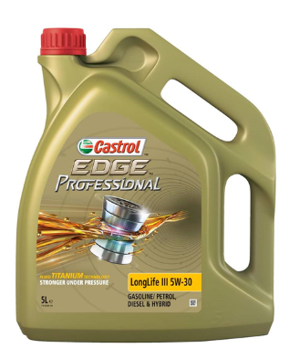

Or, a lot of dealers use Castrol Edge...

Both the Quantum and Castrol 5W30 oil listed earlier meets the VW504.00 / VW507.00 specifications.

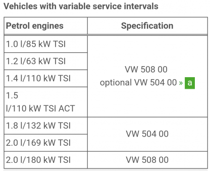

169 kW is the 230ps engine and 180kW the 245.   That is the Skoda Chart.
