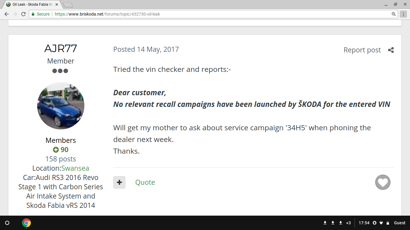

 It was not a RECALL, and not much of a 'Recall action', as it never showed on the VIN Checker until last year.
http://briskoda.net/forums/topic/425424-2017-another-dq200-7-speed-service-campaign

http://briskoda.net/forums/topic/432730-oil-leak
