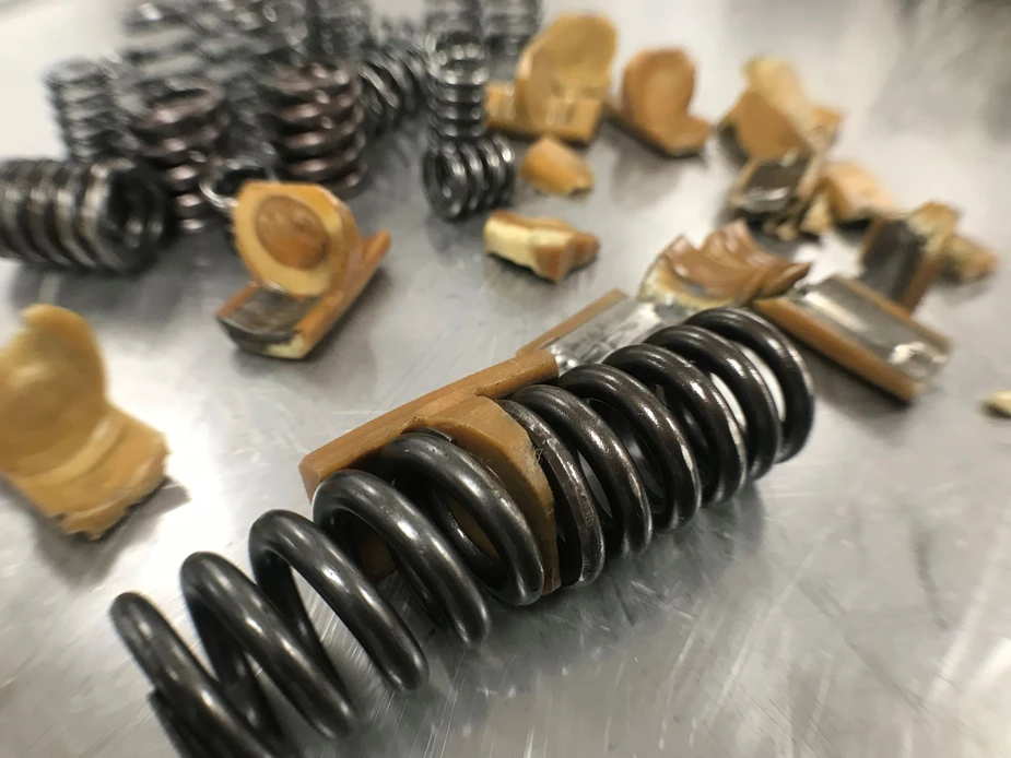

I know we're way off topic however here is a nice picture of part of the inside of a Fored wet clutch unit that's 'decomposed'.  Look at all that old brittle broken plastic.
6DCT450 Ford Volvo Powershift Semi Automatic DCT Dual Clutch Spring
Ouch!  Thats shocking.
Certainly not the ticking timebomb I'm looking for under my bonnet! 🤪
