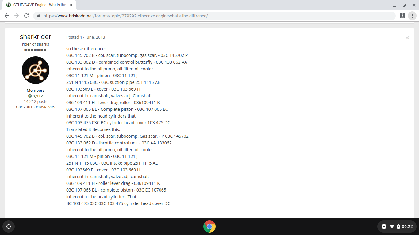

Differences, CAVE / CTHE.
http://briskoda.net/forums/topic/279292-cthe-cave-enginewhats-the-difference

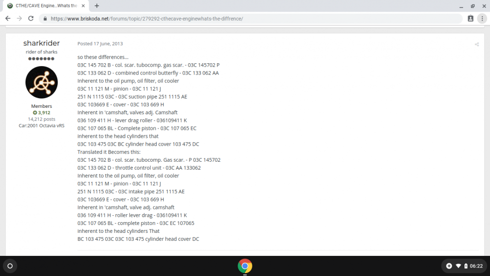

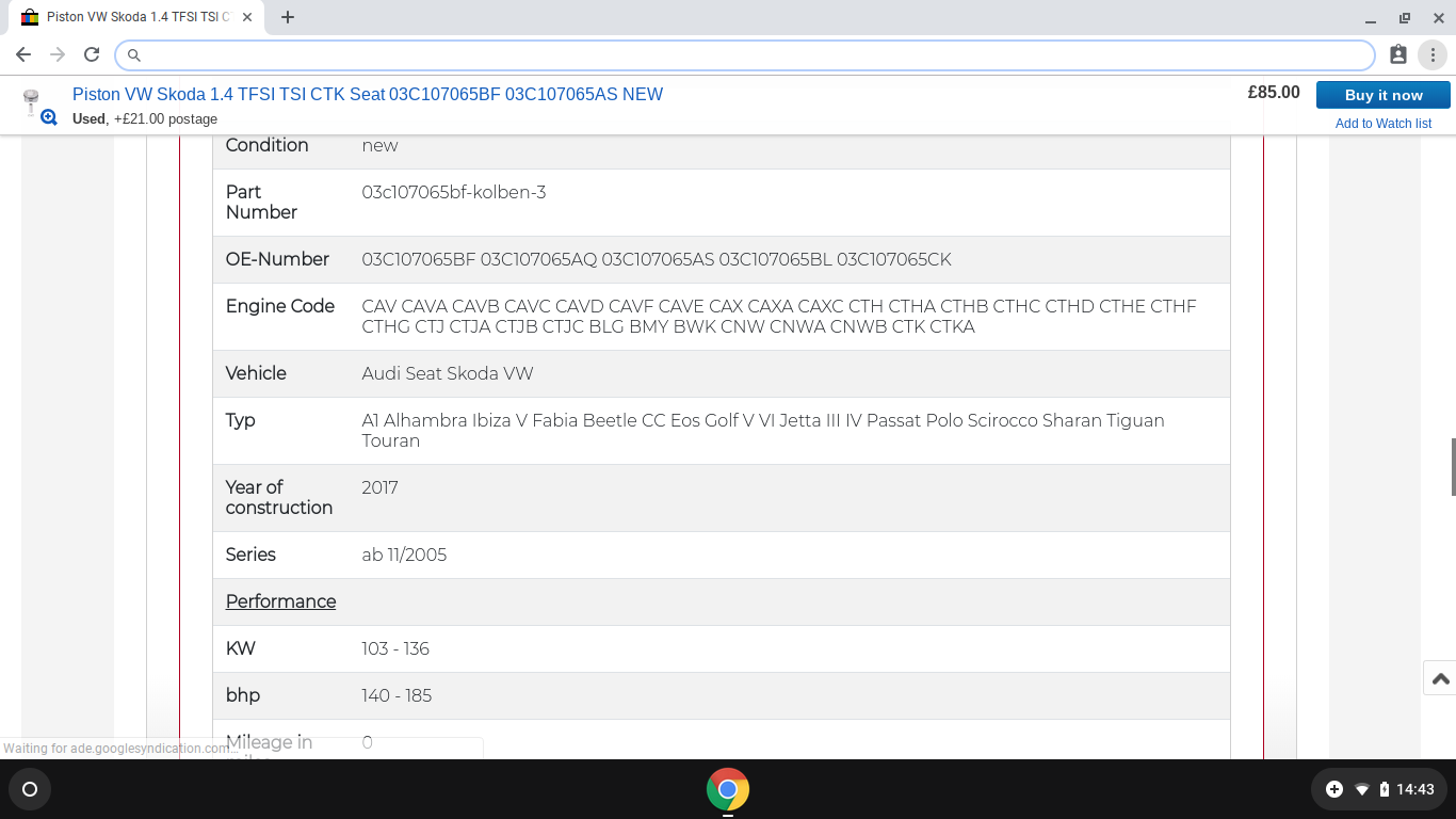

These are the pistons that will be used  - I assume these to be the most recent version?
7 hours ago, Skoffski said:
Great so it is a updated / upgraded piston thanks!
