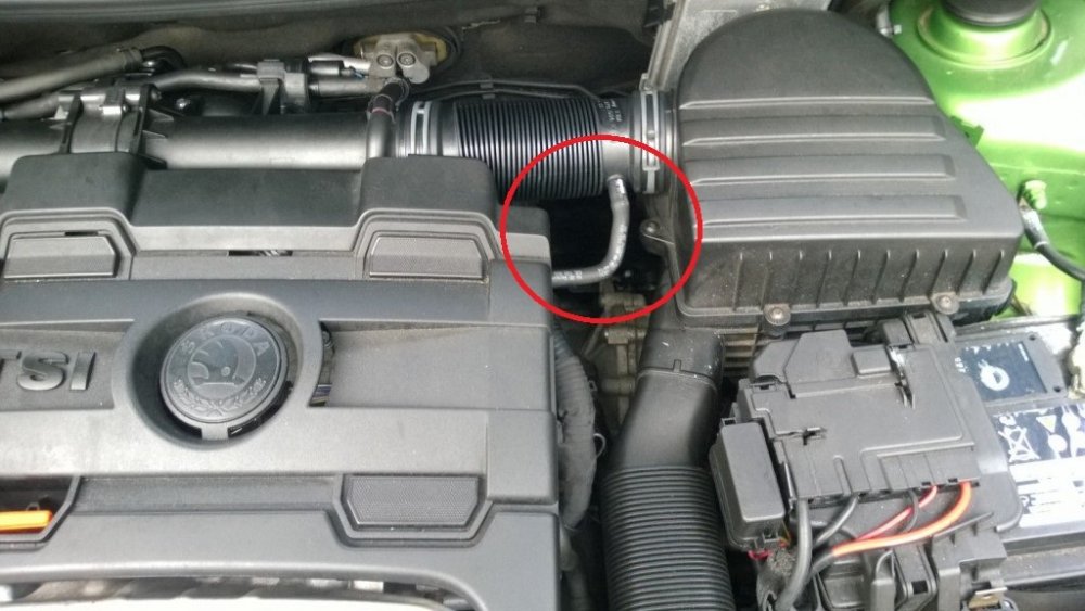

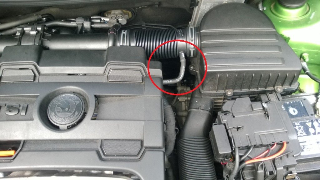

The breather pipe is the first fix. if you cannot see this pipe it will confirm you have a standard Cave. A new engine engine CTHE or Cave / CTHE hybrid would have this breather pipe. Oil jet fix would not usually performed without the Breather pipe fix

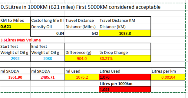

I checked my official results in MS EXCEL, i knew i was using around half a litre every fuel top up. I could never make 2 fuel top ups without the oil light coming on and using the skoda weigh procedure i was well over double what was considered normal, but warranty run out.  There was some 'good will  for 5 years after the issue so anyone who has a 2014 VRS might still have a chance, but highly unlikely to get.
The key thing if If you choose to fix & keep & go down the oil consumption route, ask for a compression test first and speak to the master tech in person, they will have to drain all your oil out and fill it with Long Life 3. In all it took me about a month > 6 weeks to sort, since was paying got a courtesy car.
another thing to note the ECU was 'upgraded' and put me the bottom end of 170BHP. I think they de-tuned it slightly, so once it was all sorted i got the car re-mapped and went down the modding route.  Good luck

0.5 litres in 1,000 km (621 miles) first 5,000 km considered acceptable.
Is intesresting. because it may well be in the first 5,000 km.   But then Dealership and Skoda employees tried saying it was acceptable a long time after the first 5,000 km.
As it was there were those that had engines using 0.3 litres in 621 miles that got engines replaced, because in no way was that considered acceptable.
Amazing it takes years before people see where things get lost in translation with VW or things written in Owners Manuals or technical papers need looked at closer.
