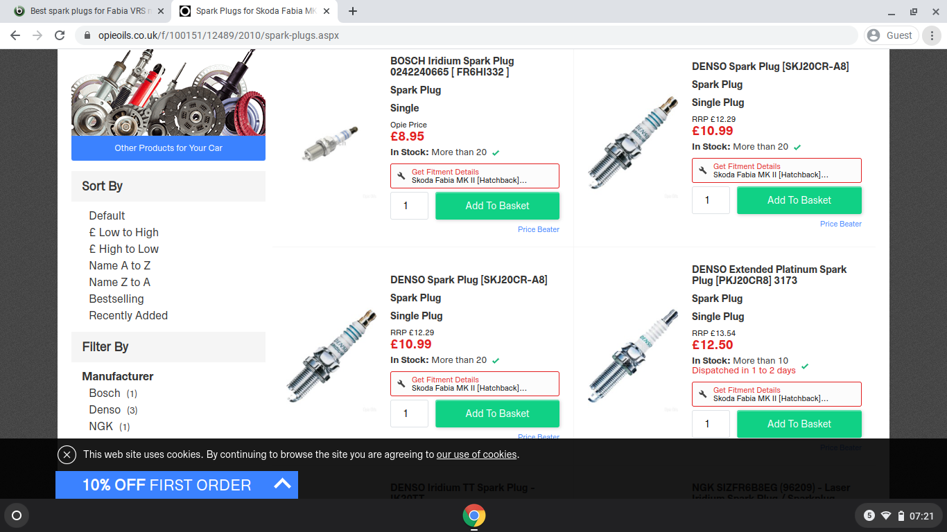

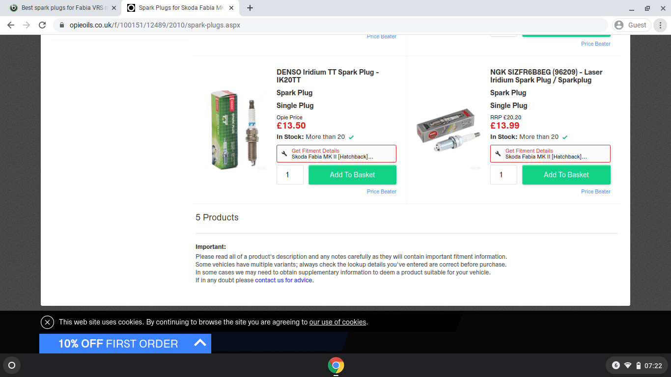

3 hours ago, e-Roottoot said:
Maybe use a BRISKODA Sponsor.  So a trusted seller.
http://www.opieoils.co.uk
http://briskoda.net/forums/forum/350-opie-oils
I’ve always bought all my servicing parts from opieoils, I can’t fault them.
Had a **** up last year when I purchased all my stuff, filters, oil, plugs the lot but it came in a rather small box, small enough as in the size of a 1L oil bottle size so I thought hmmm, definitely no 5L in there. Dropped them a quick email and they sent the oil out next day, warehouse error apparently. I can’t fault their service so I keep going back. They aren’t the cheapest but they’re consistent in being reliable and always have them in stock so I keep returning.

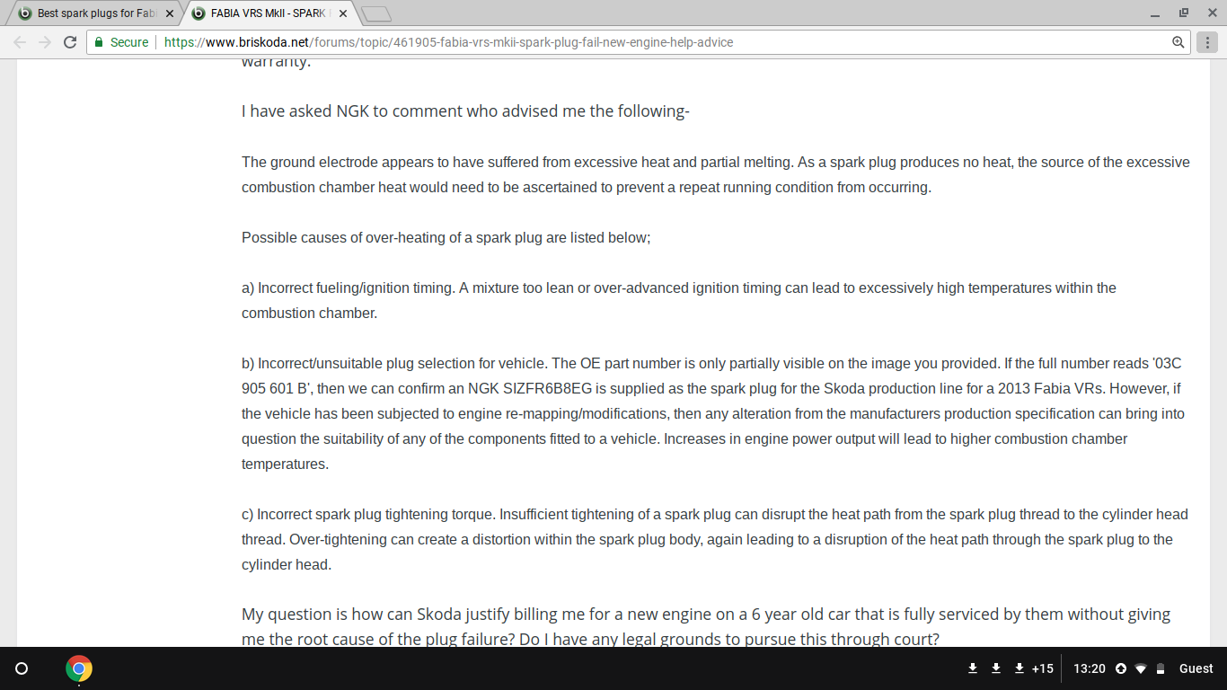

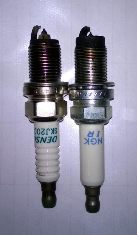

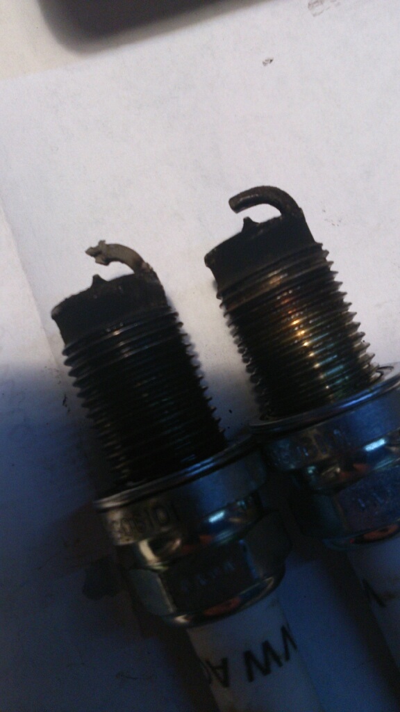

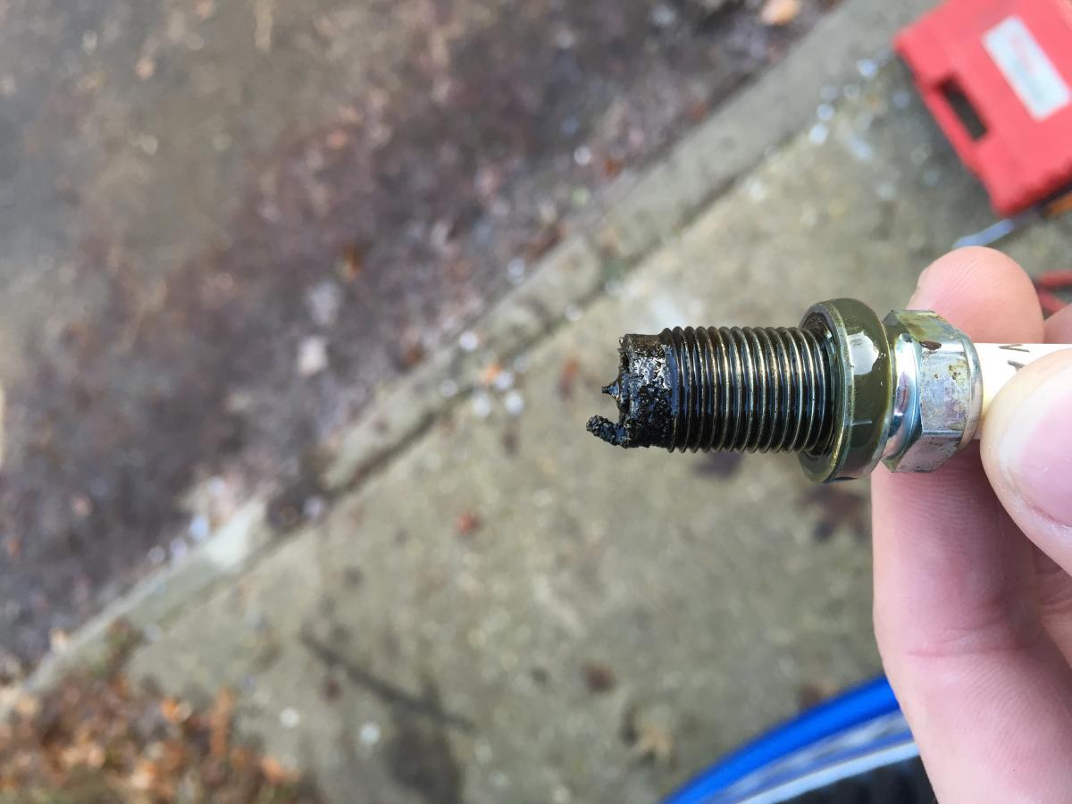

People really need to be aware you are highly unlikely to see a Twinchargers plugs with more than 1 plug having an issue.
The plug that gets fouled with oil and carbon and has the tip burned off.
Crap design of the inlet manifold is an issue.
http://briskoda.net/forums/topic/421161-vrs-spark-plug-tip-missing
http://briskoda.net/forums/topic/461905-fabia-vrs-mkii-spark-plug-fail-new-engine-help-advice
Stuff like posted there by @sepulchravehas been an issue since 2009.
Technicians / mechanics have said the exact same thing.
That is why the CAVE was discontinued, but before that the OEM plug type and gap was changed, then with the CTHE plenty again used plugs other than the OEM.
With tuning they changed the gap with the plugs used.
Some learn by others mistakes & experience.
That can be the Manufacturers, the mechanical engineers / technicians or those that just learn stuff on forums etc.

Look a the dozens of Mk2 Fabia vRS just on here that have had the tip burn or break off of a Spark Plug.
All but 1 pictured or discussed by those that have had this will be NGK plugs of the 4 different specs used with these engines,
So it might be called anecdotal, but that is anecdotal from working on the cars, removing plugs, inspecting plugs and talking with the techs working on the cars and what they have learned to reduce the risk of the issue.
This is the single example of a DENSO that i have seen over 10 years of the CAVE / CTHE plugs failing.
Maybe because those using them are already aware of how short lived the 1 of the 4 NGK / VW plugs can last so when using the DENSO they are checking them more regularly & not making the mistake of going by Dealership or the Manufacturers advice on plugs or service replacement schedules.

1,800 CAVE engine Skoda Twinchargers in the UK.
Failures from the start with excessive oil use. and failing spark plugs. 2011 the OEM plugs were changed, as was the gap.
Some cars had breather mods and software updates.
2012 these engines were discontinued.
2012 the CTHE were introduced using the OEM plugs last used in the CAVE engines.  Under 1,100 CTHE Twincharger registered in the UK
There were still excessive oil users.
There were some cars had the breather mod done??? & a Software Update.    There were engines replaced, there were spark plugs burning tips off.
Then there was the Oil Spray Jet upgrade done.
The 2,900 odd cars left the factory with the VW / NGK plugs.
That was an issue, but that was how it was 2010-2014.
The SEAT & VW & Audi 1.4 TSI / TFSI Twinchargers had the similar percentage of failures of engines 2009-2012, the 2012 on.
The Spark Plug getting the tip burnt off being a common issue.
Audi Techs learned early on to start using DENSO plugs in the Audi A1 1.4TFSI 185ps Twincharger, that was because they were told to by the factory.
There were a very limited number of the Audi A1 twin Chargers in the UK, around 500 first registered.
When there are years of anecdotal evidence and there are statistics known by the Manufacturers it can be simply clever to look at the issues and act and not replace in the region of 25% of the engines expire prematurely. Even replacement engines expire.
Maybe that was what Audi did when telling Dealership Techs to use a different Spark Plug from the OEM ones.
Edited by e-Roottoot
Exactly, like I suggested vastly more NGK plugs installed.
I strongly suspect issues with heat range, even Iridium can't save a plug from melting if it's overheating badly enough and it's generally only the electrode itself that's made of rare metal.
