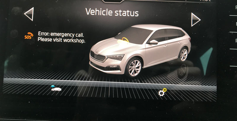

I'm a brand new Scala owner, having taken delivery of the car just a few days ago. So far I really like it, but on return from its first decent run yesterday - a 50+ mile run into London - I got a message popping up "Error: emergency call. Please visit workshop". The yellow triangle comes on the dash and the SOS button lights up.
Having done some research it seems this is a pretty widespread issue with VW group cars, although it sounds like it can cause other issues in some instances. Fortunately on yesterday's experience it didn't noticable affect any other functions that I could see, although the speed warning chime I'd set up did seem to stop.
