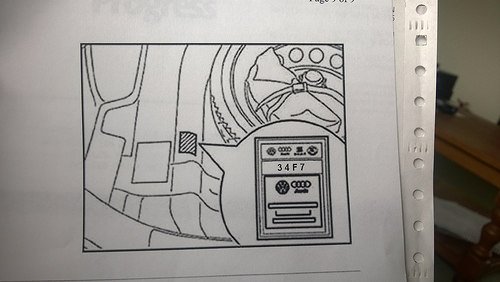

Was '34F7' done on your wife's car sometime after 2014. Is there a sticker in the Spare tyre well.?
